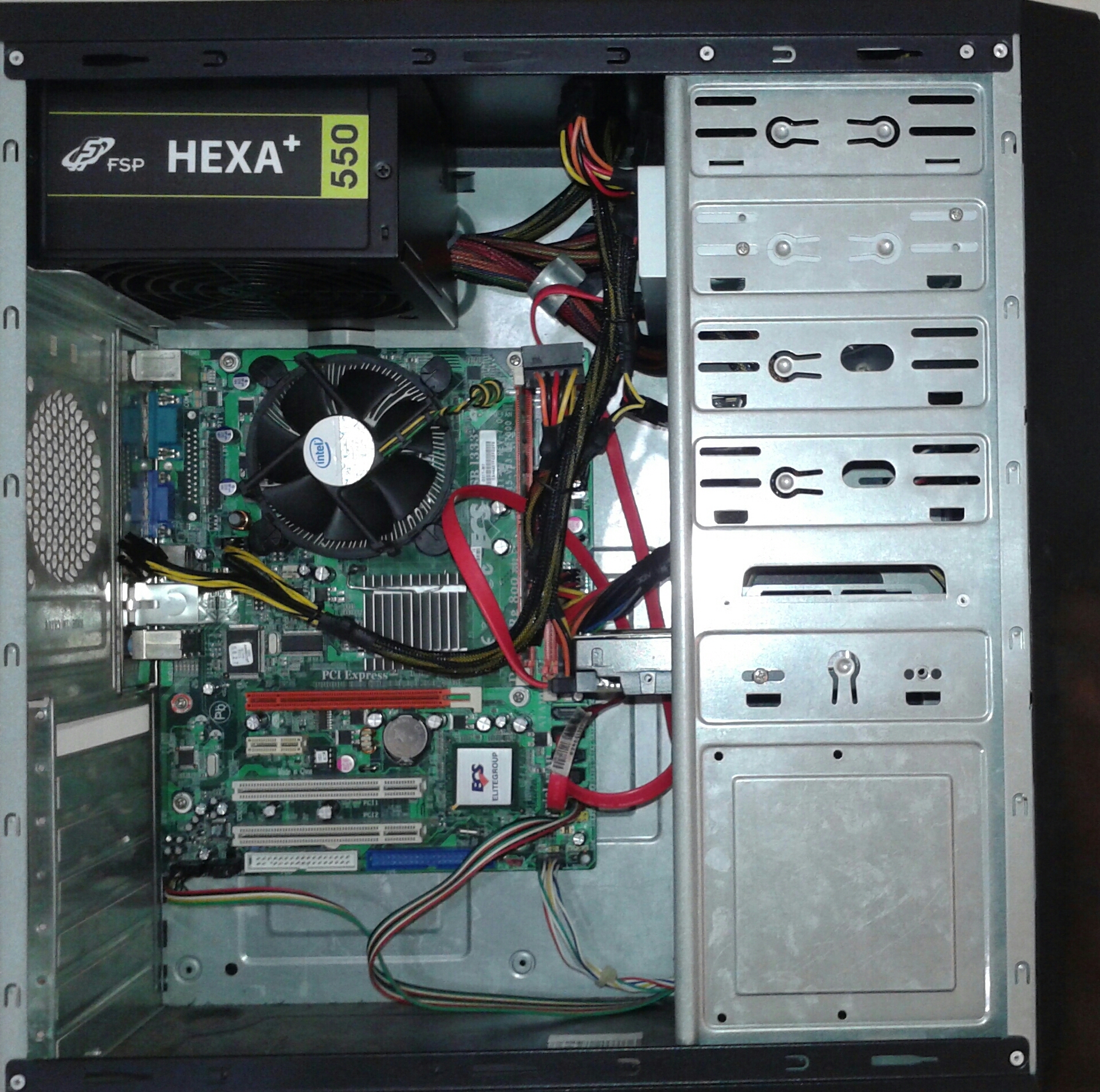

          .... I have replaced my unit PSU with a decent one which is the FSP HEXA+ 550W recently but the ECS motherboard still unable to boot up. Well, since I have narrowed the problem down to a PSU or motherboard, likely 95% chances of power related problem which caused motherboard being unstable. How about a PSU that keeps its output well within the required voltages, but has a huge amount of ripple and kill those polymer capacitors on the motherboard? And likely these capacitors here took up the ripple current from a poor quality PSU, causing them to heat up badly. Then how about a crappy PSU with non-functioning OVP. If that puts out high voltages, or high voltage spikes, there is nothing to shut it off, so the voltages could fluctuate fairly high too. Those sudden jumps between voltages could give voltage regulators problems too, which could give high output spikes to the RAM, CPU, chipset, GPU, etc. I've heard and seen horror stories of PSUs failing, and killing components. So my question here will a polymod on my ECS G31T-M7 motherboard especially on the PSU sides fix this problem here?

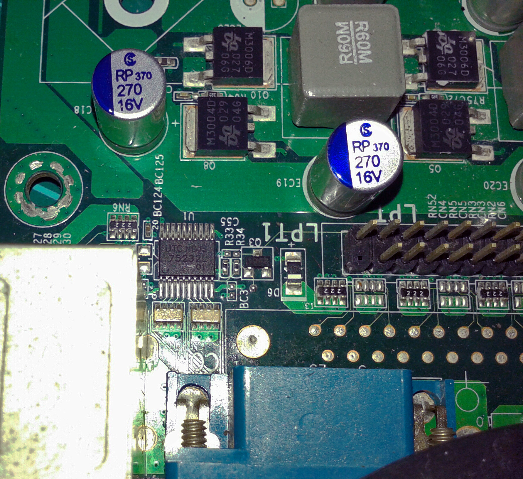

          POLYMER CAPACITOR PLAGUE
          A capacitor can fail open so that it's disturbing the flow of electricity in a circuit and then the circuit is no longer working at all. Polymer type capacitor can also failed shorted unfortunately or fail open without any visible signs. Polymer capacitor, don't have much of the problems of electrolytic capacitors. They don't leak or swell, due to absence of electrolyte which would cause gases inside. However it's possible one of them is shorted or damaged without showing any signs due to extreme heat (ex: MOSFETs near them shorted or broken and heating every others component around) but this would happen with any series of polymer type capacitors. It's also unlikely. More likely you have some shorted MOSFETs / cracked ceramic capacitors due to high voltages

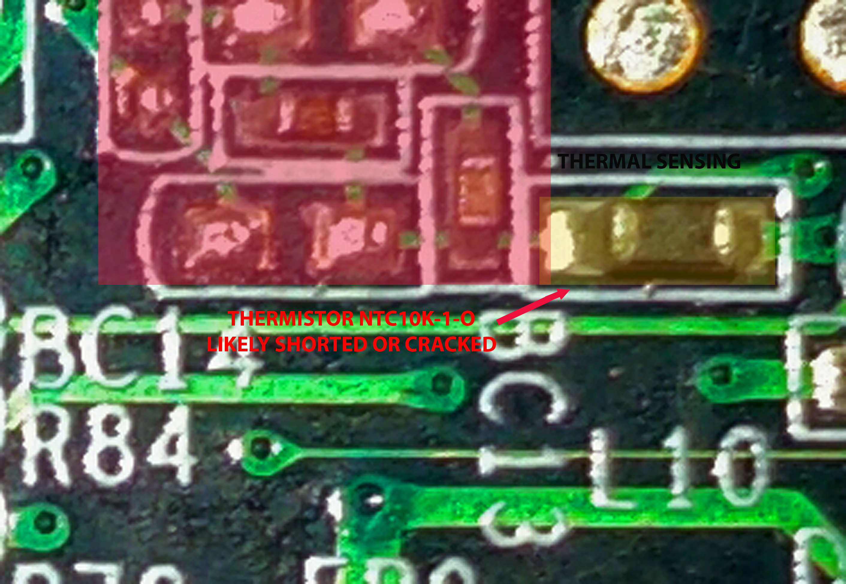

                *UPDATE*:The advantage of the TCC scheme might even require the user to turn off power at the back of the computer, then turn it back on, before the system will allow the front power button the be used. If you then press the front power switch again, it would shut down just as quickly for second time.
                ....In my case here I'm likely having a short or a cracked resistor within the TCC scheme when I checked on the ceramic SMD chip(refer PIC) near to the SIO chip since the PS_ON# signal is also not present at all - my digital multimeter shows 0V when I probe it on the green wire of the new FSP PSU. I would like to know if this chip can be replaced or can it be purchased anywhere else? And can it be possible to de-soldered it from the motherboard and how? Does anyone here have any ideas ?

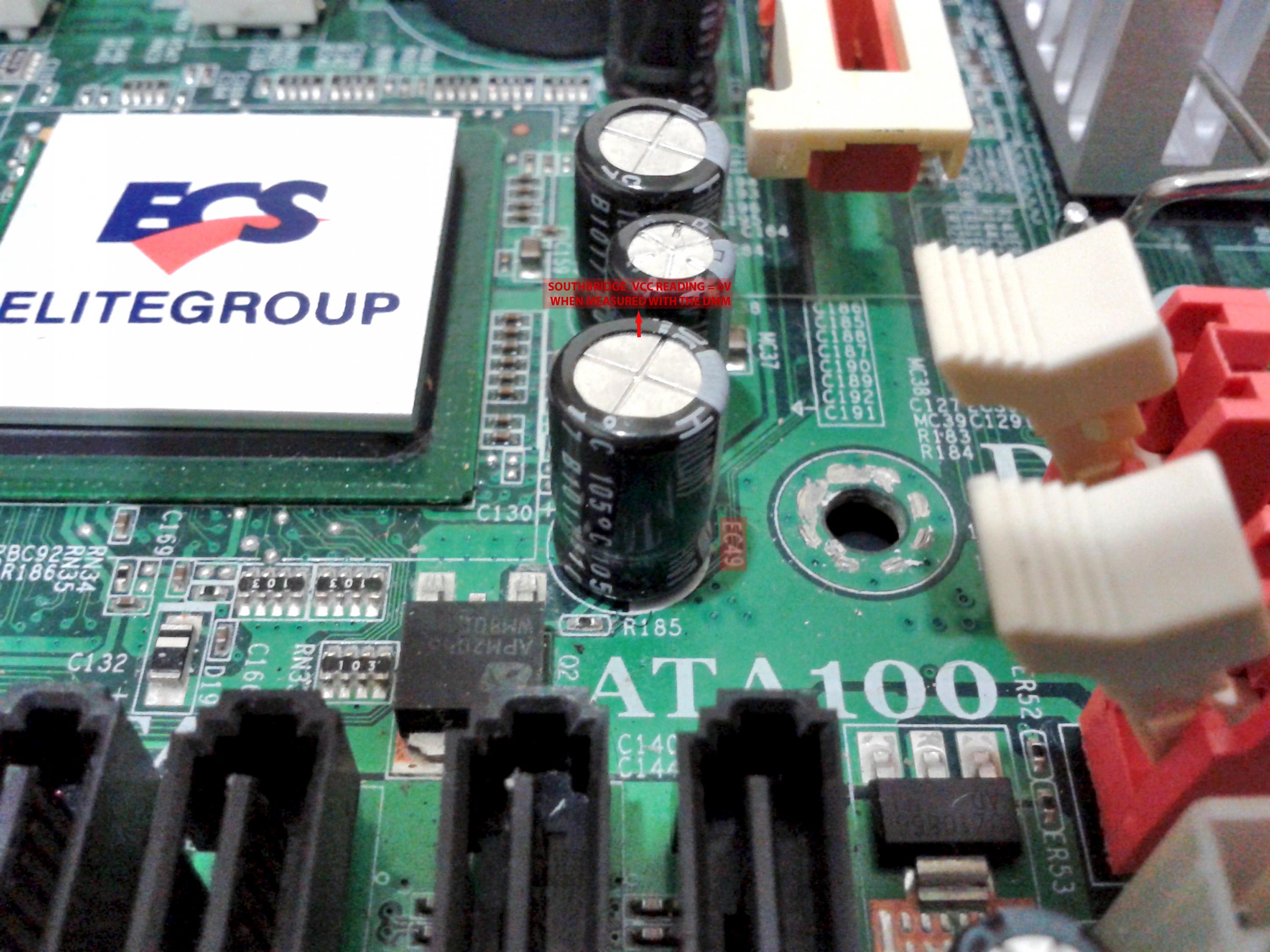

                  Also, I am just wondering where you measured the Southbridge VCC voltage. Your photo shows an arrow pointing to a capacitor. Did you measure the voltage on the positive lead of the capacitor, or on the capacitor body itself?
                  -David VanHorn
                    ...wow do you mean that I'm getting into all this suspected TCC sensor broken will likely be wrong...? Do you have any ideas to actually locate the right Southbridge_VCC or other voltages on the motherboard? For the voltage of the Southbridge_VCC, I abruptly measure the positive legs of all those 3 Nichicon capacitor located between the Southbridge and the ram slots, then I just get one of the capacitors reading which is EC49, so am I measuring the correct VCC voltage here?

                      The voltage at EC49 is called 'VDDQ' in the schematic (page 11). It's one of the power lines that supplies power to the ICH.
                      According to the power distribution chart it should be 1.5v. If it's 0v that's not good as you already know.
                      But note also that the VDDQ rail Is derived from the 1_8VSTR rail. See the schematic in page 11. They drop the 1.8v 1_8VSTR rail to 1.5v to make VDDQ, using Q21 and the opamp U4A in a linear regulator circuit.
                      The opamp U4A is enabled by the reference signal VREF1_05V
                      So, for VDDQ to come up to 1.5v, you need 1_8VSTR to be present at Q21's Drain and also the VREF1_05V rail to be present at the U4A opamp.
                      Check those and then let's see if they are OK too.

                                Hi Agent24,
                                It has been a while since the last post on testing the discrete signal through the capacitor EC49's positive lead. The EC49 capacitor is working perfectly but I found a badly overheated SMT package I.C. which happens to be the ST75185CT-S. From the schematic (page 25), it controls the COM port by getting a dual switching power deriving from the 5V and +12V PSU (flyback converters). It's a serial port controller, the one with label U1 from the picture I've attached...
                                Questions
                                I removed the ST75185CT-S SMT controller from the motherboard. I would like to ask if the picture here is the one which I can order for replacing the shorted one. I will be ordering component no./stock no. 686-4954 from http://my.rs-online.com/web/p/line-t...ivers/6864954/. Please do let me know if this is the real problem where the I.C. should be replaced with a new one?
                                Thank You...

                                  Your photo shows a UTC75232L:
                                  https://cdn.badcaps-static.com/pdfs/...776b6b3f8f.pdf
                                  The 75232 is a very common part that was manufactured by several companies:
                                  http://search.datasheetcatalog.net/key/75232

                                    Also you may want to look into reasons why the chip is overheating. The IC itself might have failed but also there could be an issue with its supply rails going out of spec or some part on an output pin is shorted to ground etc, like one of the capacitors on a data line maybe.
                                    686-4954 should work as replacement.

                                        As for the RS232 IC, sometimes these fail when using long cable runs.
