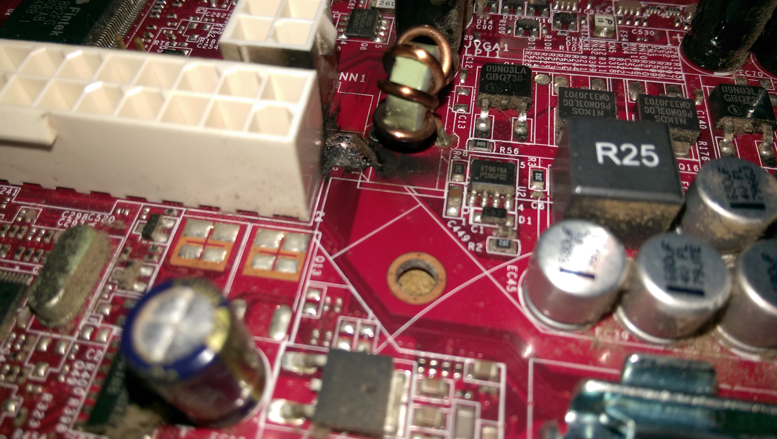

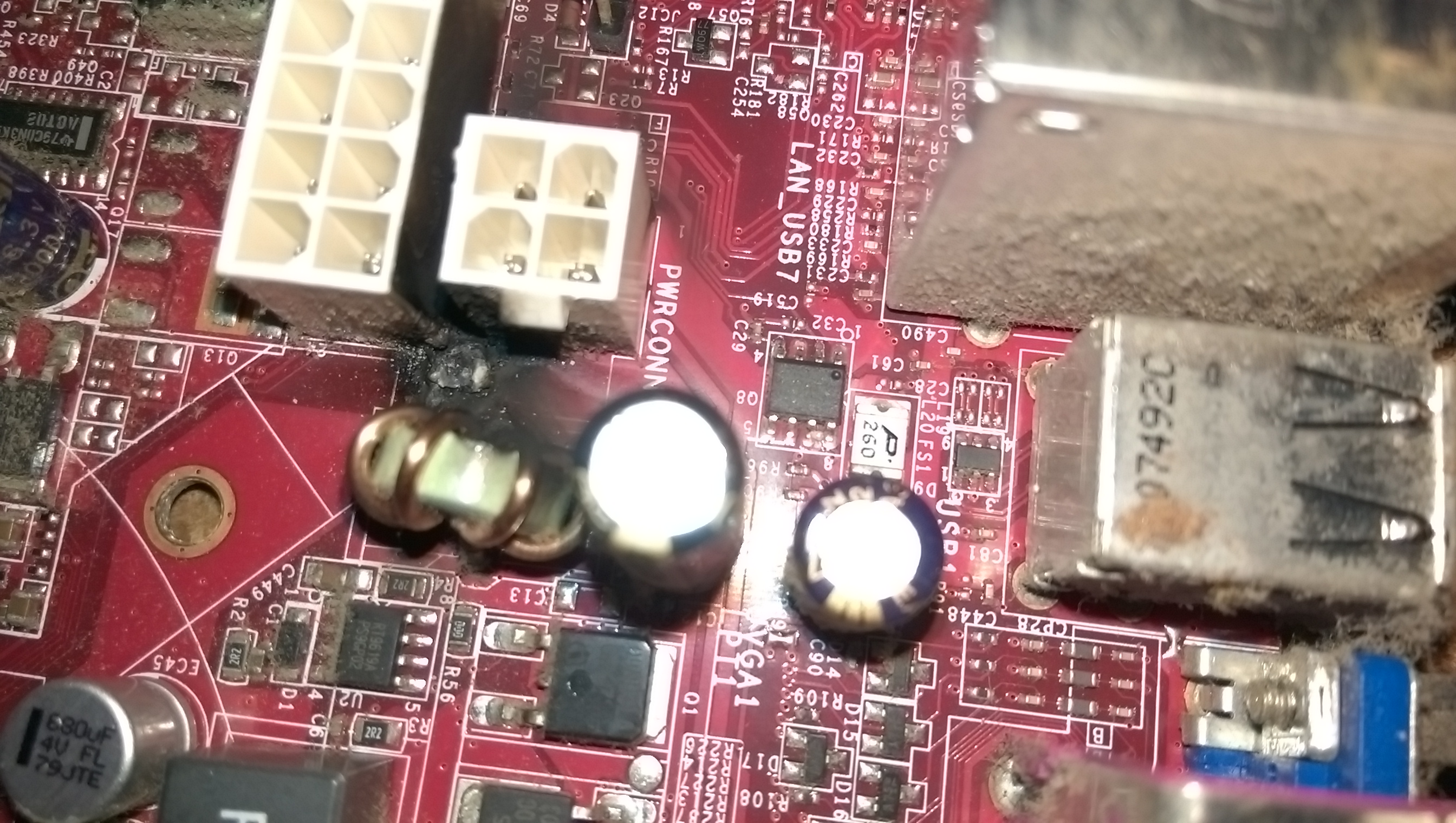

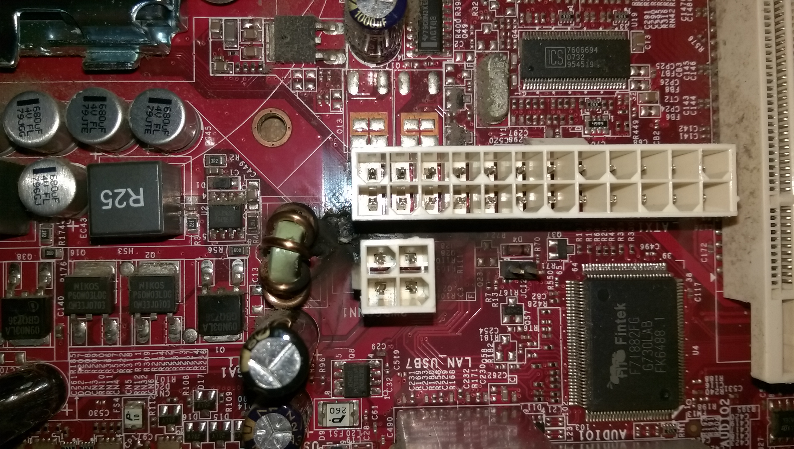

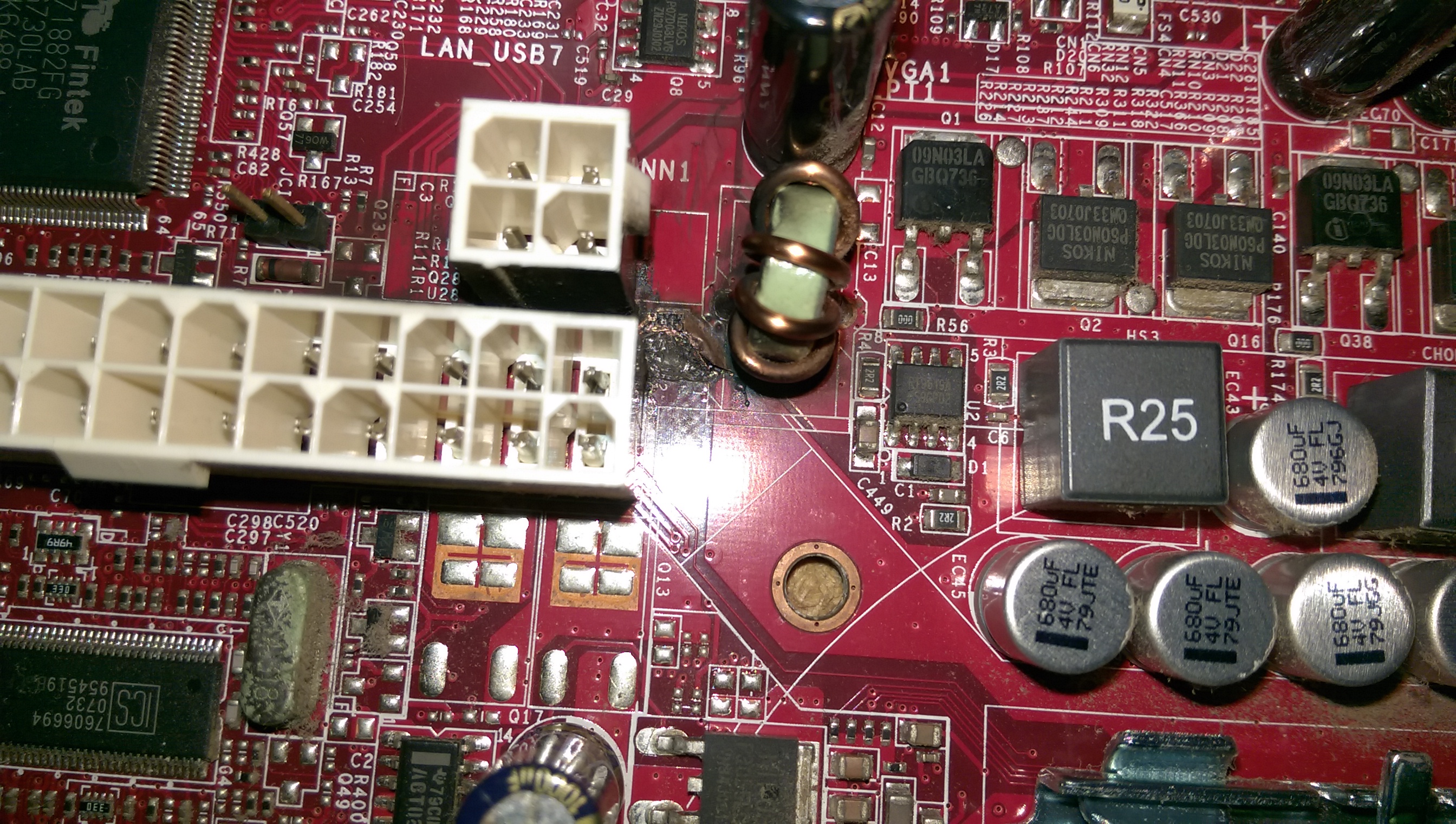

    A customer at work brought his PC in not POSTing. I pulled the side off, and immediately noticed something that there was a pretty decent sized burn mark near the ATX power connector. It looks like a small surface mounted capacitor went up in flames. Initially, I thought that the board might be repairable, as I still have the poly-modded 945GCM5 board at home, so I could probably figure out what value it was. However, now that it's out of the case I don't think I'll bother. That cap has actually burned all the way through the PCB...

    I've never seen that before. Was the PSU that was powering it bad? Is that a bulged Teapo at the top corner of the board?
    Yeah...Who knows what kind of damage occurred on the layers that you can't see.

      Re: Another 945GCM5 - SMD capacitor burned through PCB
      The PSU was fine, actually. It was an In Win IP-S400CQ2-0. And yes, that El-cheapo Teapo cap in the corner there by the RAM is indeed bad, but there are enough caps that appear to be OK downstream of it in the VRM that I don't think it should stop it from POSTing.

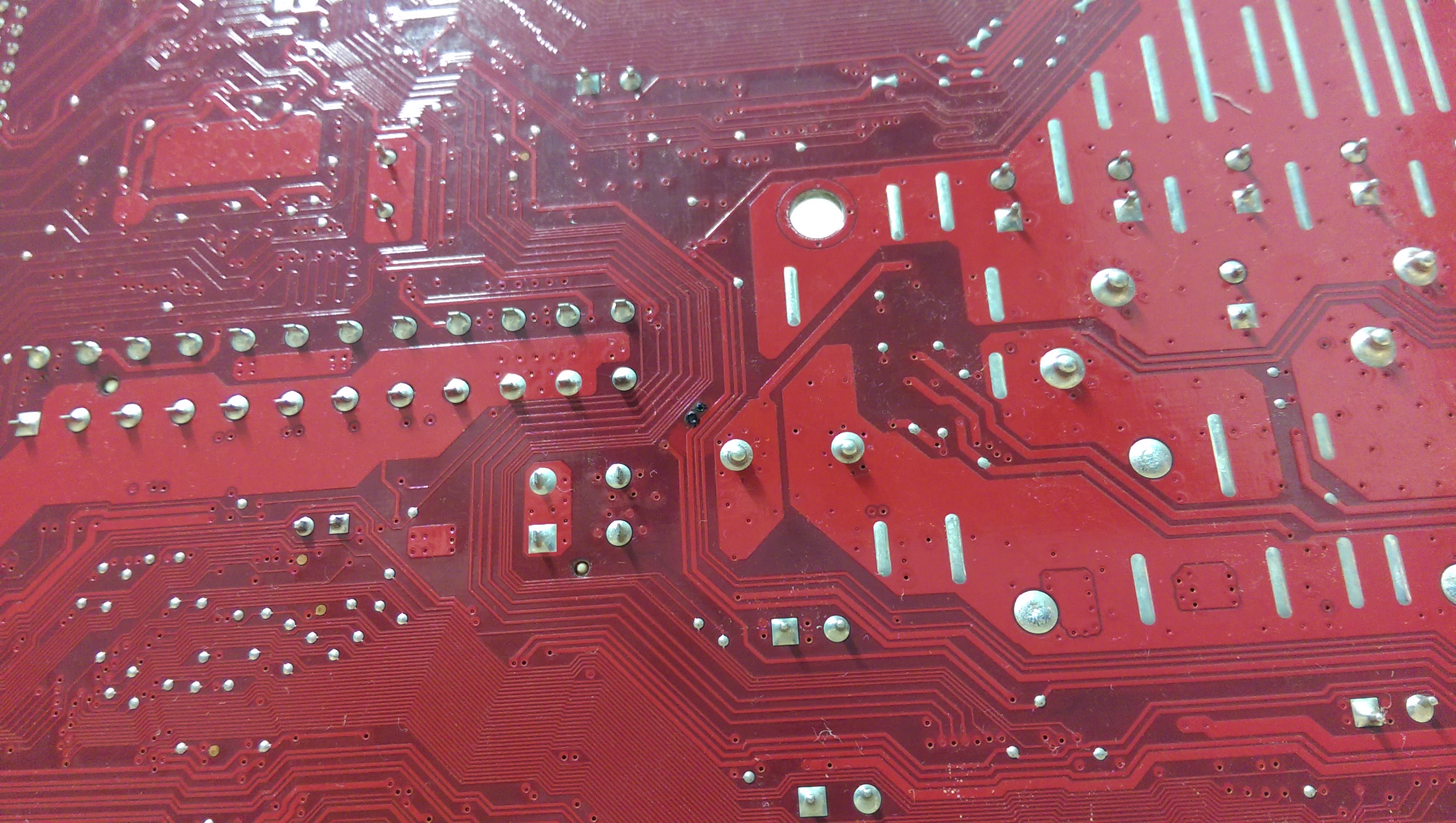

      I decided to clean some of the soot off the board. The pads for that SMD part are completely gone and there's a little crater in the PCB, and I can see what looks to be copper on the edges of it underneath the top layer, so I'm almost certain that other layers are damaged. I'll upload some pictures a bit later.
        As promised, here's the crater.
