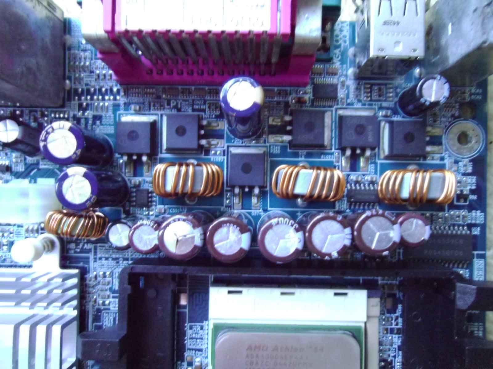

    Both Rev.1 and example of mass production variation
    First has MBZs for VRM input and KZGs for output - one KZG blown, shown in pic

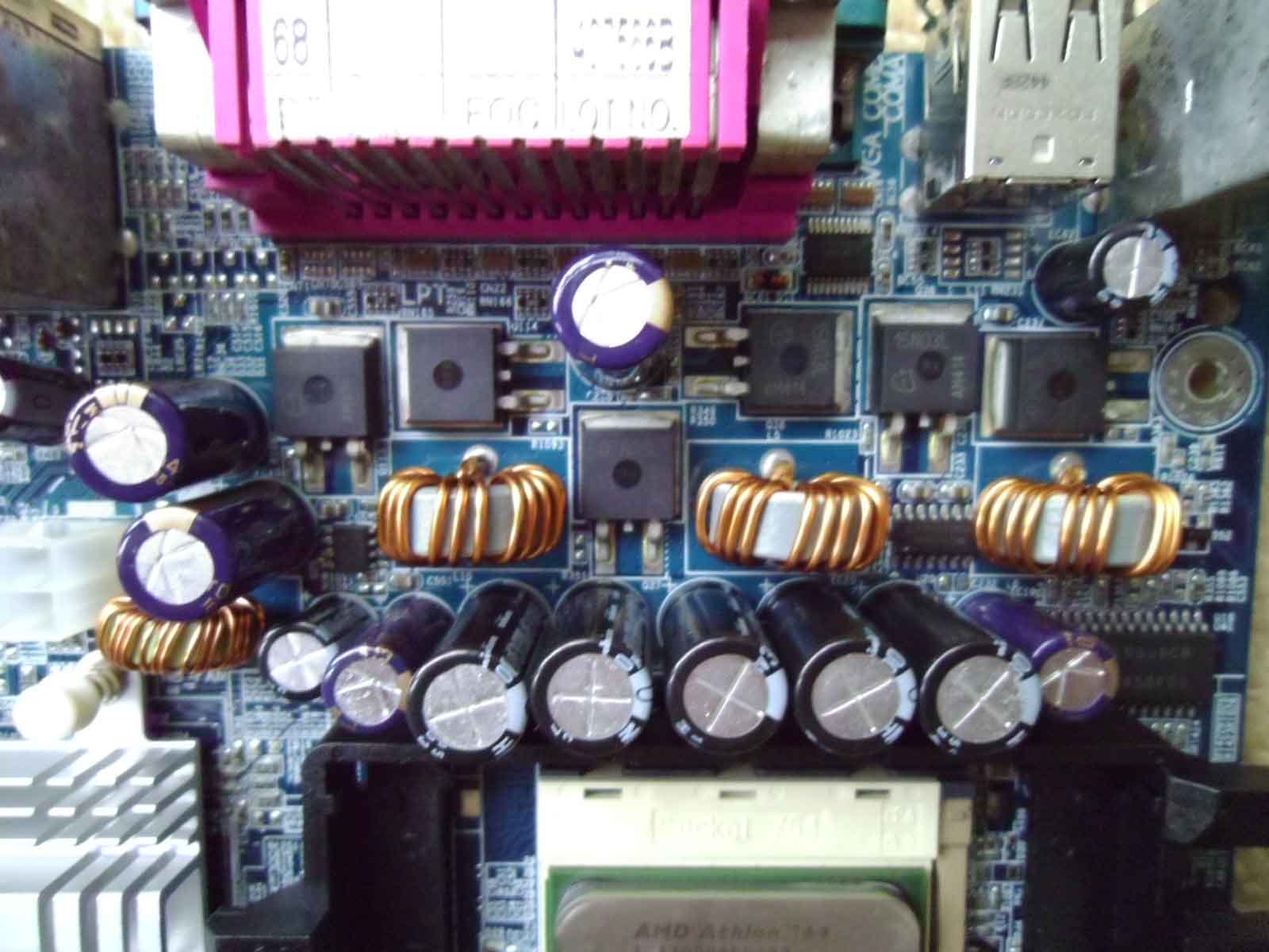

    Second has KZGs for input and MBZs for output - all look OK, pic

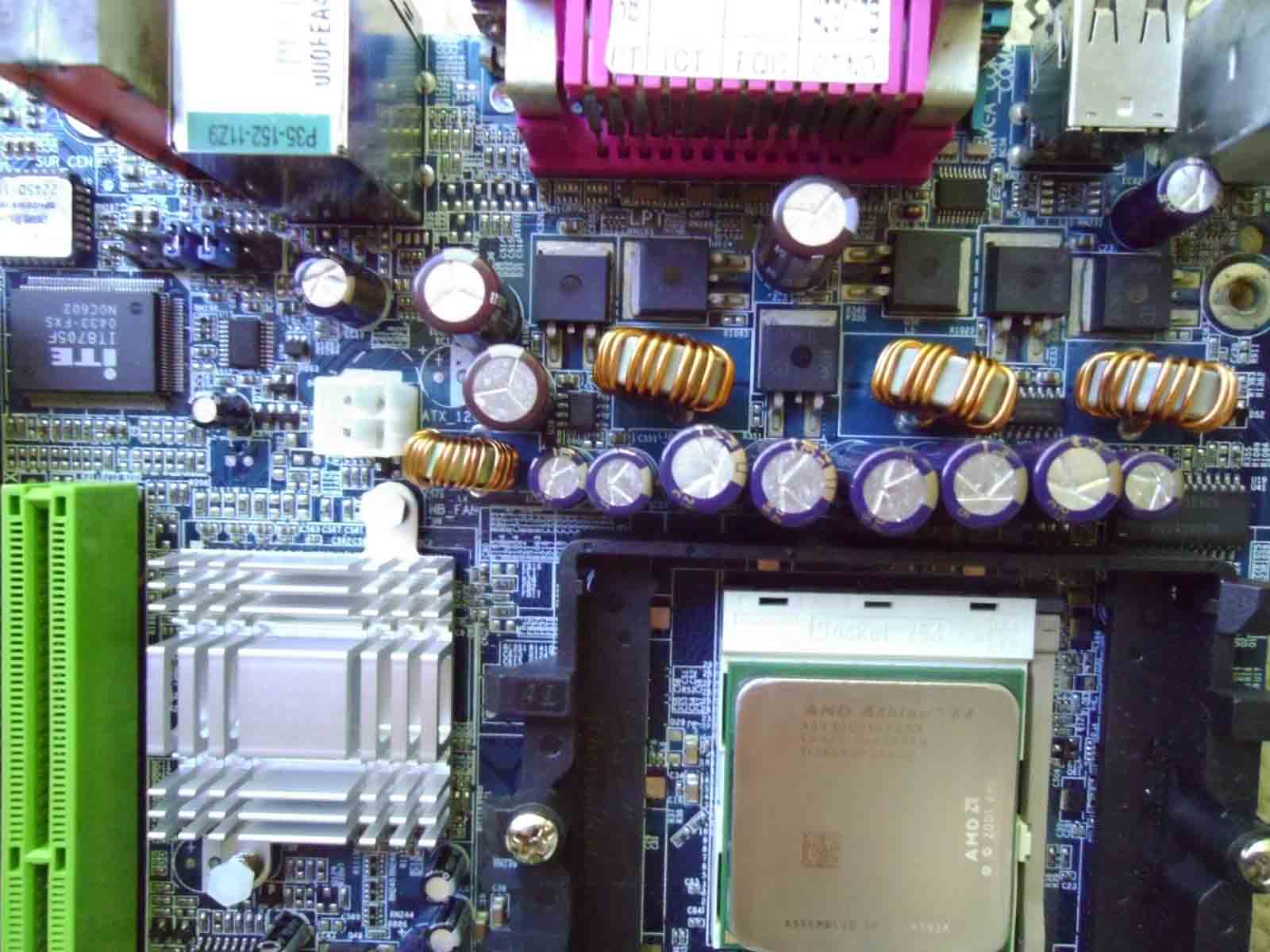

      With the first, I replaced KZGs with recycled HMs and thin MBZs - deprecated practice, but board's worth very little

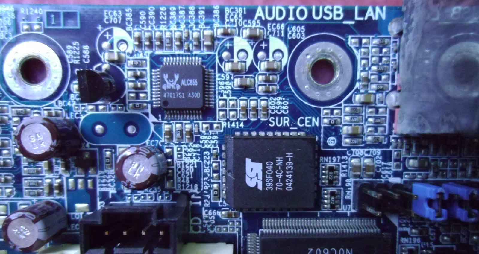

        The first did an install of Windows XP with one issue - Code 10 for Sound - it's Realtek ALC655, using a well proven driver
        In Details it has SUBSYS_00000000 - compared to SUBSYS_A0021458 for one without issue
        No issues at all with second - no exclamations in Device Manager, including Realtek AC97 - but no sound either
        To verify, I swapped in my Rev.2 K8VM800M - and after XP adjusted for its differences, there was sound
        I've tried different drivers, and older BIOSes, all to no avail
        Along the way, its Realtek AC97 device vanished - don't even see Sound allocated an IRQ, in list shown by BIOS during startup
        I've even tried replacing original three 100uf 10v Teapo near ALC655 chip, with 100uf 16v KMA recycled from a defunct Intel board
        Shown in this pic - note default jumpers on F_AUDIO, been caught before by that gotcha for no sound

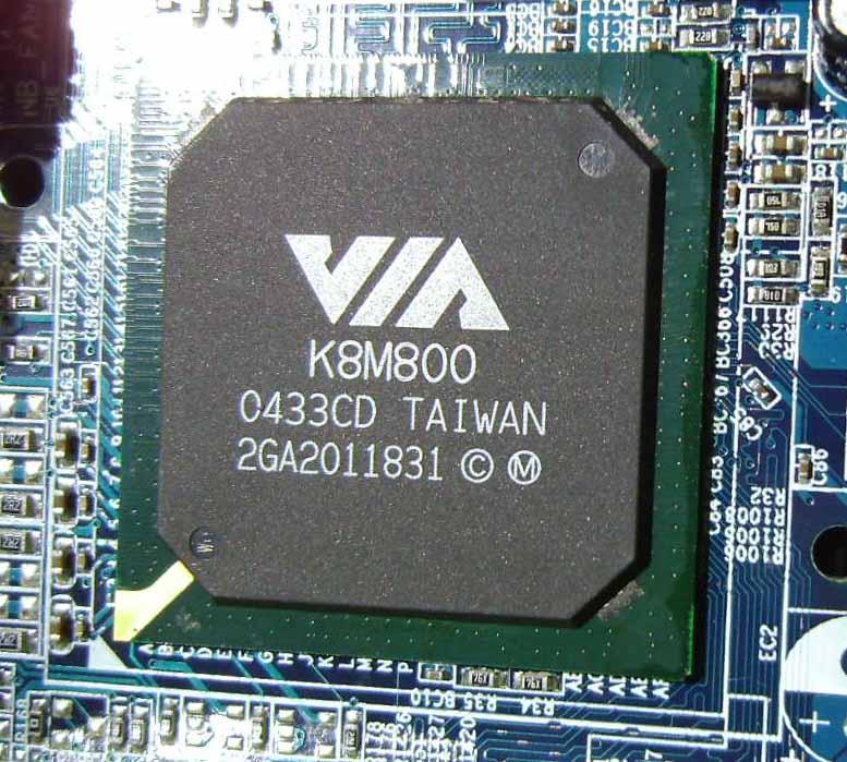

                                    Before having another go with compressed air turned all the way up to Eleven, I decided to remove the northbridge heatsink
                                    To find a smear of water down one side of the chip - right side in the attached pic
                                    So I sprayed it all over again with Isopropyl alcohol, then finished off with compressed air, a bit higher than previous but nowhere near maximum
                                    Afterwards, the problem of losing CMOS settings was fixed
                                    Unfortunately on-board sound hasn't come back - maybe I'll have a look at voltages on the ALC655 later, although fineness of its pins is a bit off-putting
                                    So lesson learned - static air drying is insufficient after a bath - need moving air as per https://www.badcaps.net/forum/showth...hlight=smokers
