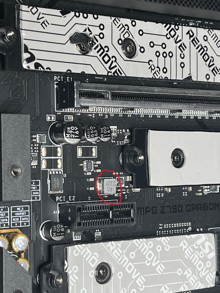

mpg z790 carbon NO POWER
  • kjchatman
    • Dec 2012
    • 213
    • united states
    mpg z790 carbon NO POWER
    the coil that i circled in the picture has zero resistance to ground. i'm thinking it's a shorted power rail. is anyone familiar with this motherboard? Click image for larger version
Name:	IMG_1105.jpg
Views:	471
Size:	245.0 KB
ID:	3564069
  • kjchatman
    • Dec 2012
    • 213
    • united states
    found a boardview for this one and that coil is for a 3 volt standby power rail. a shorted capacitor was the issue
    • PantherDave
      by PantherDave
      Hi all!
      05-29-2024, 02:01 PM
    • GLISIT
      by GLISIT
      01-16-2025, 02:29 PM
    • madan1
      DALI SUB E-12F class D, fluctuating power rail
      by madan1
      Good day everyone.
      I have on the bench an amp board from DALI SUB E-12F. It is class D amp with a smps on the same board.
      The issue is that it powers off way before the rated power is reached (the protection circuit kicks in). It has an independent standby power supply, which stays on after the main power supply is turned off via a relay on the primary side (thus there is no reason to believe that the protection is triggered from the smps IC on the primary side).
      The normal value of the positive and negative power rails is +/- 43V.
      The positive rail stays...
      10-15-2025, 10:33 AM
    • mkdj
      Acer TravelMate P214 - N19Q7 main power rail shorted to ground
      by mkdj
      Dear all,
      I have taken out the motherboard of a Acer TravelMate P214. There is a short to ground on the main power rail (19V). I don't have the schematics or boardview for this board (DAZ8IMB1AA0 REVA). But I have found 4 MOSFETS close to the main power rail : 2 N-Channel and 2 P-Channel.
      I have checked resistance across each of the 4 MOSFETS. I have the following readings:
      Both N-Channel Mosfets: nothing odd
      P-Channel MOSFET number 1:
      source - drain : 117 kOhm
      source - gate: 96 Ohm
      gate - drain: 117 kOhm
      P-Channel MOSFET...
      08-20-2025, 06:08 AM
