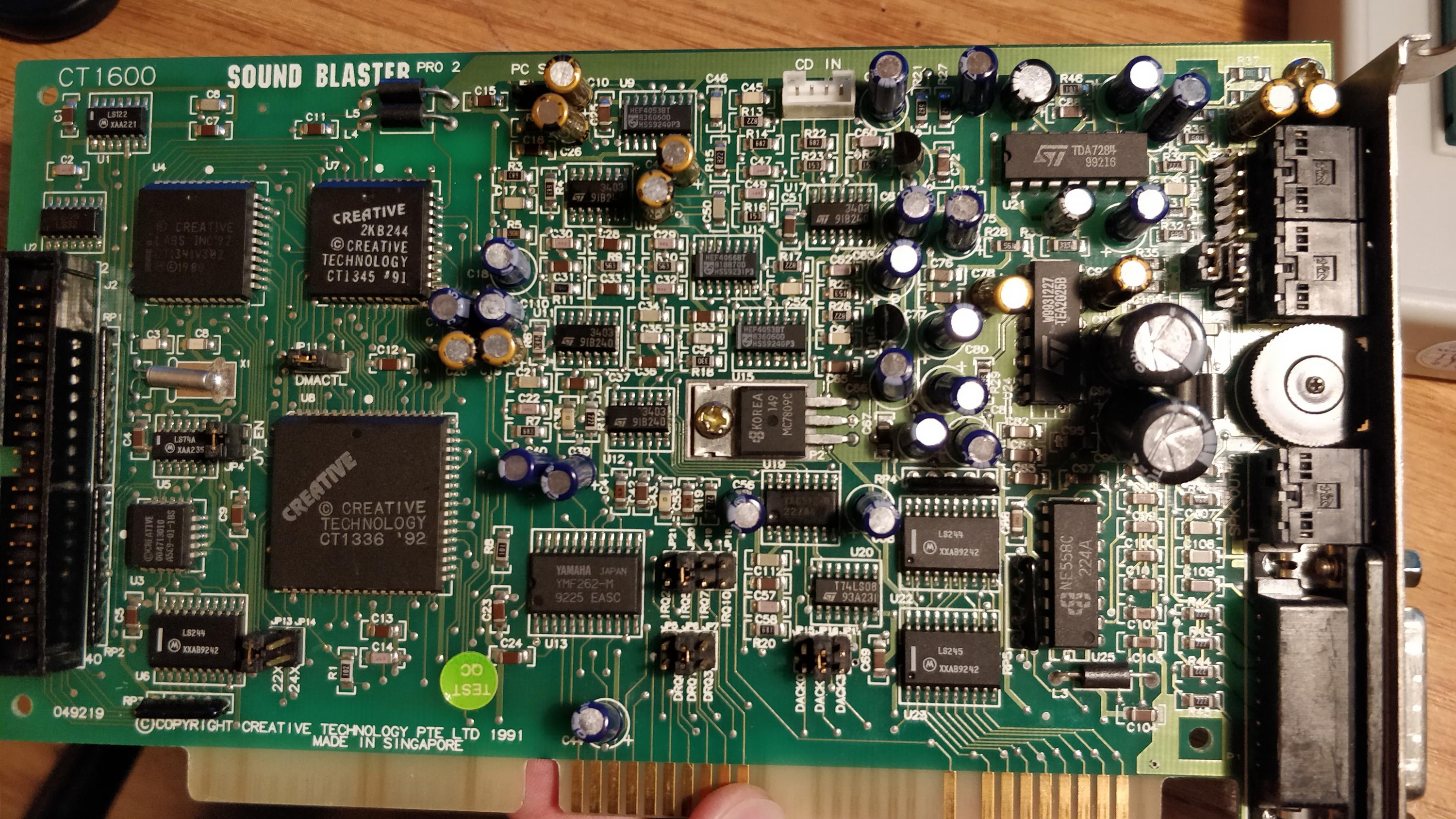

      Originally posted by Dusko75
      Hi and thanks for your reply,
      my idea is to make this card sound the best it can, I'm aware it's an old technology and by no means is hi-tech, (it was basically for video games). I want to make sure that it doesn't lack any frequencies due to bad caps.
      In that case, the caps around the TEA2025b integrated amplifier (U24 on your board) are probably the most important. In particular, check if capacitors C93 and C94 are connected to pins 2 and 15 of the TEA2025b chip. If they are, those are the output caps for your Line Out jack. If you are using it to power passive speakers or headphones, then you might want to increase their capacitance to at least 1000 uF.
      The caps around the TDA7284 are probably the second that matter the most, as that IC also has amplifier inputs and outputs.
      Of course, you are recapping the whole sound card, if I understood correctly, so that shouldn't matter too much.
      I didn't do a lot of research yet but it looks like Japanese (Rubycon) caps are among the best, and easy to find on e-bay.
      Rubycon, Panasonic, Nichicon, and United Chemicon are all good choices.
      I wouldn't get them from eBay, though. As stj said, there are a lot of counterfeits there. And it's not going to be that much cheaper (if at all), so it's not worth risking it. Since you are located in the USA, Digikey.com and Mouser.com would be where I go for genuine Japanese caps. Additionally, Badcaps.net has a capacitor store as well, if you are able to find all of the values for those small caps (as the store is suited more towards motherboard capacitors).
          my idea is to make this card sound the best it can, I'm aware it's an old technology and by no means is hi-tech, (it was basically for video games). I want to make sure that it doesn't lack any frequencies due to bad caps. I didn't do a lot of research yet but it looks like Japanese (Rubycon) caps are among the best, and easy to find on e-bay.
          Please feel free to correct me if I'm wrong or if you have any ideas, that's why I came here for.
          Also, here is a picture of it,
          Thanks for your time!
          Dusko.
          Post a list of the caps in this manner:
          Voltage, Capacitance, diameter (width x height)

            Re: SoundBlaster Pro 2.0 recapping
            Originally posted by mockingbird
            I would honestly just replace them. 1995... Even 1995 is almost 25 years old... Funny, old Panasonic butyric acid caps in ancient boom boxes work great after 40 years, but 20 year old caps leak elecrolyte and dissolve solder mask and copper traces (our brilliant member Wester547 might have some input on this).
            Hah, I’m hardly knowledgeable, nevermind brilliant. But thanks for the vote of confidence.
            Generally, the use of tetraakyl quaternary ammonium salts caused that problem. It raised the pH balance of the (then alkaline) electrolyte which expedited the deterioration of the rubber bung to the point of electrolytic leakage, after which the very acidic and conductive electrolyte does away with the solder mask, PCB traces, et al, in what sometimes can be a spectacular manner, as you noted. The quaternary salts are still used in double-layer electrolytics.
            It also seems that there was a batch of Rubycon YK, Nichicon VR, and Chemi-con SM/SME series capacitors that had this issue as well, manufactured from the early to mid 90s (possibly late 80s too). All being standard 85ºC capacitors, they should not have behaved as the quaternary capacitors did, but it’s possible some other concentration of an unknown compound in the electrolytic solution was resulting in the same problem. It could have been some sort of solder residue or flux eating away at the rubber bung as well, but sometimes it would even happen with capacitors retaining their original leads so it could have been down to the quality of the bung itself. Either that or no one admitted to anything and silently resolved that conundrum (at least all the major brands admitted that no quaternary salts are used anymore in their regular electrolytics).

                  • eccerr0r
                    Solder Sloth
                    • Nov 2012
                    • 8706
                    #29
                    I'm going to wait until I really need that card again, right now I have other sound cards that I can use that don't have a mass of electrolytics on them =o
                    I guess the other thing is that these older sound cards more likely have power amps on them unlike newer cards and on-motherboard sound. The power amps, though only a watt or so, are single ended and thus need DC isolation caps which can dry out. They indeed are the marginal/bad ones on my card. Alas for many many years I've used external amplifiers and the onboard caps for the PA don't matter. But the ones for signal passage do matter...
                    The newer sound cards that don't have PAs have switched to all MLCC's (for cheaper assembly automation) and probably don't degrade as fast... or at all. They may start off sounding pretty crappy however.

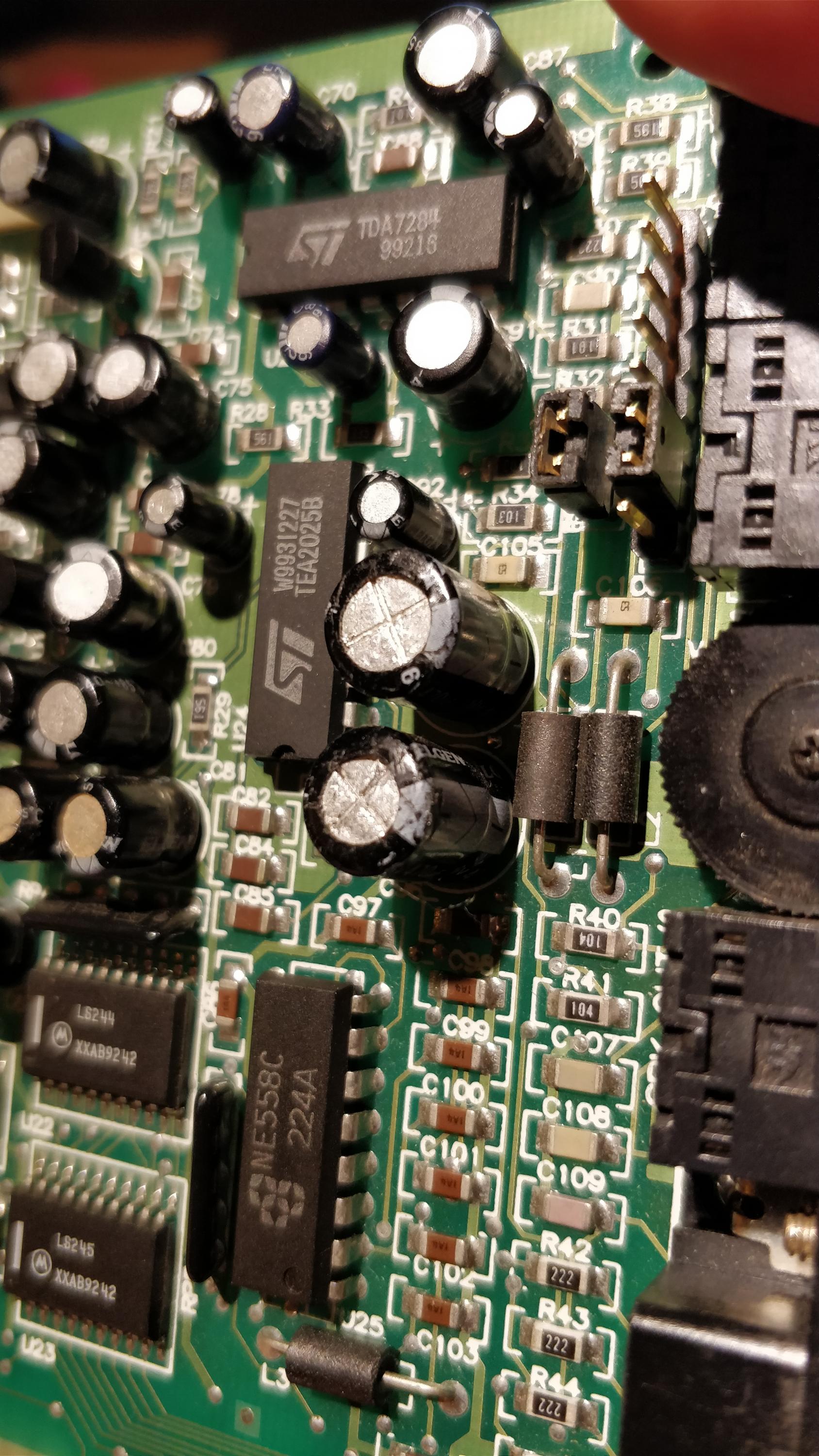

                              I forgot to mention, the two big caps (near the TEA2025B) both look like they have a dried residue on the top (leakage?), also the plastic cover doen't seem as tight as it should (like it was melted a little, or eaten by acid). The card itself has no residues, it actually looks amazingly preserved.
                              Thanks,
                              Dusko.
                                Yes, Those two caps are connected to those pins in the TEA2025B, they are the bad looking ones I mentioned in the previous post. I can't wait to test this thing!
                                  Here's a picture of the two caps...
                                        Doesn't look like any leakage is coming from them. When caps leak, they either do it from the top after their vent bulges and opens or they leak from the bottom, in which case the board would look in very bad condition near them (which I don't see on your board, so that's not the case). So whatever residue they have on them is from something else.
                                        Since those are the caps on the output pins, I suggest going with 1000 uF caps in the spot. That way, if you directly connect headphones or small non-amplified speakers to the sound car (on old cards, you can totally do that), you'll get better bass response.

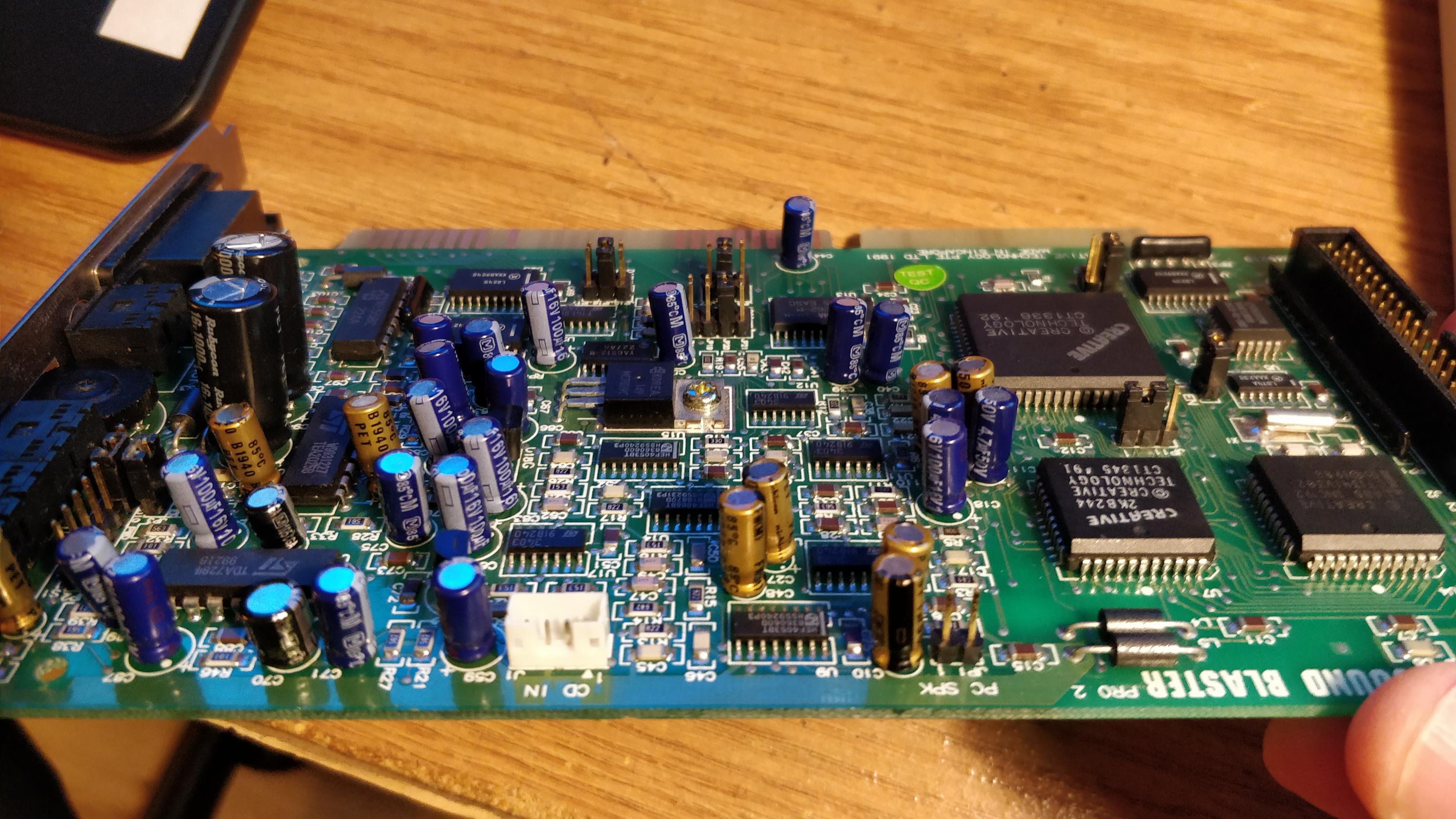

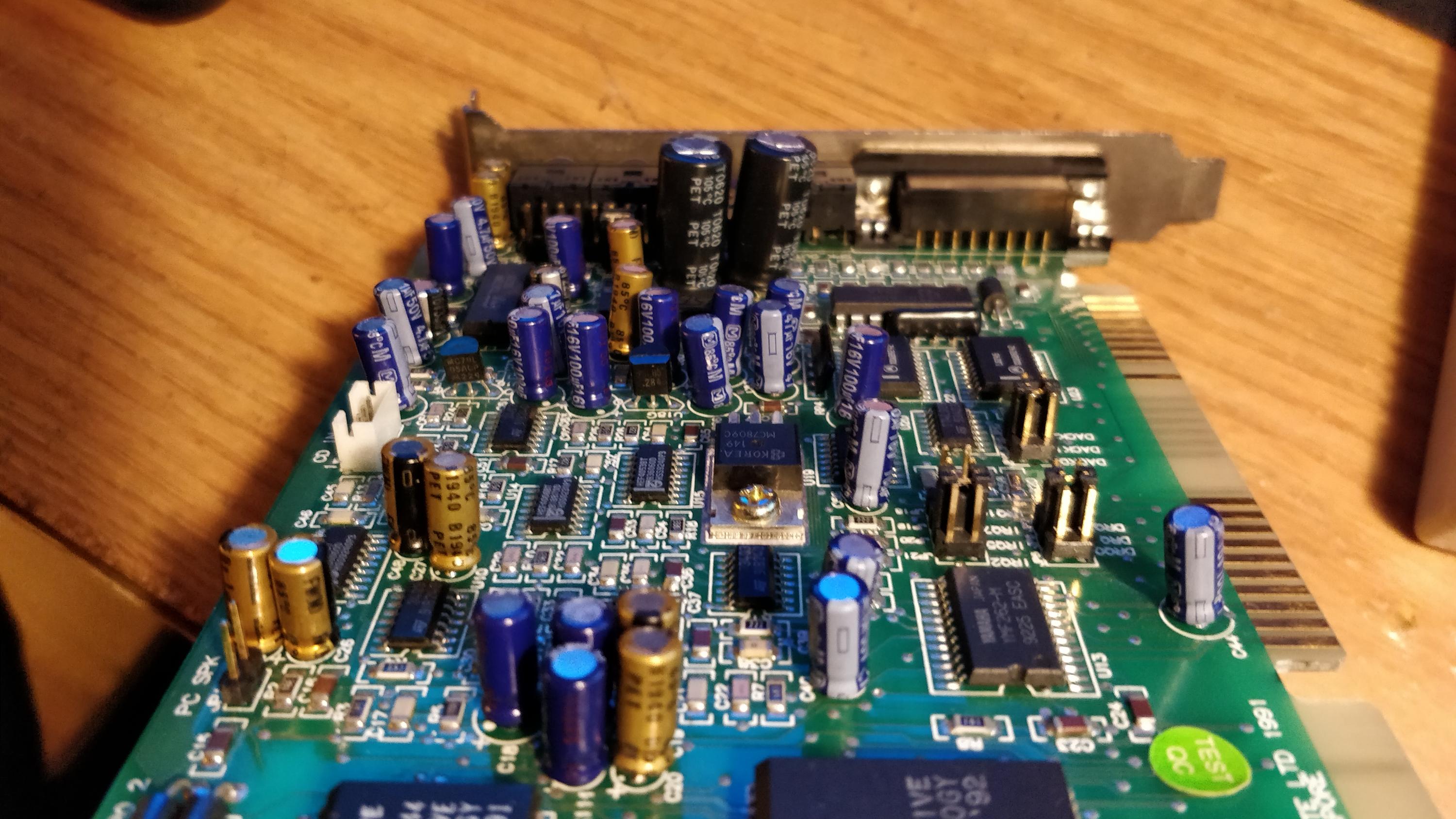

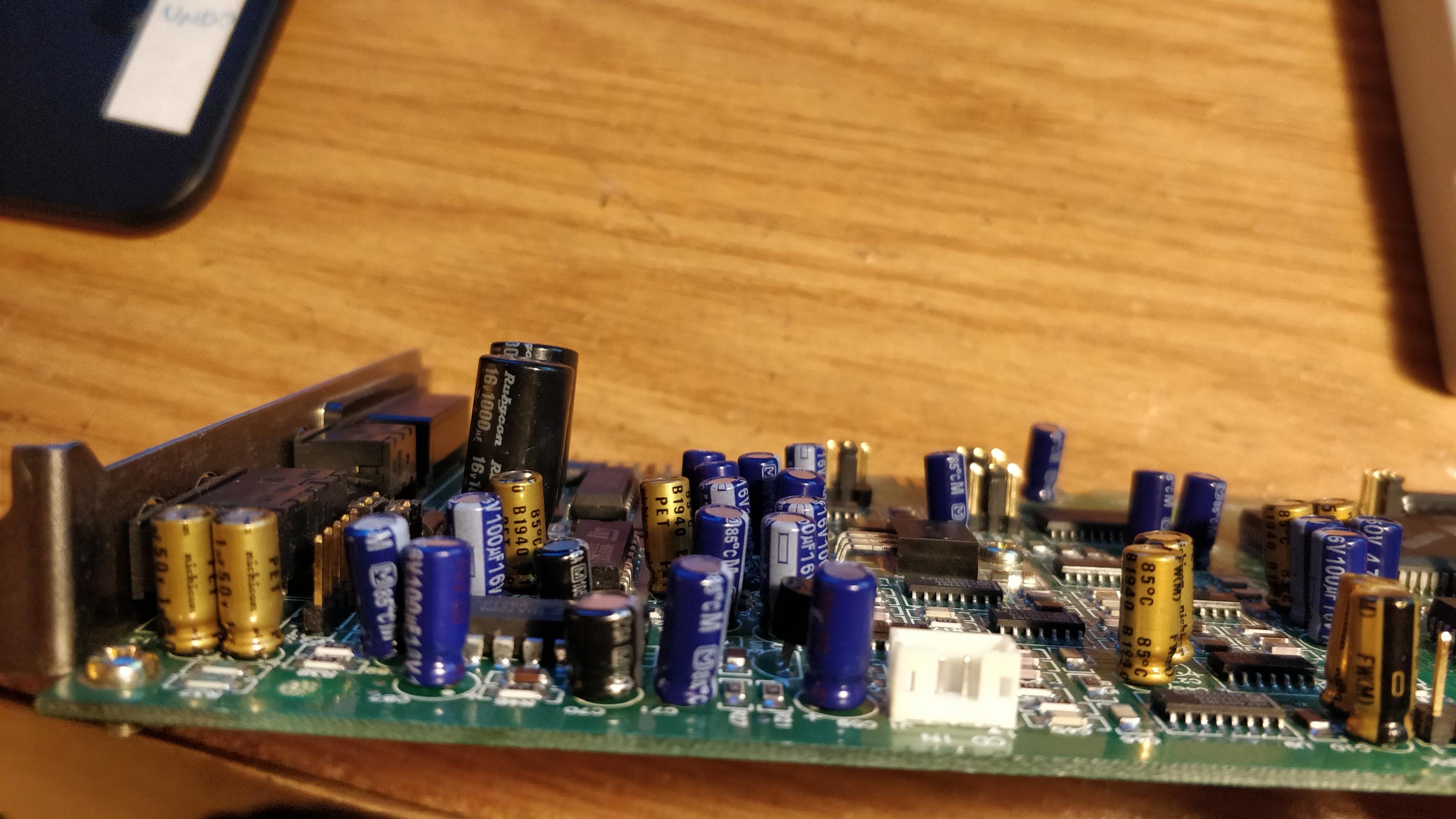

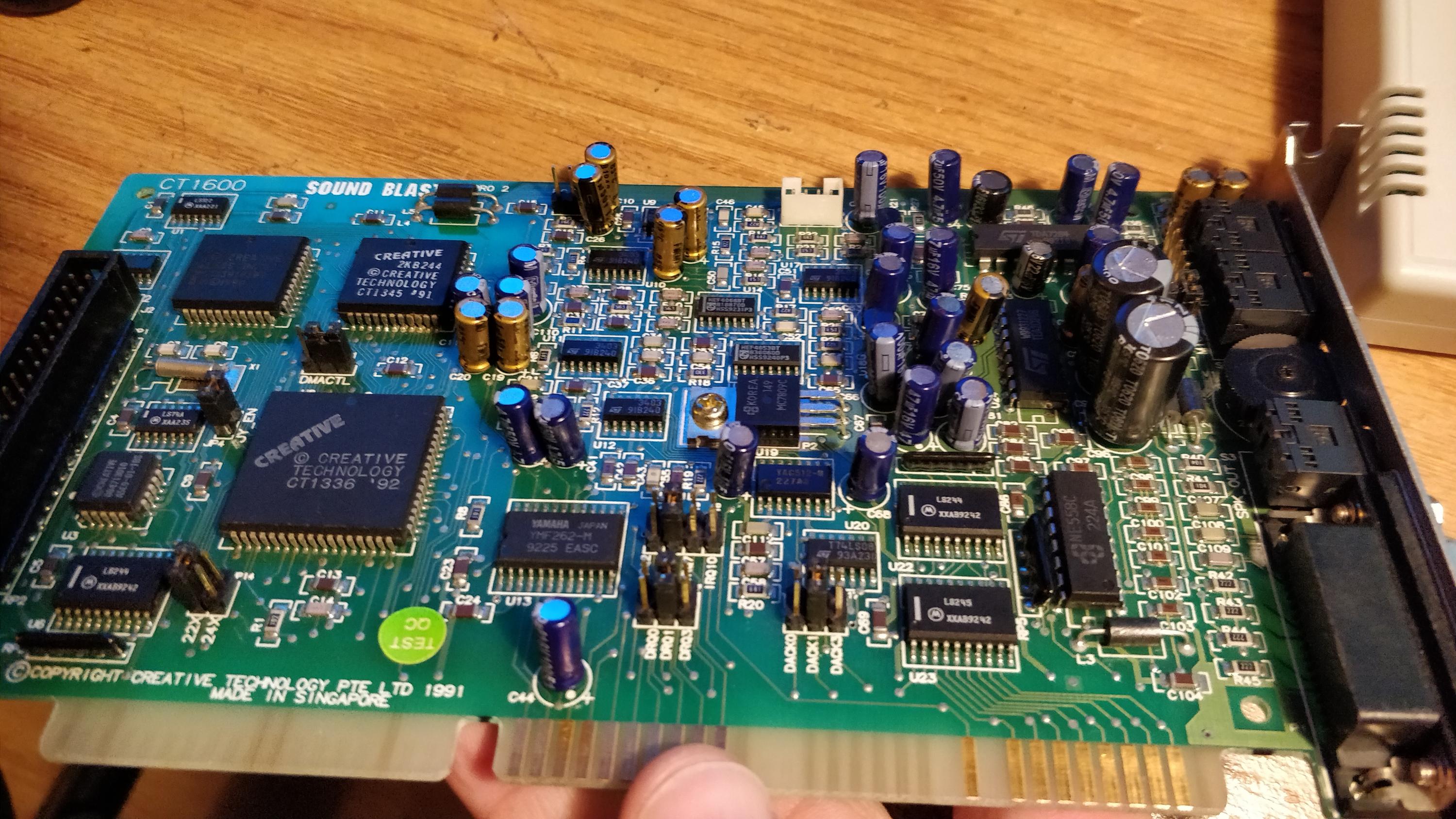

                                          Thank you momaka and everyone else's comments,
                                          it's been over a year I posted about my Sound Blaster Pro recap project, didn't forget about it!. Before getting into the recapping thing, I needed to get a 486 to do all the testing, I ended up buying 4 motherboards (2 ISA VLB and 2 ISA - PCI), I did that because they were having issues or not working at all, one of them had a bad BIOS, etc. etc., at the end I fixed all 4, it took me several months to figure out what was wrong with each of them! Also bought some CPUs and some video cards (all from Ebay), did have a hard time getting all that to work: jumpers, finding the mobo's manuals online, etc. also, I only have one tower to do all the testing (and/or playing around). The Sound Blaster Pro was super noisy on 2 of the mobos while the other 2 were surprisingly clean, even at full volume (actually, no noise at all). I thought recapping it would get a cleaner sound from the other two mobos but didn't happen that way.
                                          Recapping the Sound Blaster Pro:
                                          So, figured out all the caps from the board and bought all legit brands: Panasonic, Rubycon and Nichicon, got them from Digikey, (I'm just realizing "BADCAPS" SELLS CAPS!). This is my first recap project so it took me like 4 hours to finish, very happy with it, the board looks great but I haven't noticed any major improvements in sound quality, maybe a little more bass but not so sure about that. I'm going to need to do some recordings with my other Sound Blaster Pro (which is unmodified) and compare it to this one. The noise is still present on the other two mobos so it should be an ISA controller thing, maybe I'll end up recapping the mobos too. I got a ESR meter and the old caps seem fine (@120Hz) but I'm not an expert in electronics and caps are tricky to test, I found a couple of ESR charts online with different values so I don't know
                                          I'm still happy about this project, it's something I wanted to do for a long time, I'll post back after comparing the two boards, there probably is an improvement in sound quality that I haven't really noticed, it's not Hi-Fi audio anyway.
                                          Here are some pics...
