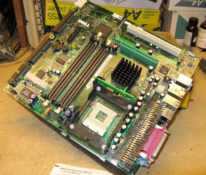

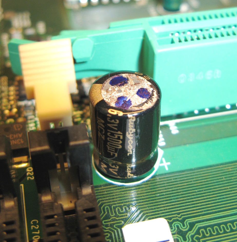

    Swollen Rubycon on Dell Optiplex GX270
    I have been recapping a series of Dells with faulty Nichi's (HM's). Each one has about 6 swollen caps around the RAM slots - all 1500uF x 6.3V.
    I have just ordered a bunch of replacement Ruby's of the same value when I opened a new PC today and surprise! Where there were all Nichi's, there are now Ruby's and one of them is swollen!
    Will wait till I get the rest of the PC's (about 20 all up) and inspect them before making any rash strategic judgments but I am interested to see what your take on this is?
    Should I up the ante and replace
    1. the cap in this specific location with 1800uF x 10v on each board
    2. or all the caps of this value whether they are already Ruby's or not?
    Will be interesting to see what the other boards tell! Will keep you posted.

    Re: Swollen Rubycon on Dell Optiplex GX270
    Something is fishy.
    Are rubycons usually blue or dark blue?
    That looks black. The gold printing is also suspicious.
      They can be any of several colours.
      Not sure what determines colour selection at the factory but MBZs are Blue and MCZs are Chocolate - maybe a clue there
      Got a blue ones from Computek before but the last lot I got were all as pictured.
      (Blue ink on caps is mine. Pics taken at ISO 80 thanks to Willawake)
            I'd say probably 90% of the Rubys I've seen fail are those ones between the AGP & RAM slots, yes. However I've seen some of the 1800uf 6.3 8mm ones fail on the rare occasion.
              I've seen Rubies fail in that position on the GX270 several times. It's caused by a failure further up the line, when the 3x 1800uF 16v Nichicon's under the heatsink fail, they overload this particular cap. The cap itself was not faulty.

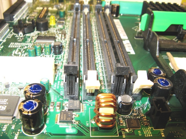

                    Have you ever seen any Rubycon caps located at the end of the RAM slots (see pic3) fail or are these always OK?
                    This board obviously holds some unique surprises. Were there any Nichicons hiding under the heatsik on these?
                    Given the remote odds, I would not recap a CPU row of Rubycons unless I found obvious signs of failure.

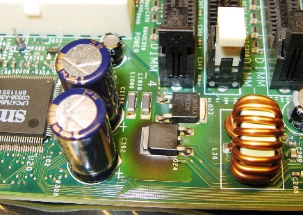

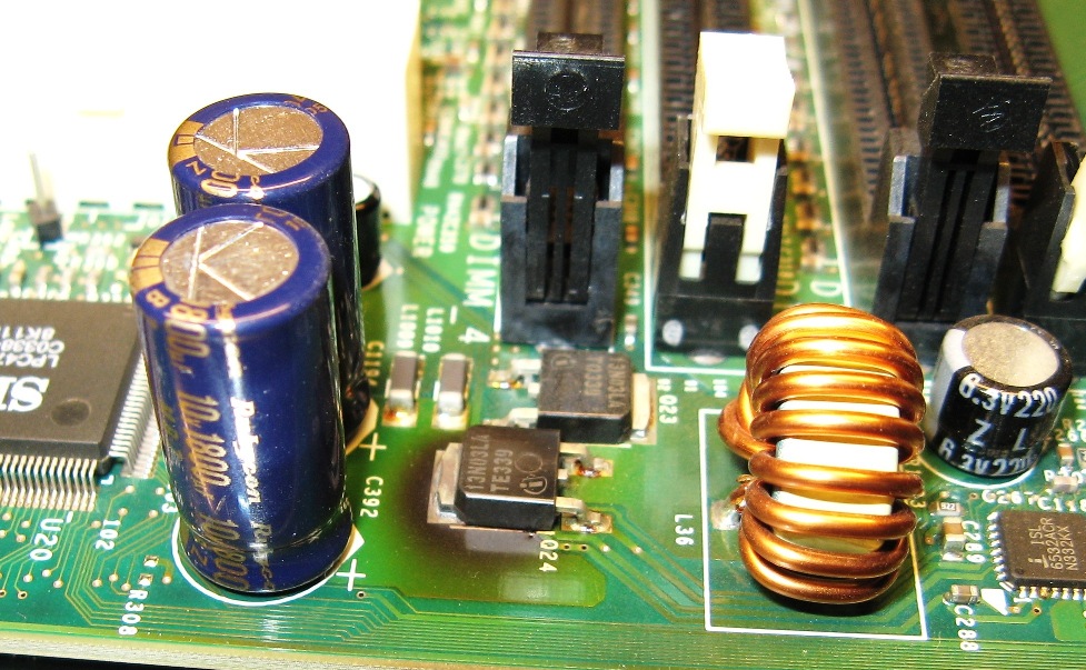

                            20 boards finished OK except two.
                            On three boards, I replaced the 1500uF x 6.3V with 1800uF x 10v since I did not have matching values. Two of these expired after a short while because of VRM failure in the same location on both boards.
                            Judging by the scorch marks on the PCB, I question whether it worthwhile attempting to replace these as the board has probably sustained damage.
                            What do you think?
                            • Rainbow
                              • Aug 2005
                              • 1375
                              I guess that when you replace the two MOSFETs (only one is smoked but both are probably bad), it should work.
                                Thanks, might give it a try just for the hell of it!
                                Where would be the best place to get these in Australia?
                                Thinking of placing a small order with Mouser - wonder if they would have them?
