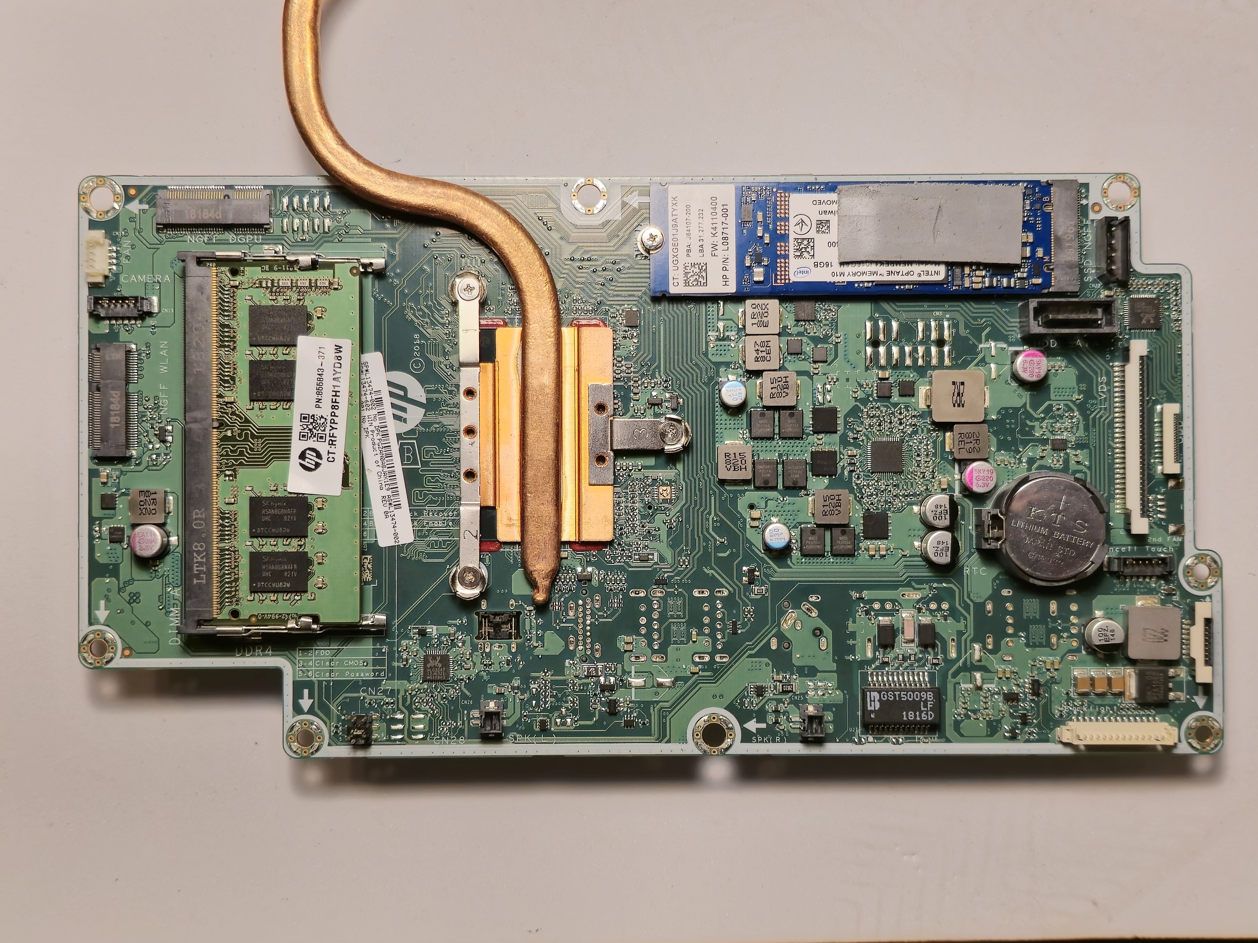

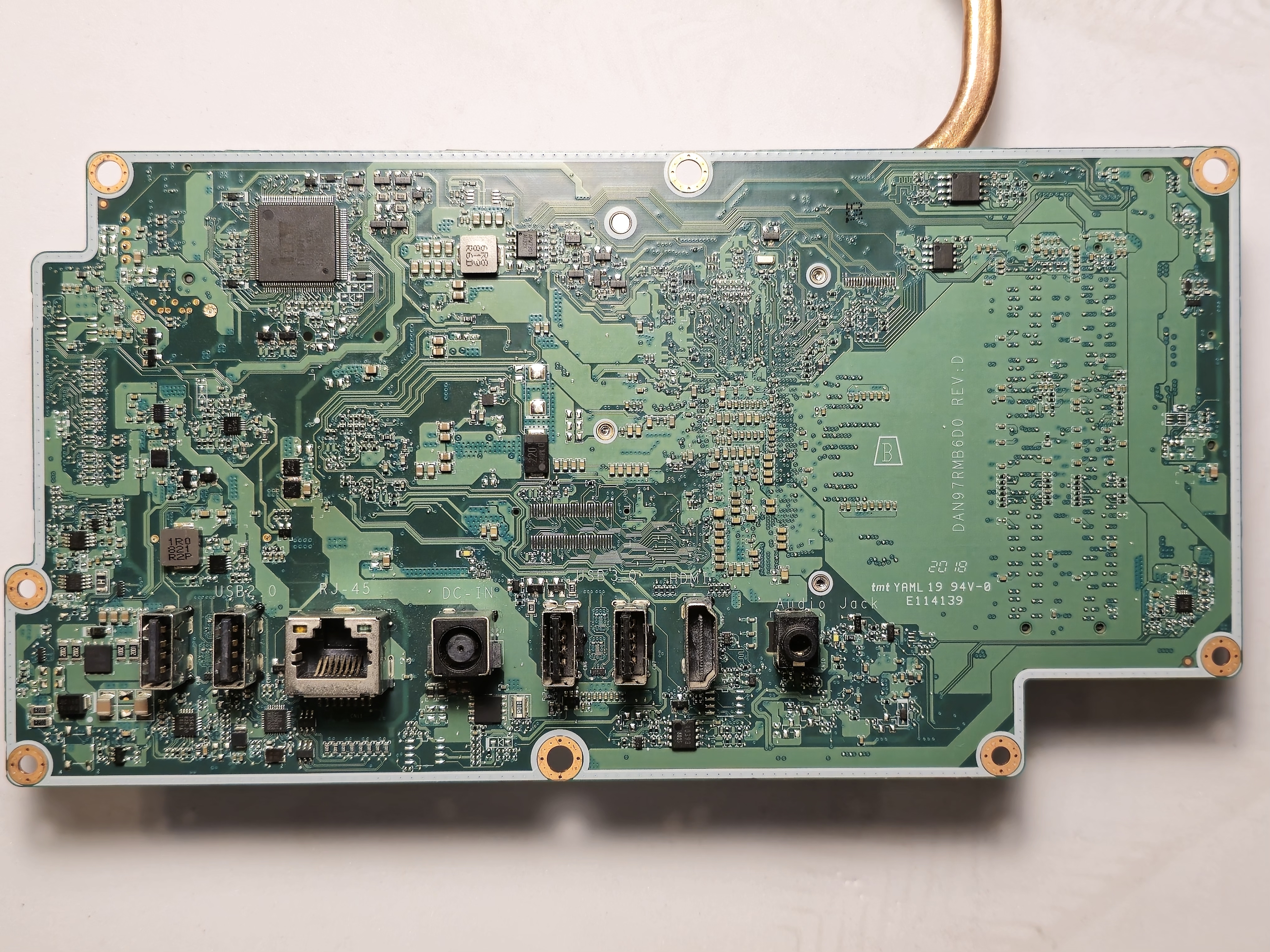

    Hey, I had a problem with this all in one hp. While I was using it, the computer suddenly shut down and wouldn't turn on again. There is no light flashing, only the power light in the back is on. I did various tests and various measurements, and I found that mosfet measures 19v at the input but does not output 5v. I changed it, but nothing.I checked if there was voltage coming to the bios but nothing is coming. What else should I check? Unfortunately I can't find any wiring diagram
    DAN97RMB6D0 REV D
    • 20682

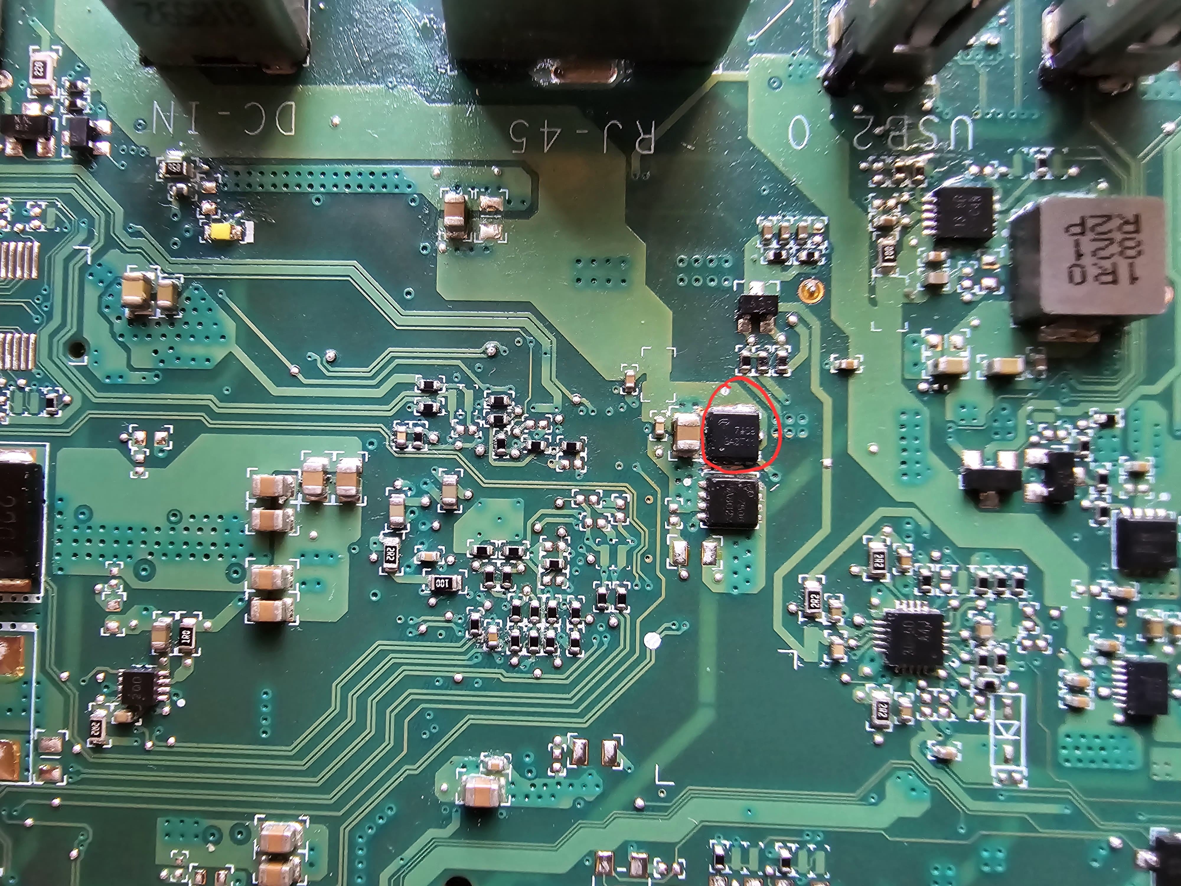

    You circled a mosfet. Are you sure its the right way around, where does pin one go
      Sorry, I wrote it wrong...😴
      In any case, the position of the mosfet is correct. It seems backwards but I also took a photo of the old one

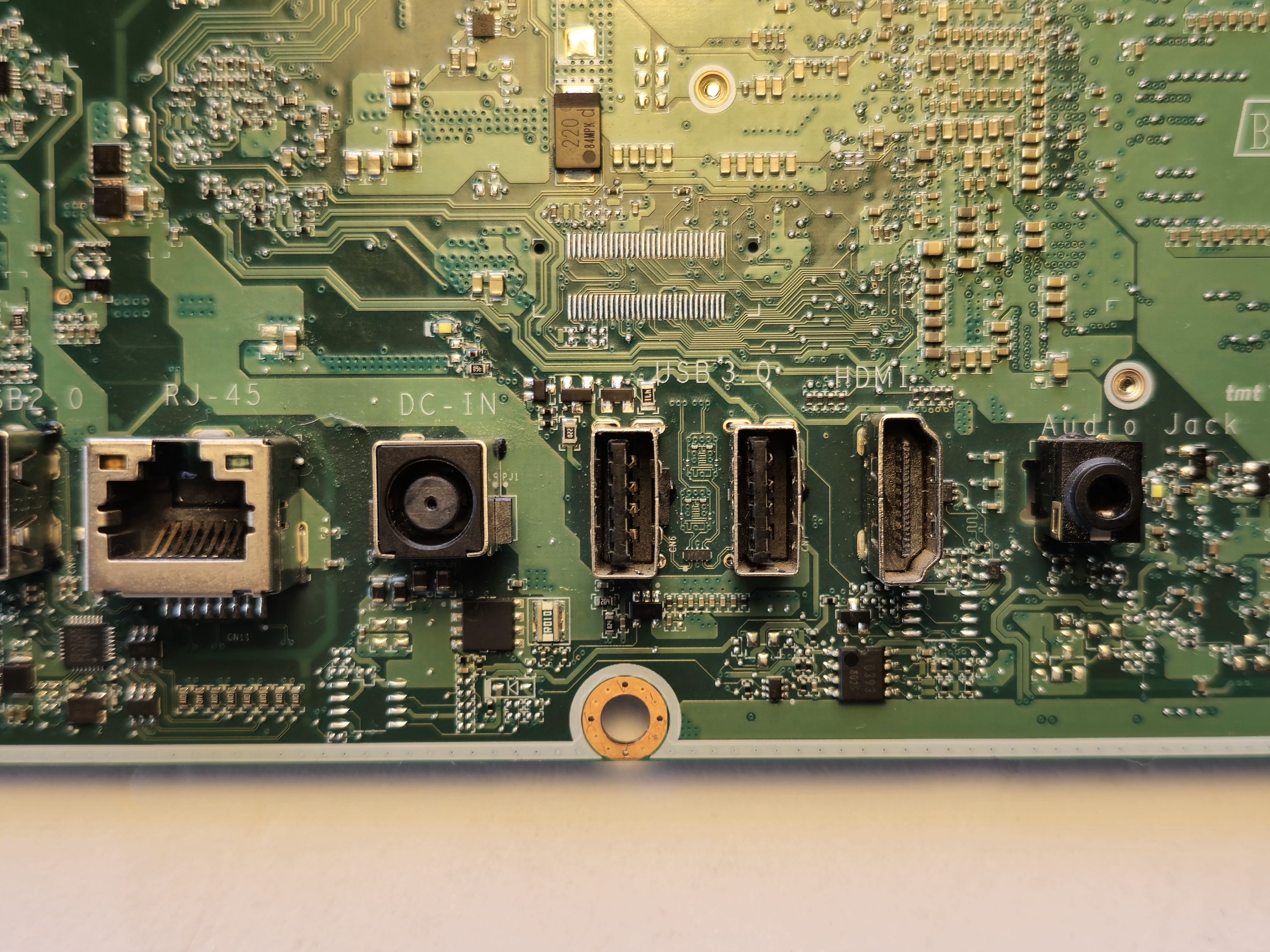

                    What should I remove? These are the USB 3.0

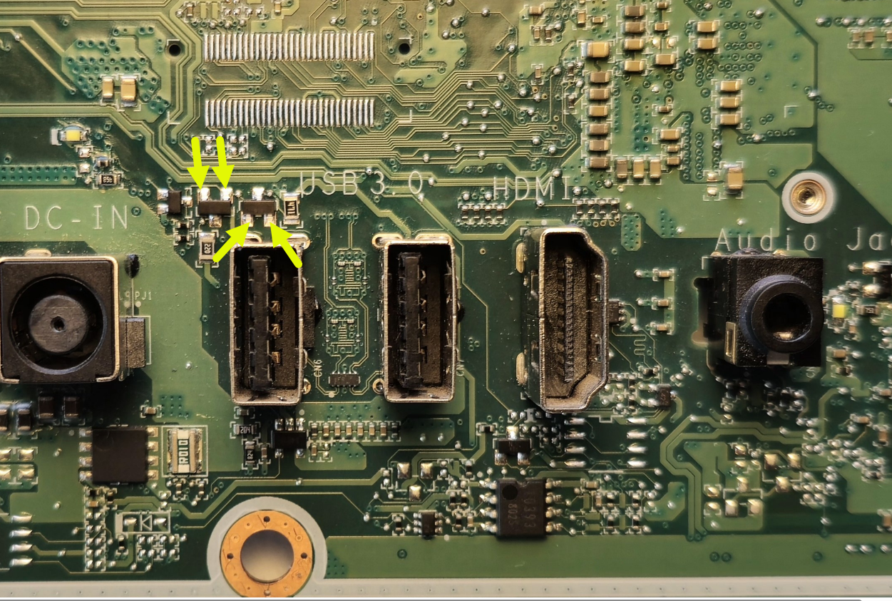

                        See attached. Suspecting these are the onboard ESD diodes. Remove all power. Meter in resistance mode. Place one meter probe to ground - use the single pin on the same 3 legged part in the attachment. That is, often, the single leg goes to ground while the other 2 legs are used to protect the data lines from an ESD (surge) event.
                        Place other meter probe onto any of the yellow arrow legs. Do you see a resistance like you have posted in your earlier posts? If yes, then this 3 legged ESD part may be defective and should be fluxed and removed. After the part is removed, test the resistance to ground again of the USB pins like before. Has the resistance improved? Post each measurement.
                        As noted earlier, the PCH (CPU) contains the USB host controller. It is possible that the PCH is defective which will make this a no fix case. However, have seen many times where just these ESD devices and/or USB load switches cause the logic board to not boot. These ESD devices are under $0.10 USD each.
