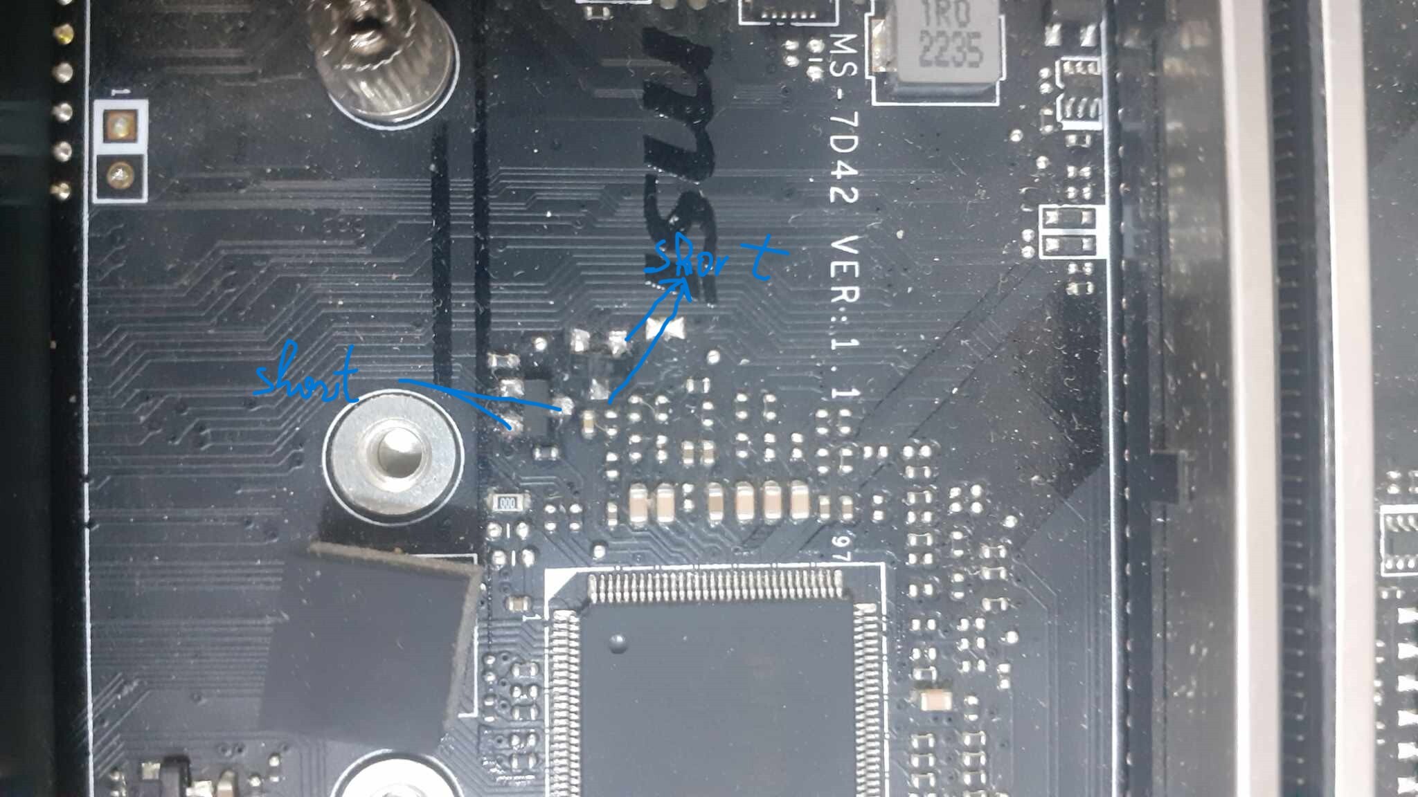

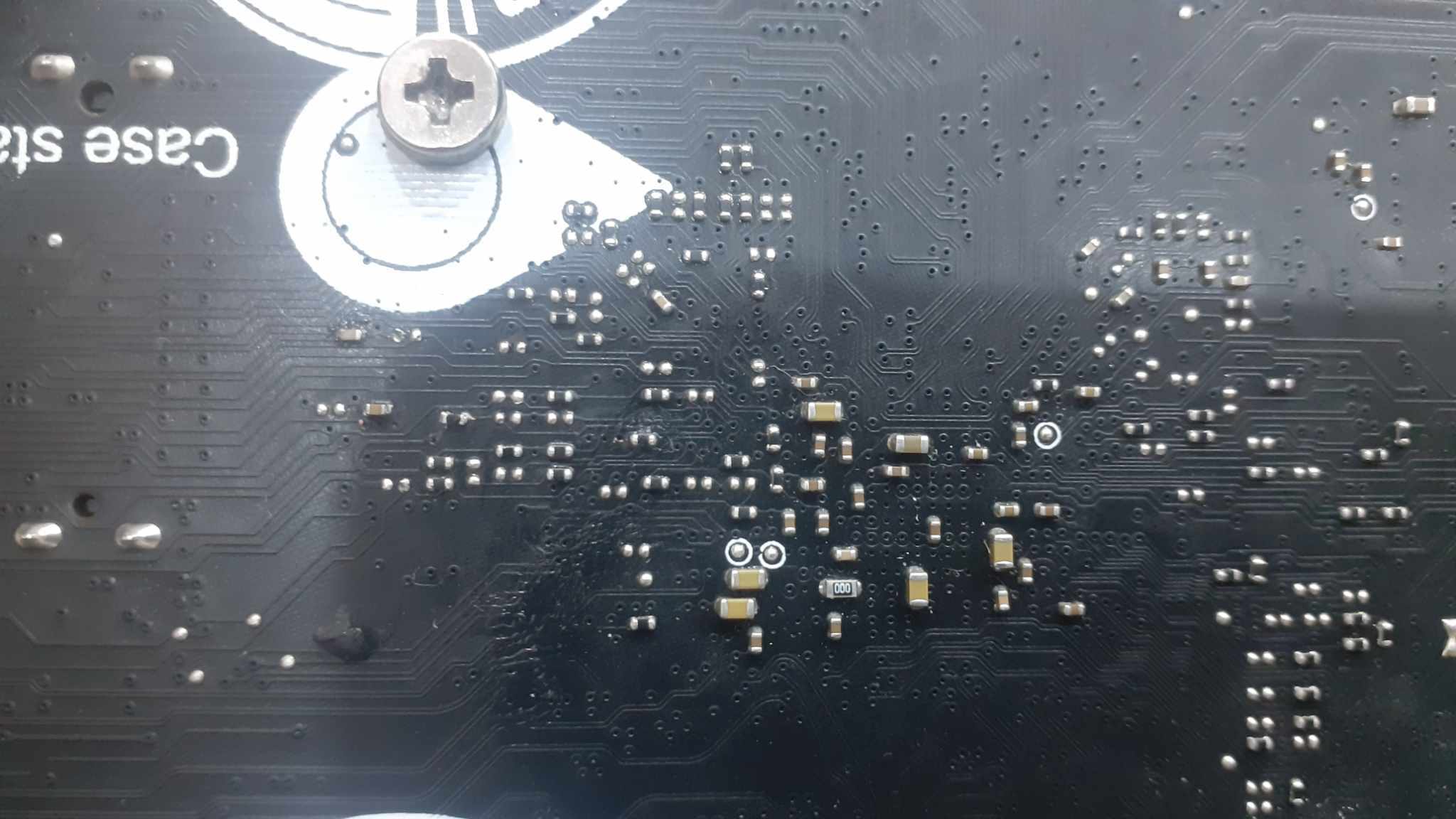

    the problem start when the client broke some capacitors and resistors in Back of the motherboard​ under PCH
    i put them back but
    same thing

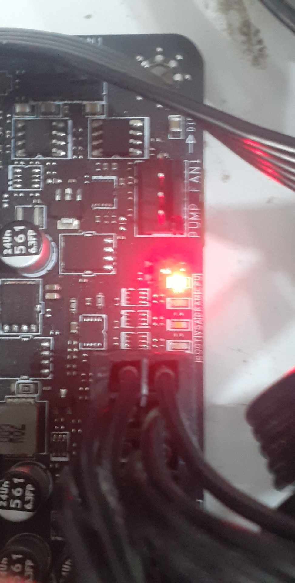

    motherboard power on with no display after press the pwr button power on with dram led and restart and power on again with red cpu led
    cpu vcor looks good no short and cpu heat up but after second restart not heating
    i found 2 shorted transistor near to KBC but i doubt if that normal short or not (connected to AGND AND AMDSIC)

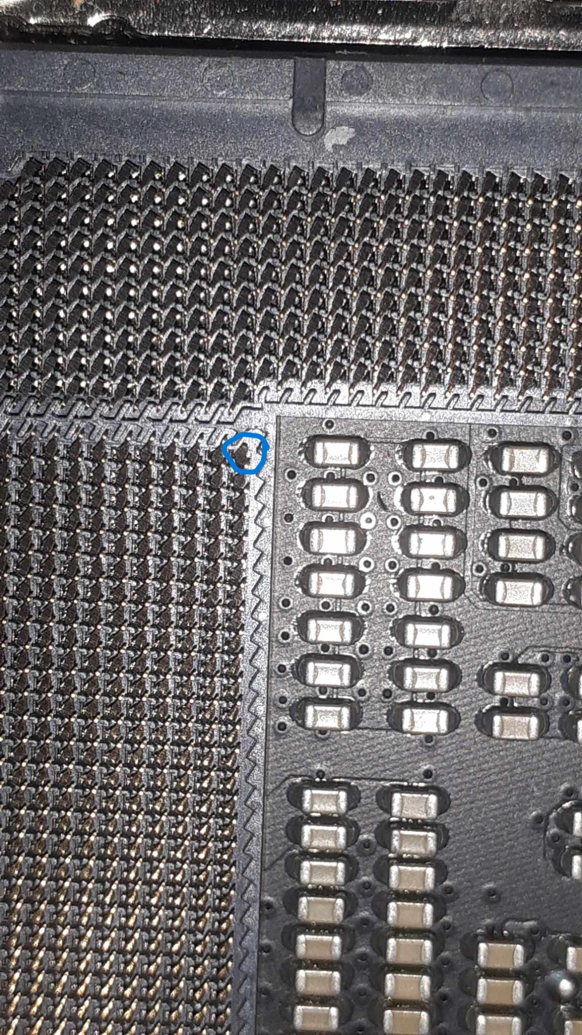

      i found one broken pin may this pin make this problem ?
      • DynaxSC
        • Apr 2021
        • 475
        • Poland

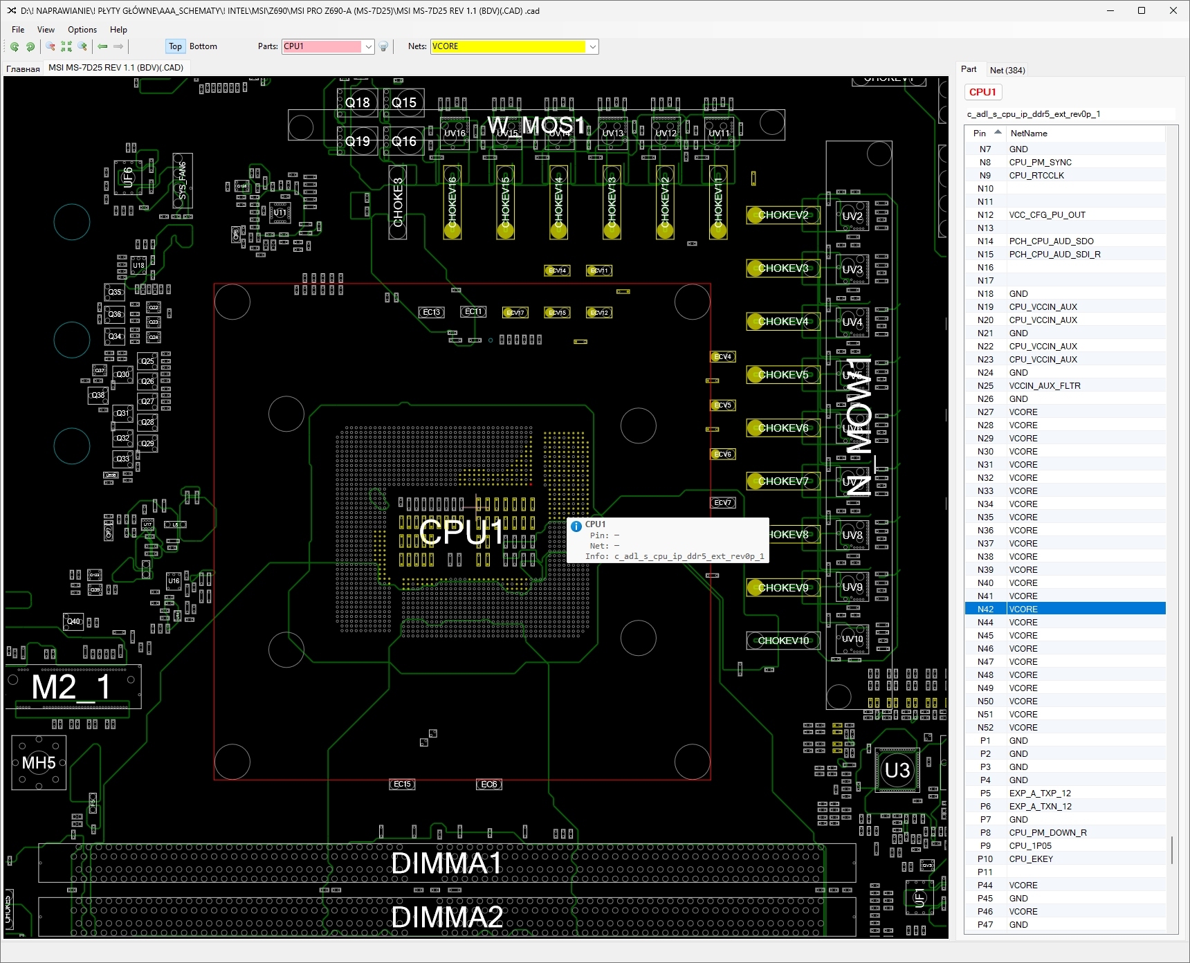

        Unfortunately not, this is a VCORE pin, one of many, and is redundant.
        See attached printscreen from a different MSI Z690 board, all LGA 1700 pinouts are the same.
