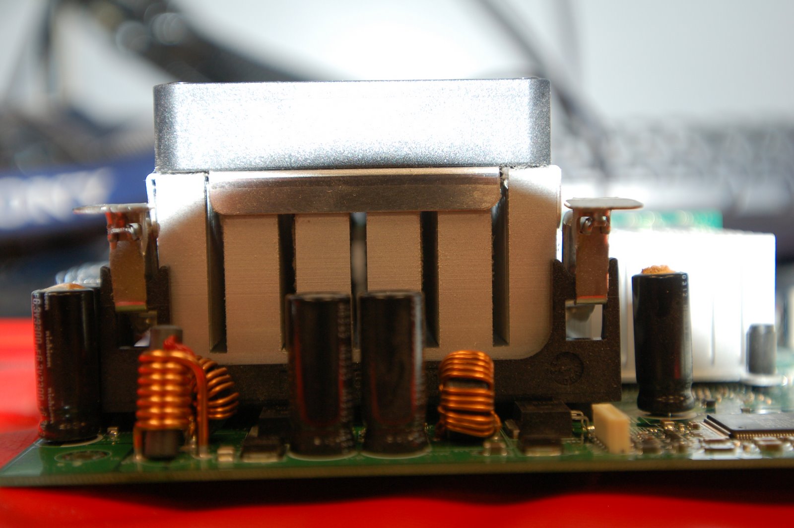

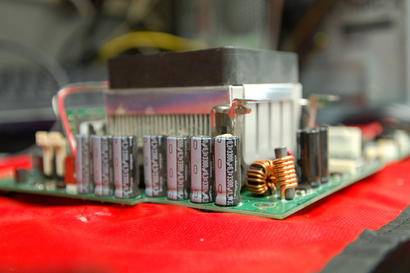

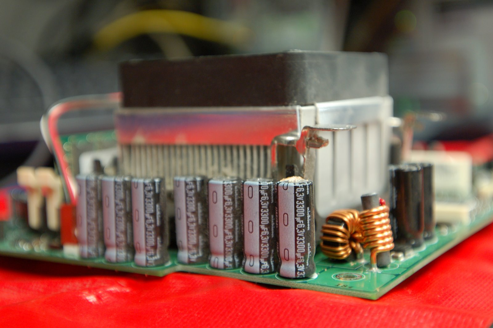

    Caps on a Sony PCV-W30 Motherboard.
    I have a motherboard out of a Sony PCV-W30 All In One pc that has some bad caps. I am trying to figure out the most efficient and quickest way of replacing them either myself or sending the mobo in.
    I'm also trying to figure out if I need to replace all of the caps. Only 3 are showing physical signs of being bad.
    Please take a look at the pics.
    Thank you.

    Re: Caps on a Sony PCV-W30 Motherboard.
    yes it would be recommended to replace all those Nichicon HM
    damn...that board has a good amount of capacitance with all them 3300s....
