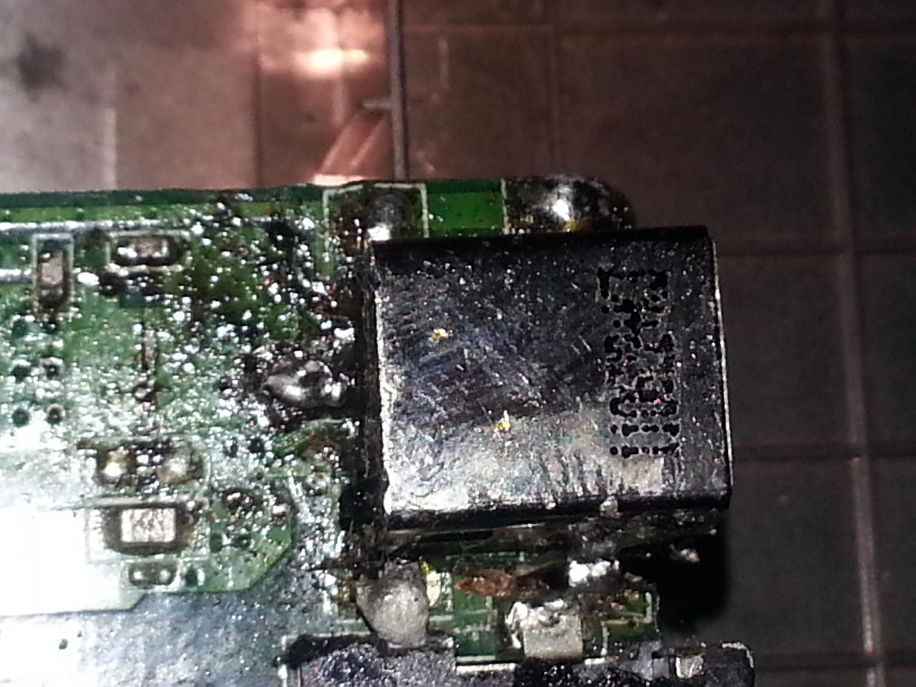

    I recently bought an Asus X54H laptop that had a damaged power port (common problem with this laptop) thinking that I would replace the power port and it would work fine.
    After taking it apart I noticed that there had already been an attempted repair on the power port and that it was a horrible job at that.
    Anyhow by putting a little pressure on the power port I was able to get power to the motherboard but it was still not powering up, no lights, nothing.
    I then noticed that there was a blown cap.

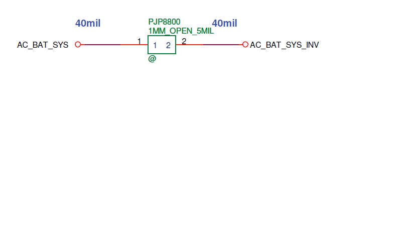

    Hoping to find out what it was I googled "PJP8800" and found the schematics for another Asus laptop motherboard where PJP8800 was under the charger section.
    Not really understanding block diagrams and schematics this does not really mean a whole lot to me but obviously it is to do with the battery charging circuit.
    So would this cap prevent the laptop from powering up or is there likely to be something else wrong with the mobo? what it is the cap that needs replacing?

    Re: Asus X54H No power, blown cap!
    someone use blowtorch to solder the connector...
    • luke10050
      • Mar 2013
      • 209
      judging by the top side... i really think its pretty close to unrepairable, theres solder everywhere! unless you have an awful lot of time and the schematics im not sure it'll work
      and i think that was more like a clothes iron... i mean even with a blowtorch you wouldnt do that bad...
