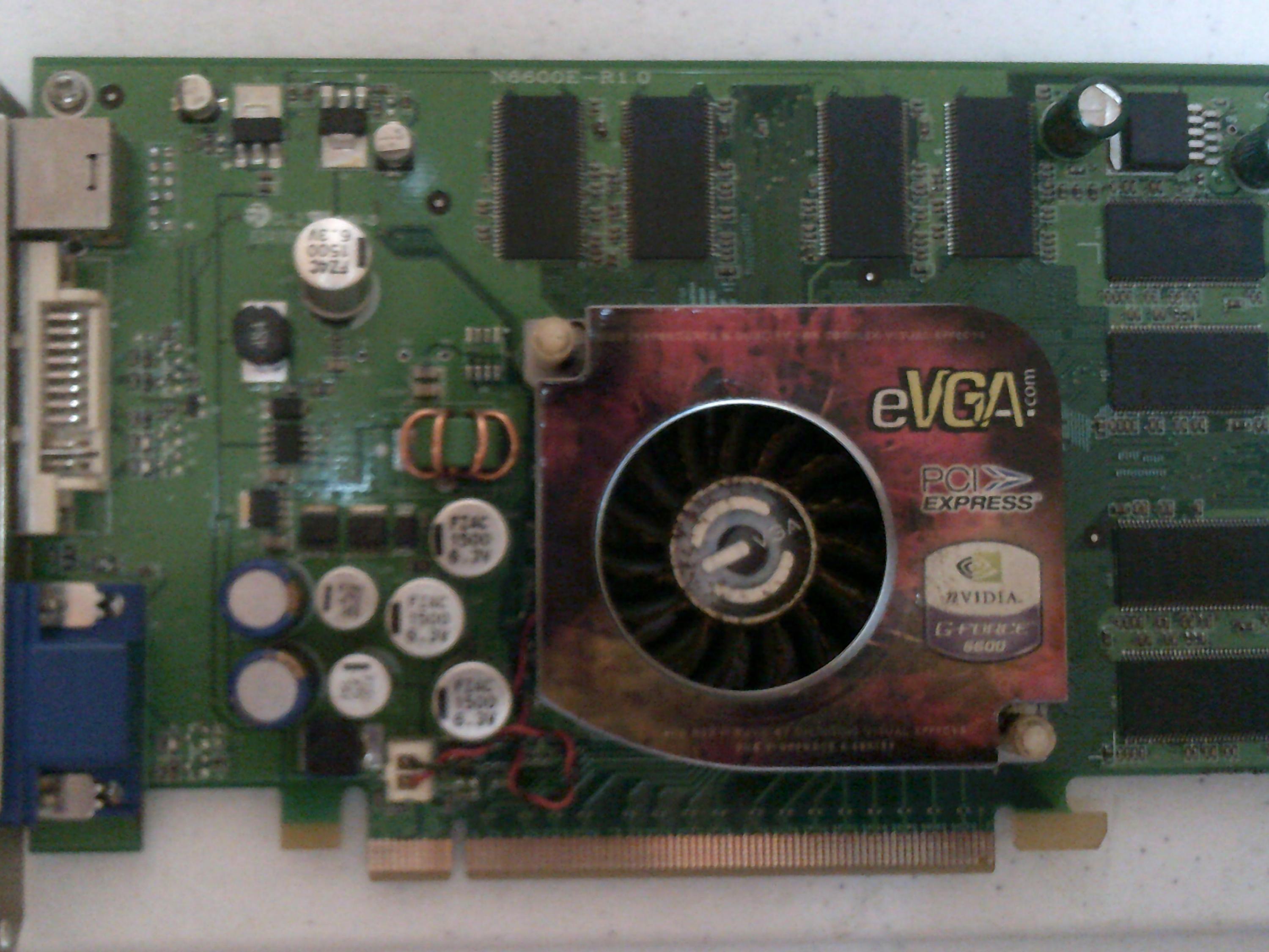

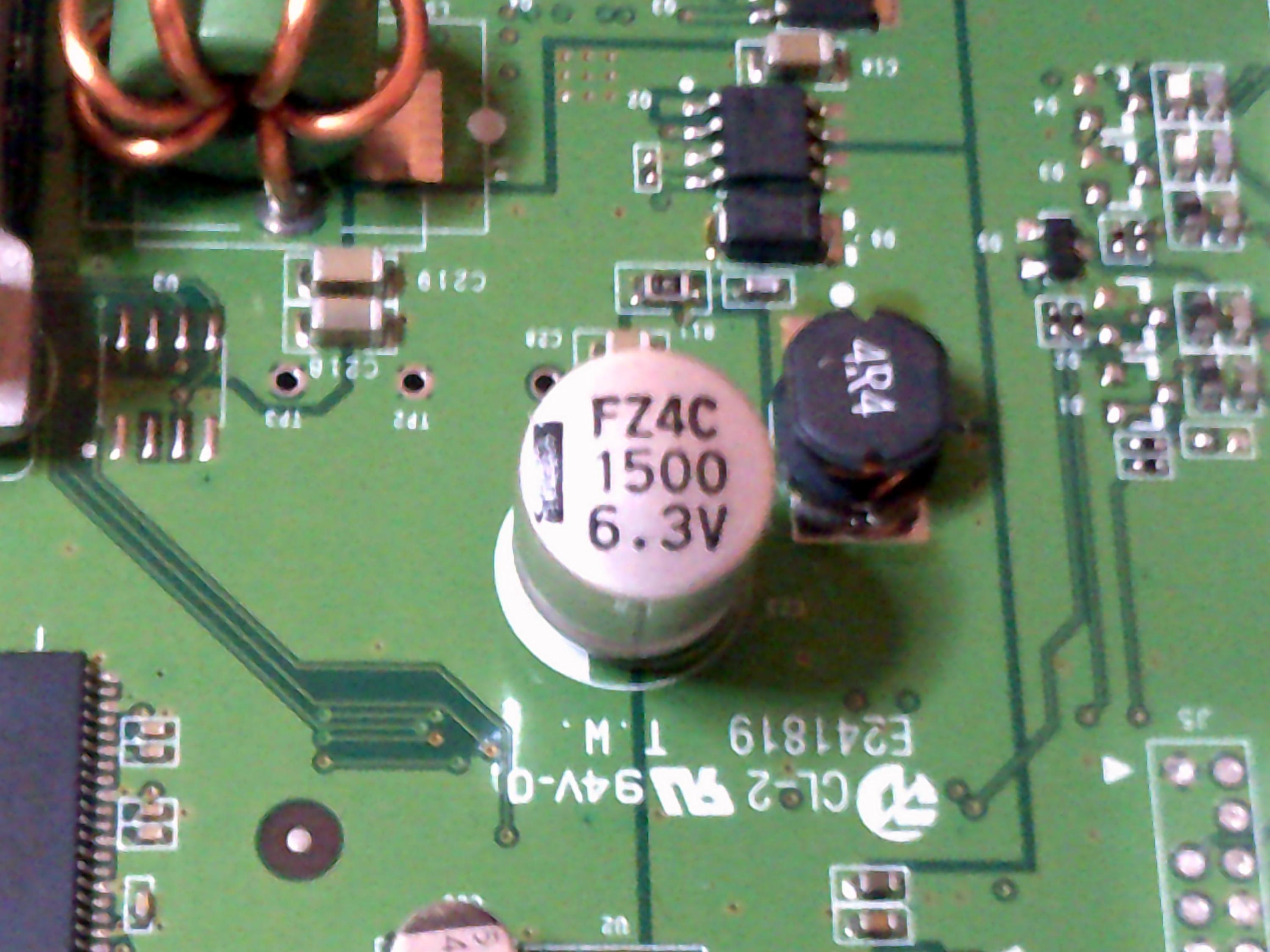

    Computer worked fine last night, today it seems to boot but no image.
    Blown capacitor(see pics) is:
    FZ4C 1500uf 6.3v.
    There are 4 like this. I guess ill replace them all.
    I know the FZ are crap, I just want to verify my choices below are ok and does it pay to spend more on the united chem con?

    Re: GeForce 6600 pci express capacitor replacement help
    After reading another thread https://www.badcaps.net/forum/showth...6600+capacitor
    Mariushm says in post 5. Nichicon HN series is fine.
    http://www.digikey.com/product-detai...MPD-ND/2428111
      Yes those should work well. Clean out the fan and heatsink too, re apply thermal paste
        I replaced the 4 caps this afternoon and so far so good. I also cleaned fan and heat sink that was 80% blocked.
          god FZ is a plague on video cards
            Wow, looks like those FZs have no vents either!
            You replaced just those large 4 FZs? Better replaced the small FZs too. And if those blue caps with gold stripes are OST or GSC - get rid of them too.
              Those blue ones with the gold stripes look like Lelon or Skywell
                I plan on replacing the other caps. Had to make sure it would still work first.
                  I've seen that before on an almost new GF 210. They hadn't failed, but I recapped the card anyway, and then I reverse-polarised the vent-less sacons on a 12V PSU.
                    FZ4C 1500uf 6.3v.
                    Over here, I have a Ruby in 1500uF 6.3V!
                    And even a lousy KZG is better than that POS!
                      What brand are they? Now I'm curious
