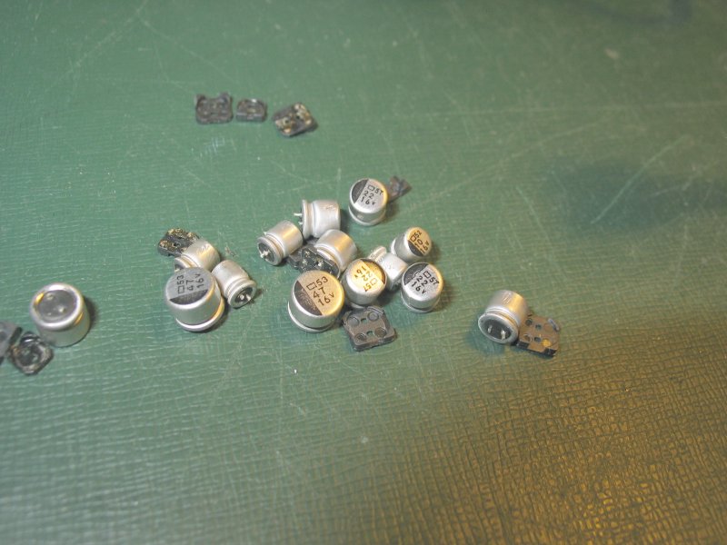

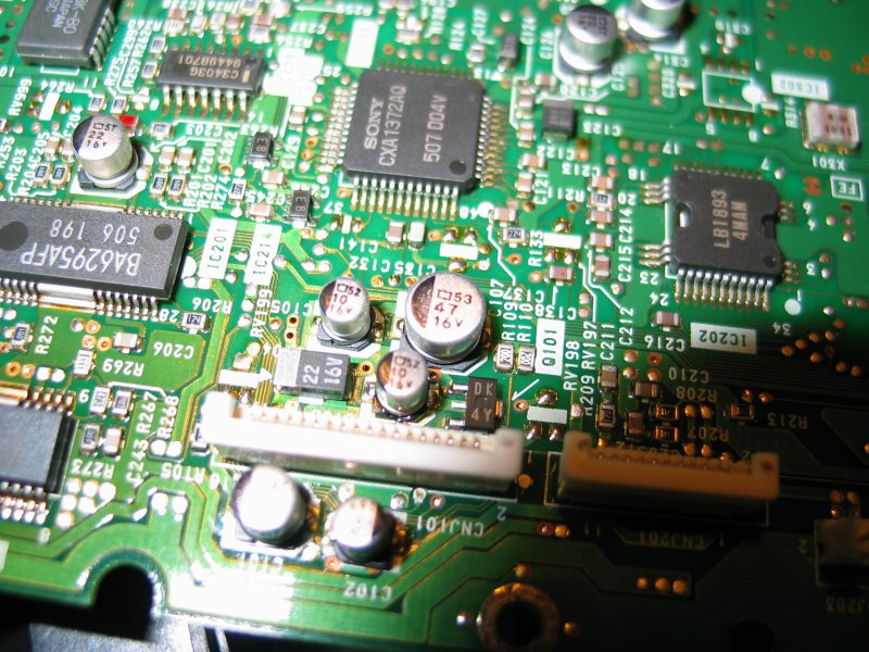

    Sony CDU55S - 2x SCSI CD-ROM drive (1995)
    This drive was laying around here for maybe two years as it was not working - not able to read a CD. The lens was cleaned and it didn't help so I thought that the laser is probably bad.
    There were some SMD caps on the board so - just being curious - I took my ESR meter and checked one - bad! Checked more of them and every single one was bad - the best one had ESR of 30ohms but most of them over 300 (completely open). So I replaced them all - 3x 47uF, 6x 22uF, 4x 10uF and 1x 4.7uF - by using caps from dead boards (checking ESR - they were all good). Unable to find a 4.7uF cap anywhere, replaced it with 10uF.
    After putting back together, it works fine, reads CDs without any problems
    Original caps - nothing visibly bad:

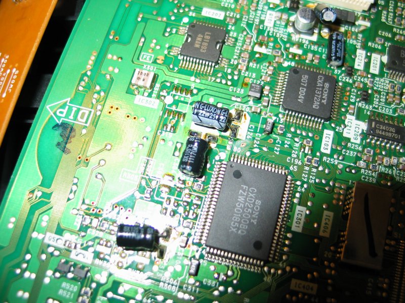

    That's Nippon Chemicon:

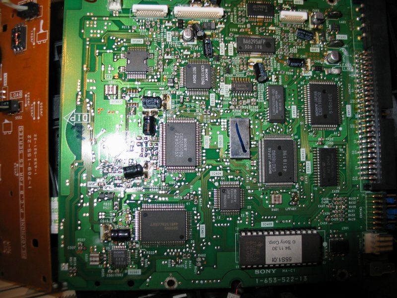

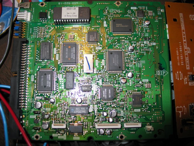

    Recapped:
    Good G-Luxons from dead PC Chips board:
    Bad chemicons:
