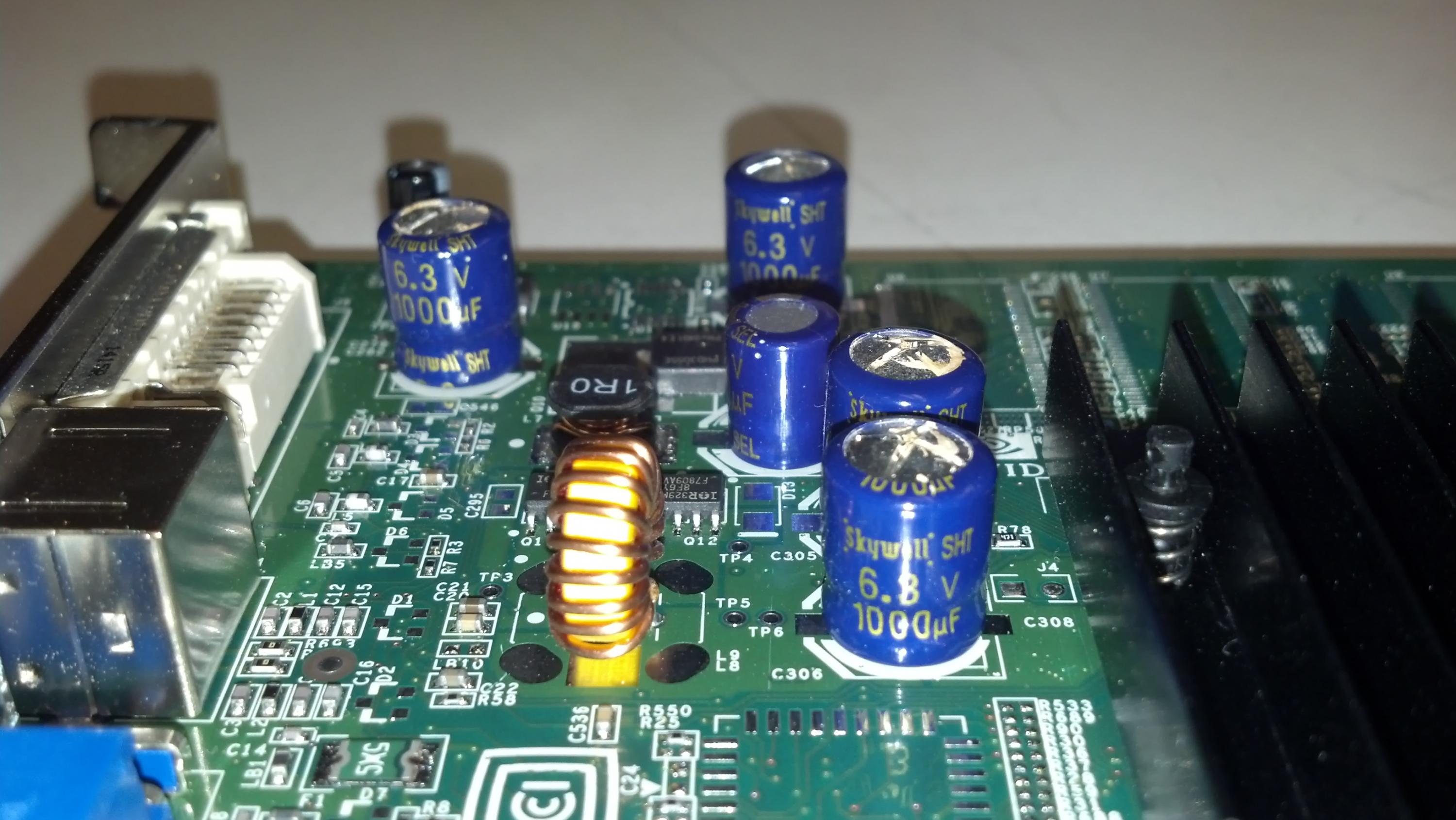

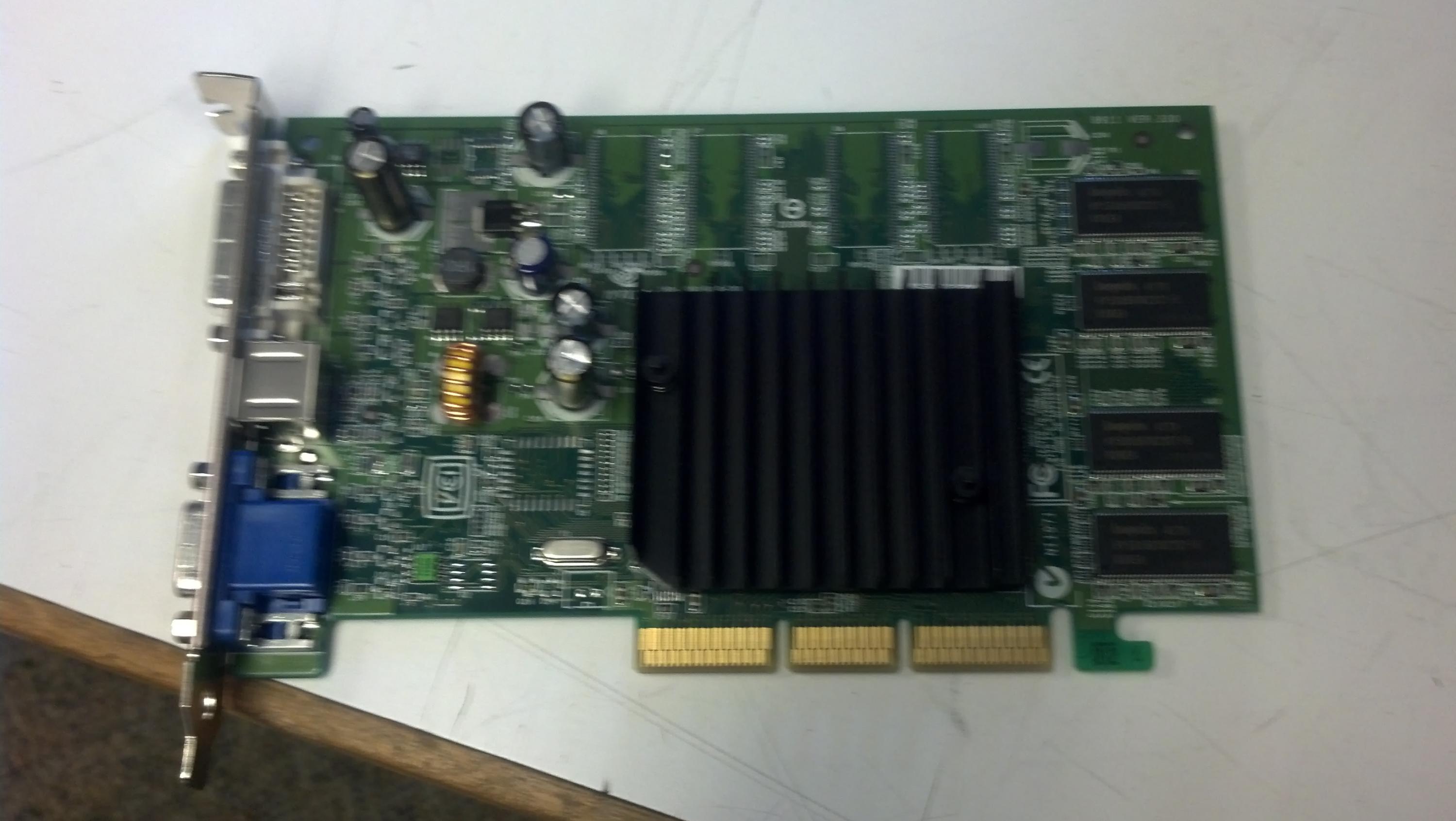

    Just had some dead Skywell caps. Replacements are Panny FL and nichicon VR

    Re: Fixed FX 5200
    Nich VR are 85*C General purpose caps, and are totally unsuitable for use on a GPU.

      Re: Fixed FX 5200
      Really? The one on the back there is a nichicon VR and it came stock on the card so I figured it would be alright to use them. Are they unsuitable because of ESR or because they are rated at 85C?

        Re: Fixed FX 5200
        Both. If the manufacturer used an 85*C cap, they should be shot.

          Re: Fixed FX 5200
          Hmmm, okay. Yeah that 100uF 10V cap in the back that came on the card is an 85C VR

            Re: Fixed FX 5200
            It's probably in a non-critical area, which is why they got away with it, but the skywells are in the VRM, where GP caps are not suitable.

              Re: Fixed FX 5200
              GP? I'll probably replace the 2 with some more Panny FL's

                              Re: Fixed FX 5200
                              It's a pretty low power card...shouldn't get too hot
