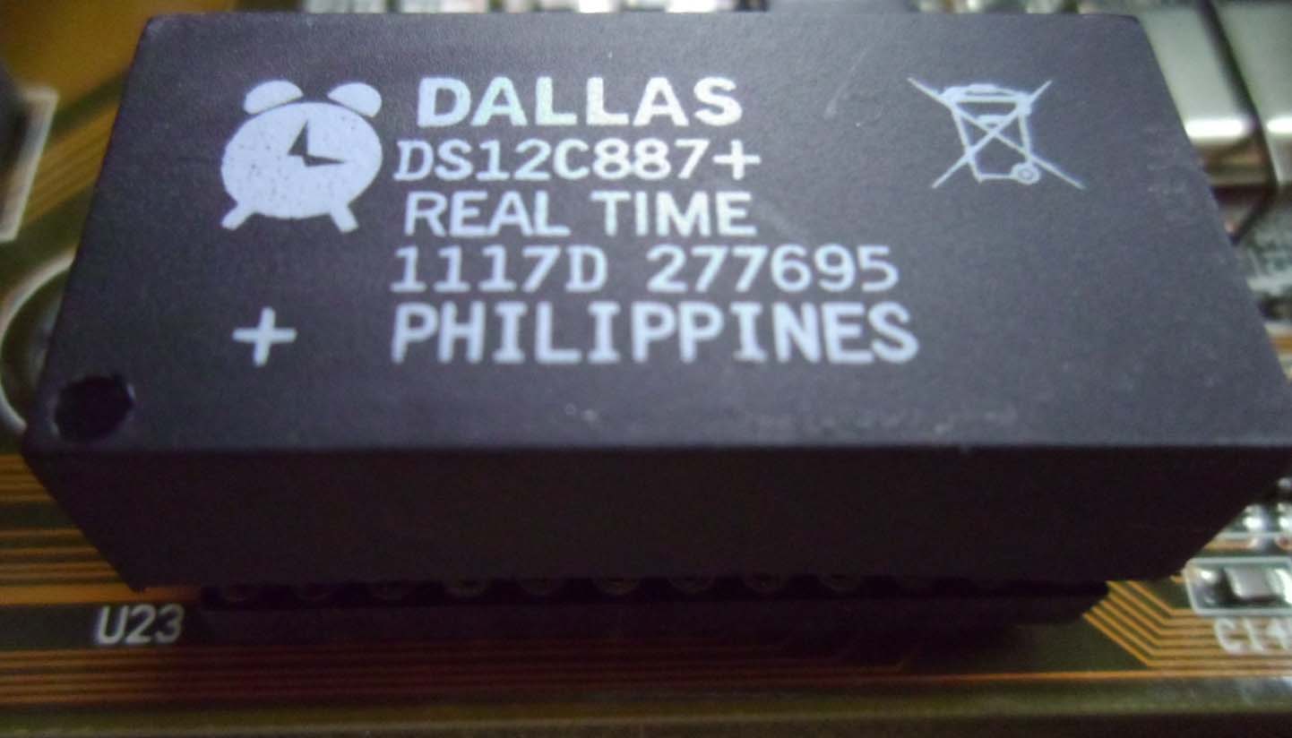

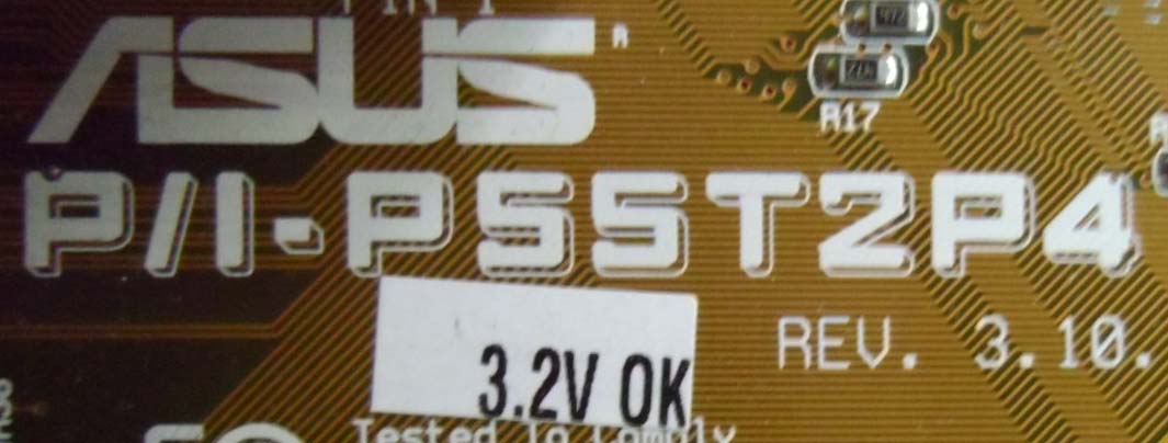

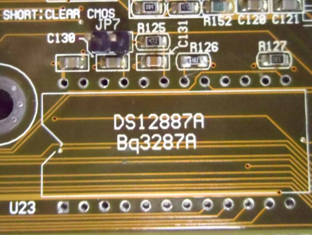

    The CMOS module finally expired on my trusty late-model-of-the-series P55T2P4, running a K6/3-400 at stock settings
    Late model board identified by the 3.2V OK sticker showing it could run a power hungry K6-233

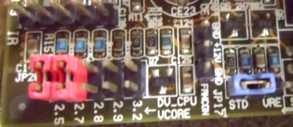

    Re: Asus have been skimping on components for quite a while
    If anyone's interested, jumpers for undocumented 2.2V setting

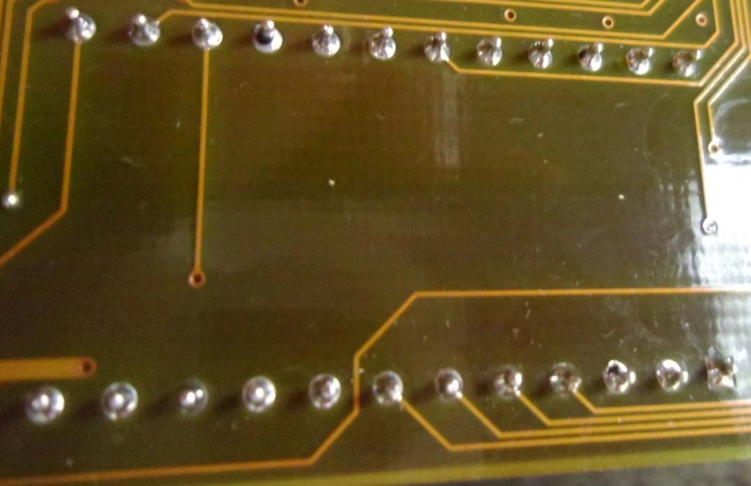

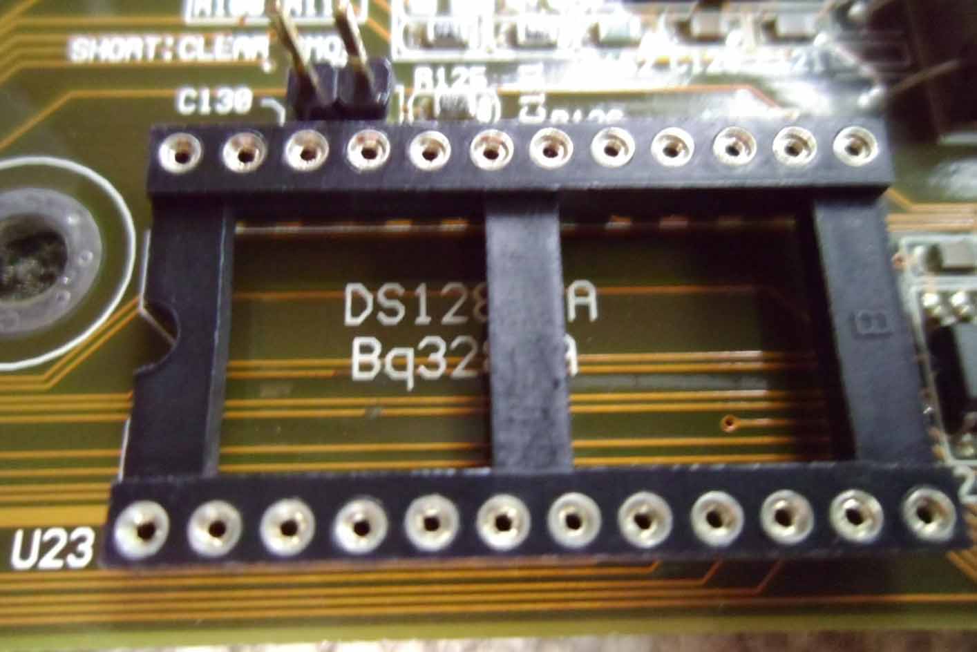

      Should be easy to swap the CMOS module, except Asus skimped by soldering it direct to the board, must have saved a couple of cents by omitting a socket for it
        Module removed and socket added, should have been factory fitted

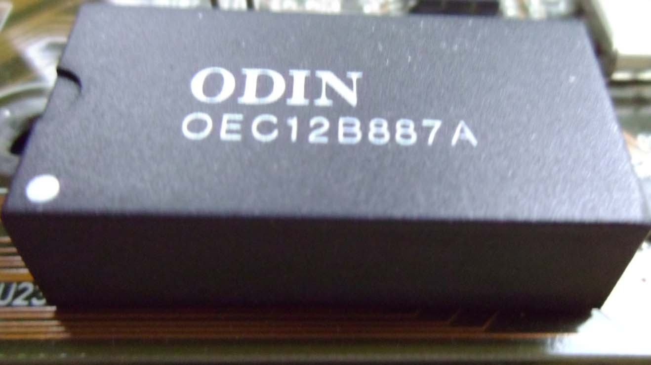

          New CMOS module, ready for another decade
            Had the exact same board, i went for the ghetto fix, that is cutting apart the module, soldering 2 wires and attaching a regular CR2032 battery holder.
                I was wondering about cutting the module open as well, to attach an external battery. I have an old dual socket8 board that I took out of production because the RTC battery was dead and desoldering was not going very well (could not get solder out of any of the holes...)
                I guess by this point a dual socket8 board is kind of long in the tooth, and time for the whole board to be put in the trash...
