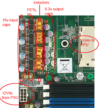

                              So I have noticed you guys mention input/ouput related caps. How do I tell the difference? Also, how would I go about finding info on what each cap is responsible for? (i.e. caps nearest the CPU are most likely Vcore responsible, etc.)

                                Re: Intel D975XBX Cap Mod Questions
                                Zorlac. I am guessing re. input and output comments. This usually refers to the caps involved with the VRM ( responsible for the regulated CPU voltage). The output caps are typically close to the CPU and the VRM input caps are are seperated from them by the switching MOSFETS and the inductors (with a few turns of thick copper wire).
                                The picture above shows the six output caps in the foregroundand the four input caps behind.
                                  Not my prettiest piece of Photoshop work, but I hope it helps
