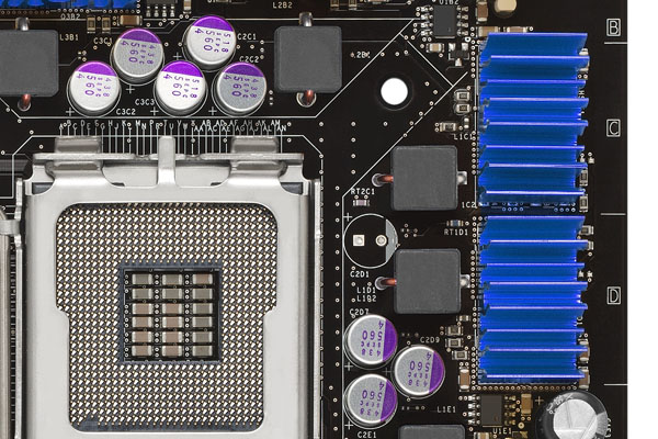

                I just mapped out my board with all the capacitors I will need:
                6.3V, 220uF
                6.3V, 3300uF
                10V, 470uF
                10V, 1000uF
                16V, 470uF
                16V, 1200uF
                25V, 22uF
                25V, 33uF
                25V, 100uF
                25V, 220uF
                And the final three are a little weird...no clue what they are. They have the following markings:
                611 561 2.5V
                612 561 2.5V
                613 561 2.5V

                      611 561 2.5V
                      612 561 2.5V
                      613 561 2.5V
                      these are polymers. but do you only have 3?
                      this revision has 8 sanyo oscon sepc. one of the best for vcore.

                            Oh, and the pic above...I have 9 caps total. The first marking is on the motherboard. The second set of markings are on the cap:
                            C2D1 = 612 561 2.5V
                            C2D7 = 613 561 2.5V
                            C2D9 = 613 561 2.5V
                            C2E1 = 611 561 2.5V
                            C2C1 = 613 561 2.5V
                            C2C2 = 612 561 2.5V
                            C3C1 = 613 561 2.5V
                            C3C2 = 612 561 2.5V
                            C3C3 = 613 561 2.5V
                            That pic is from a rev 302.

                              Re: Intel D975XBX Cap Mod Questions
                              manufacturer and series
                              like Sanyo WG
                              Nichicon HM(M)
                              Nichicon VR(M)
                              Chemicon KZG
                              forget these
                              6.3V, 220uF
                              25V, 22uF
                              25V, 33uF
                              25V, 100uF
                              25V, 220uF
                              are your caps around the cpu :
                              silver and purple or
                              silver and red
                              or yellow

                                Silver and Red around the CPU.
                                Also, what do you mean by forget those caps? Which caps (Voltage/uF) would I use in their place? Or are you saying I do not need them at all....or leave them as is (do not remove them)?
                                • willawake
                                  Super Modulator
                                  • Nov 2003
                                  • 8457
                                  • Greece
                                  dont remove any cap. i say forget those cos they are so small.
                                  the red silver are probably fujitsu
                                  https://www.badcaps.net/forum/showthread.php?t=1744
                                  they have a good spec
