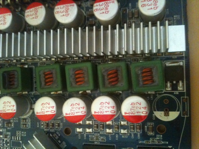

    Hi can anyone can help me find the cap rating from this POINT OF VIEW VGA

    top are 330/16
    bottom 1200/4
    the code is first and second numbers are value.3rd is number of zeros to follow.
    voltage is the bottom line.

      Thanks !!!!
