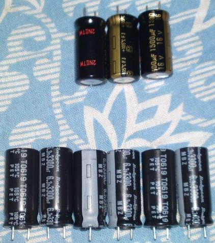

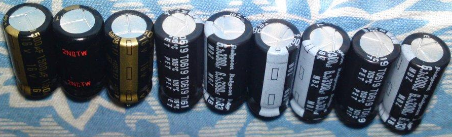

                                  ok managed to acquire the replacements and snap sum pics of em. can someone take a look at them to see if they are genuine? if they are not, i might just file a police report against the shop for selling fakes and get my money back... keke~

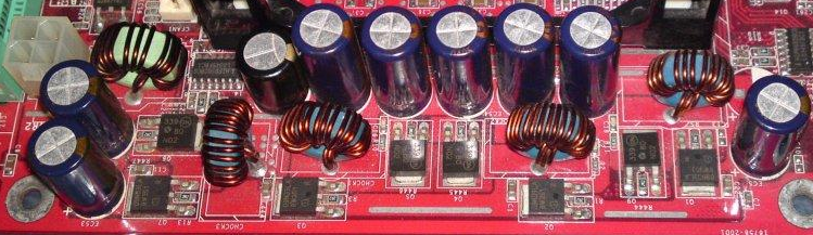

                                  also, got a screenshot of my board with the busted ost rlx on it. notice the ones at the vrm out have got a wrinkled top? i presume if its wrinkled it means the electrolyte inside dried up?
                                  however, the ones at the vrm in still look okay.
                                  also, i wonder if i can replace the 1500uF 6.3V FJ with the 3300uF 6.3V rubicon mbz? cuz i cant find any other capacitor with the right specs and dimensions to match the 1500uF 6.3V FJ.
                                  P.S. i decided that everything must go. even the good 1500uF 6.3v FJ. it prolly must have been tortured being bunched together with the ost rlx crapacitors and prolly doesnt have much life left in it even tho it looks fine.
                                    Re: Recommend: Caps for board recap of msi 875p-neo2
                                    They look genuine. They could be very good fakes but it doesn't look like it to me.

                                        In any case, though, your caps look like they are real, but are old stock. The rubycons have an 06 date code, and the pannies have red print on the datecodes. I don't know when they stopped doing that, but it was a while ago.
