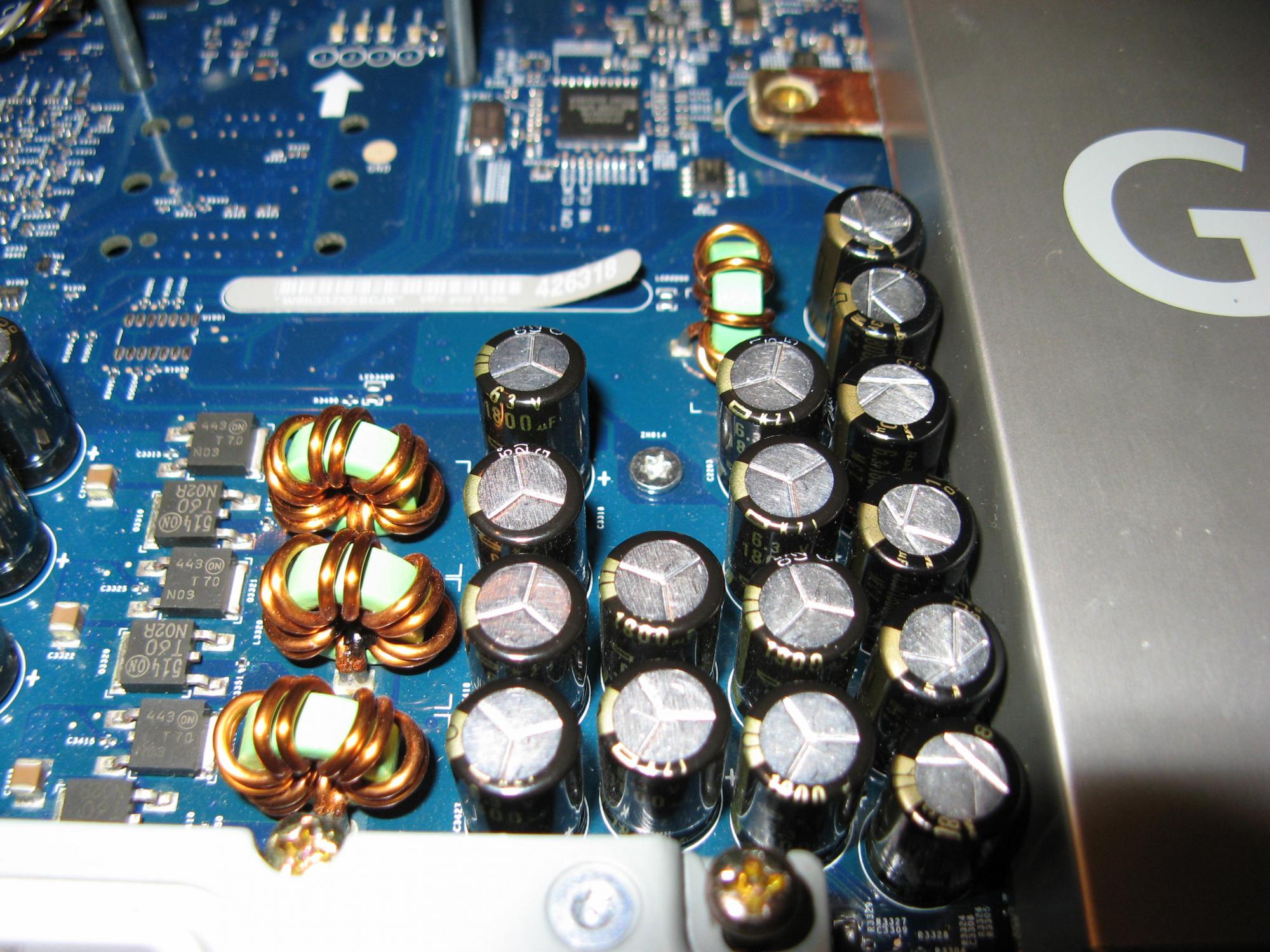

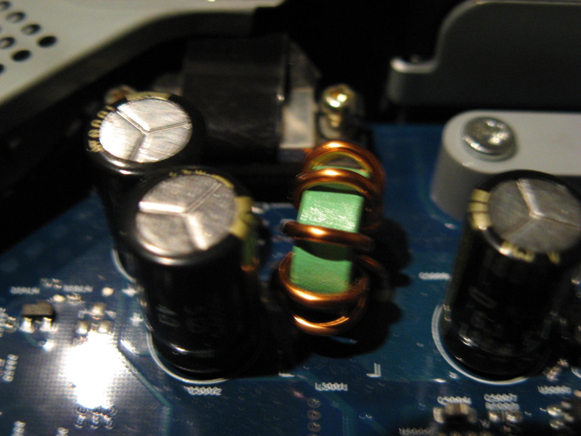

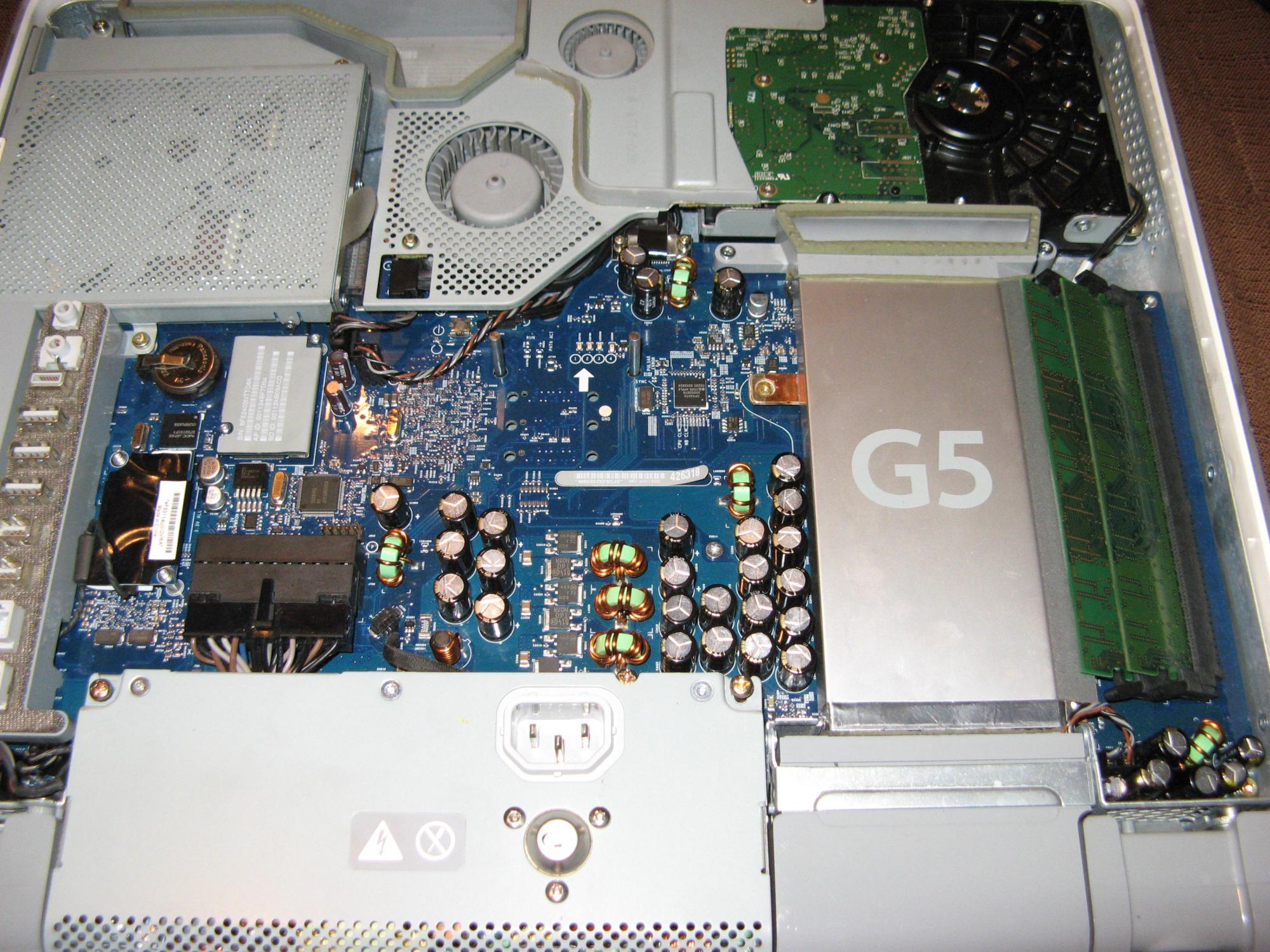

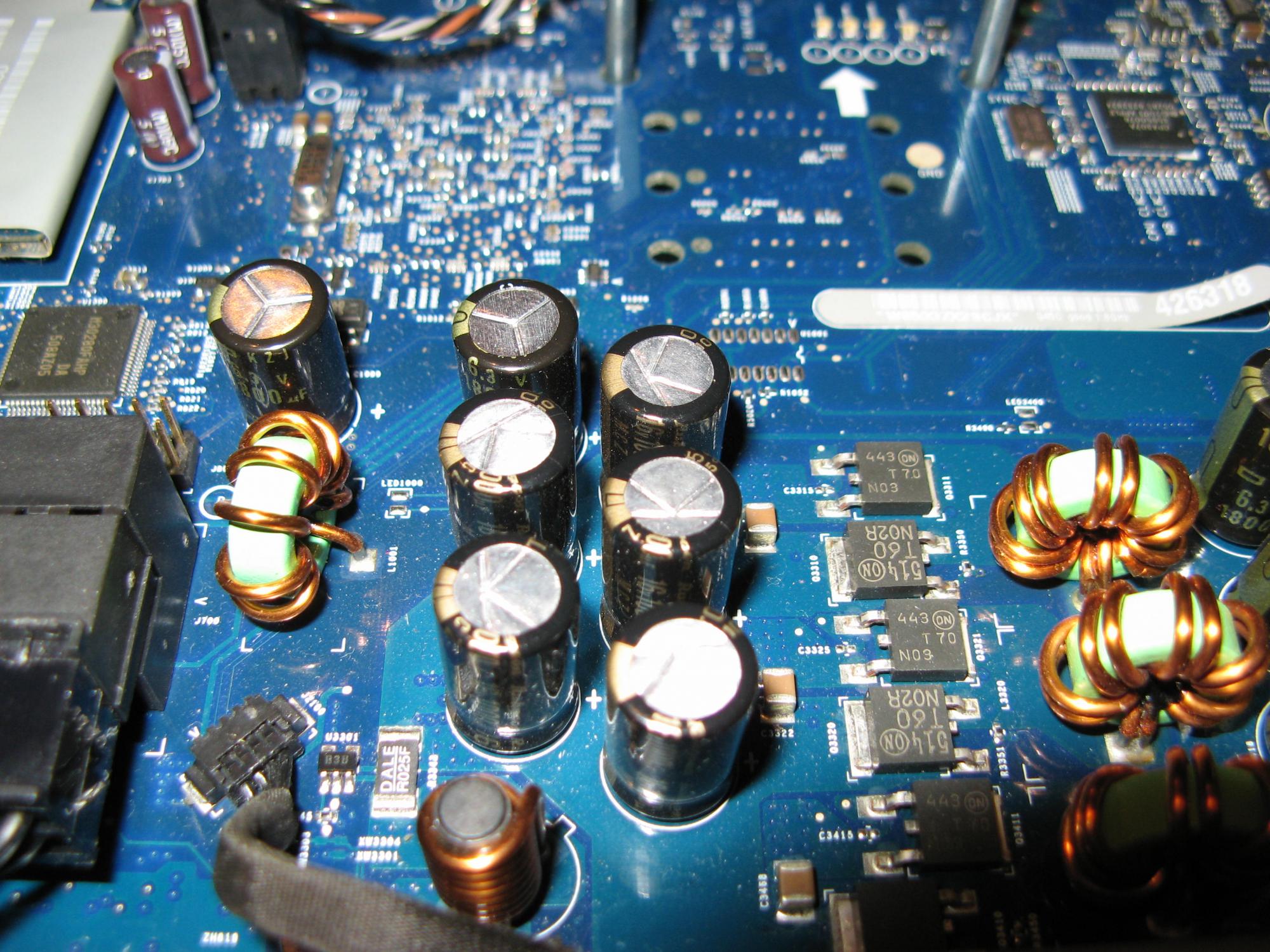

    I purchased a dead iMac G5 17. The iMac powered up, but there was no video on the screen. I replaced the bulged caps on the logic board. I'm only getting the first and second green LED light on the logic board. The monitor only show a grey screen now. No beep or apple image during start up.
    Should all the other caps(non bulged) be replaced?

    Yes. What caps did you use? Brand? Series? Which ones?
    Picture perhaps?

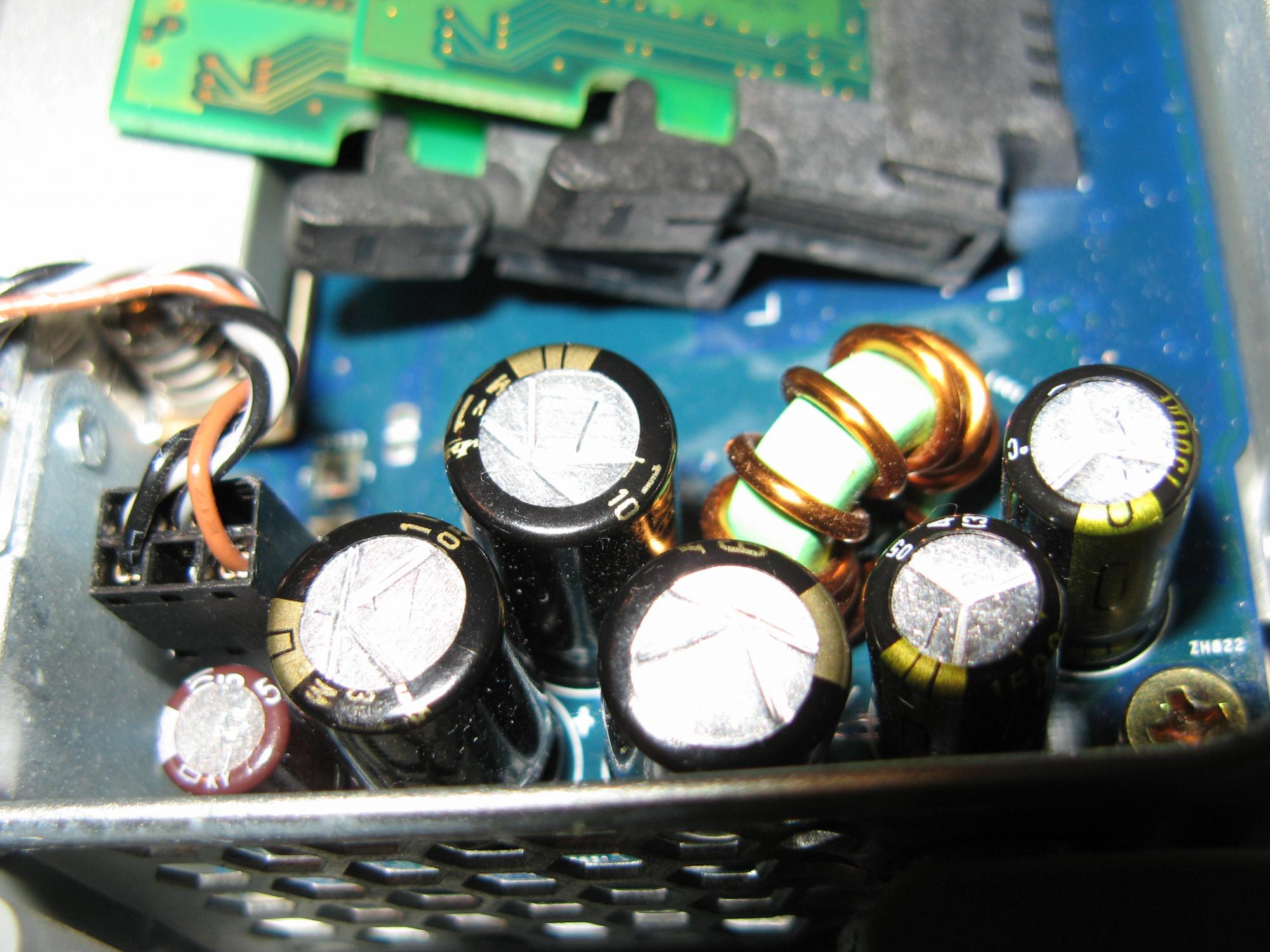

      The replaced 1800 caps are Rubycon MCZ. They are the ones near the G5 air duct and the caps near the ram boards.

        Cap choice is fine. Perhaps finishing all of them may correct the problem. The video at least showing something is an improvement, yes?
        Did you get the chime at all when you first got the unit?
        Be sure to clean out that air duct and the lower fan. The fins get clogged easily.
        Check the PSU for blown caps while you're there.

          Replacing the some of the caps got me video. A good sign. I can not recall, but I think the iMac did have a chime initially. That is why I'm lost . I did have to scrap away some of the logic board green coating, as I did burn one of the pad for a cap .
          I will order more caps to replace the remainder caps.

            I trimmed the leads short, so that they did not ground out. Would the issue be in the caps near the ram boards?
            The three fans have been clean and the plastic air duct have been wiped down.

              By my statement "Be sure to clean out that air duct and the lower fan." I meant that long air channel that has the big G5 on it. That's the heatsink for the GPU/CPU and the fins inside it get clogged Badly. Make sure they're clear. The lower fan blows thru that.
              The KZJ series has problems with heat, so replacement of the rest of the caps may just fix the problem.
              Again, check and recap the PSU.
