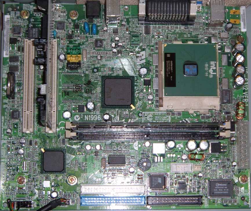

    This system worked fine for several years and suddenly went dead some time ago. I think it might have been because all the dust that collected around the PSU may have caused it to overheat. The PSU was right next to the CPU and it's fan was the only active cooling device in the whole system.
    The capacitors seem fine except the one on the lower right (see pict) is buldging very slightly. I'm not sure if it's significant to indicate a problem.
      Newbie : i dont think you need a post card to diagnose that problem. Are those all chhsi caps? chhsi = crap. I have recapped several msi boards with chhsi caps. What are the caps around the cpu? are they Jackcon? crap also
      caps can either fail visibly, like they might bulge or even leak at the top or bottom. They can also fail inside and it is not seen from their appearance that they have failed.
      If the board is dead most probably one or more of the caps have failed open, preventing power from reaching part of the board. In the unlikely event that something else is the problem. a board with even one bulging chhsi cap is not a good idea to use.
      you must replace all capacitors 1000uf and above which looks to be about 10, that is not too many at all. MSI boards are also easy to work with so it is a nice beginners board. After replacing the caps the board will be perfect.
      what is the card in pci1, is it your NIC? it is full of stone caps. crap also. prolly be ok though. If you require another NIC sometime in the future i recommend intel pro100mt or pro1000mt or otherwise 3com. cheap and great.
      whilst temperature is a factor in capacitor life and dust on heatsinks raises temperature, even in a well ventilated case chhsi caps on motherboards will fail early.

        Bullitt : what is your camera, it is taking nice macro
          I would go one further.
          Being MSI, they will almost all be Chhsi caps.
          Certainly replace them all - even the 470uF ones. I have seen a number of these fail, whether visibly or measured with an ESR meter.
          Chhsi are rock bottom crapcaps so don't fool around. Even if they haven't failed yet, you can bet they will soon enough.

            I have one of these systems that has gone dead also. Have looked at the caps and they all look good. I have tried all the normal trouble shooting and the system wont power on at all. The cpu, memory and psu all work in another system, I even took the board out of the case and still no luck. I have been reading this forum for over a year and since this seems to be a good board for a novice to recap does anyone think this could be the problem? I have already removed 11 caps,
            4 Jackcon 2700uf 6.3v sz 018
            2 Chhsi 1500uf 10v WG (M)
            3 Chhsi 1000uf 6.3v HK (M) 0116
            2 Chhsi 470uf 16v HK (M)
            Is this board worth trying to recap?
            Also I noticed when I was removing the old caps that some of them seemed to be dried up, a brown powder came out of a couple of them. Is this normal?
              looks can deceive my friend. inside they are probably dried up crap.
              yeah i would recommend having a go at recapping it. if you dont get a boot after recapping let us know to assist further.

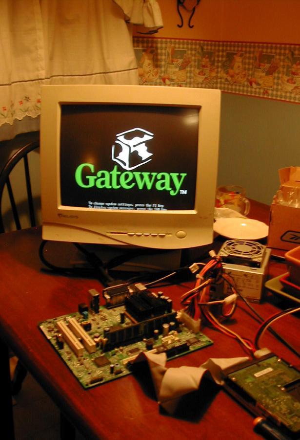

                Sorry it's taken me so long to reply.
                My camera is an old Sony Cybershot DSC-P50. It's only 2.1mega pixels but the optics are really good and the macro function works excellent.
                I just finished replacing the capacitors on the MS-6312 board tonight with Nichicom HE series from Digikey and the board works perfectly now.
