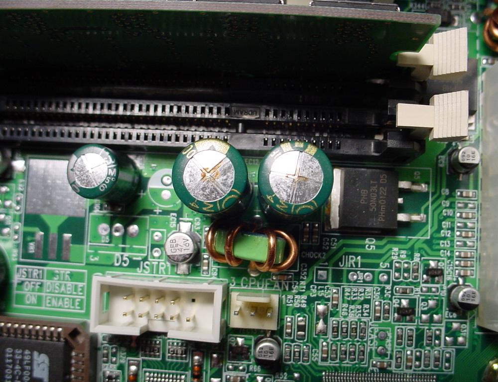

    This motherboard was pulled from a Gateway Flex system. The board is manufactured by MSI, model MS-6312. Of course the caps were fried.
    The caps were branded G-Luxon and Teyah.
    There were the following values:
    (4) 2700uF 6.3v
    (2) 1500uF 10v
    (3) 1000uF 10v
    I substituted the 2700uF caps with 2200uF caps, replacing the rest with their stock values, and the board runs perfectly.
    Thinking about buying that cow now?!?

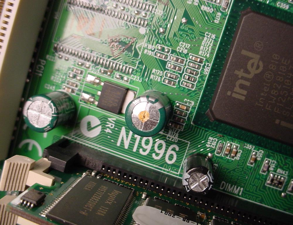

            I have one of these boards as well, but it has Jackcon 2700uf caps and Tayeh 1000uf caps and all "appear" ok. It was a warranty replacement board for a buddies Gateway after the 1st one died (probally caps). He damaged this one with a slip of a screwdriver tring to get the heatsink off to replace the 533 Celeron with a 700.
              same board, (there are 6 total) the two 10mm jackcon 1500uF 10v caps by the RAM slots are blown.
              cheap pos caps
                Just some FYI...

                    same board, in a Gateway Essentials 950c (FlexATX). The mb also is identified by Gateway's # 4000740.
                    The bulging caps (5 out of 16 at this point) are all Chhsi:
                    (3) 1000uF 6.3v
                    (2) 1500uF 10v
                    there are a line of 4 JackCon caps near the PSU (next to the CPU) which haven't bulged at all yet.
                    I had planned to replace the 5 bulged ones, then see if the computer started. If it did, I would have replaced the remaing ones. However, being in a small town, and only being an amateur trying to fix this one board, my biggest problem is in finding the replacement caps. No local store seems to have them, and ordering online means paying more in shipping and handling than for the caps themselves. I would still order online, except there is no way to know if replacing them will make the computer actually run or not.

                        But now that I have found this page and its great pictures of the boards, I am 99.9% sure the [2] green 1500uF caps are gone.
                        I should of saw them right off but I went to the power on/off switch next.

                                      I've been working on this board from a Gateway 300S, MSI 6312 motherboard and found these;
                                      The power supply is also bad as it won't start under load with just a single hard drive attached to it. I'll be replacing the caps this week as the mother board works with another supply but has interference lines in the video. I'm hoping the cap replacement cures the video interference.
