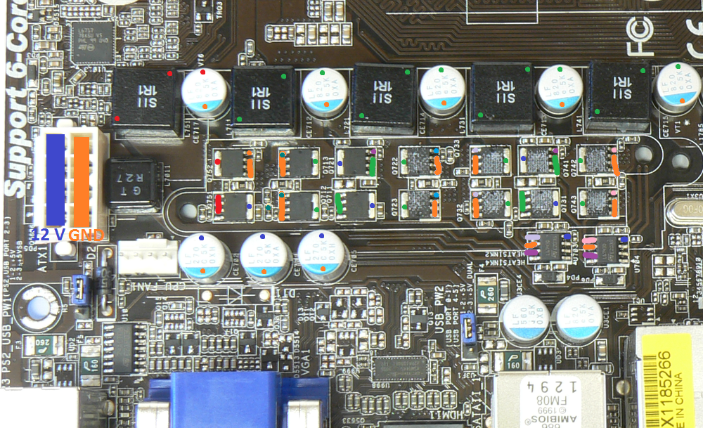

              Anyway, when I have already opened this: any of you guys have an idea about these "x+y" phase power design? For example, 880FX Extreme5 states 8+2, 880GXH/USB3 4+1.
              I have the 880GXH/USB3 just right here and I am totally not wise out of it. There really are 4 phases with 12 FETs at all. They share 4 caps and 4 coils. However, there is also fifth "phase" with independent cap, coil and two FETs which are connected to different electrodes of the 12 FETs in 4phase design.
              There are also what appears to be two PWM drivers what would really indicate two stand-alone "phase sets". Is that some aditional single-phase driving over the 4phase design?
              Will take photos, wanna me to indicate what is connected with what into the image?
              ADD// here it is, hopefully you will have something from it. The red ends somewhere in the black chip near socket, which is ST Micro L6176, SW managable controller. I guess connected with BIOS over I2C.
              The two PWMs are ST Micro L6743D.

                Re: ASRock Golden caps
                That has 4-phases for the CPU and one other [the red] is for the RAM.
                It's not too unusual to see a dedicated full VRM for RAM on server boards.
                - It's just shinny bells and whistles on a board with only 4 RAM slots though.
                Server boards that use it have far more than 4 RAM slots.
                "SW manageable controller" just means you can adjust voltage in the BIOS.
                Same ole shit - fancy name.

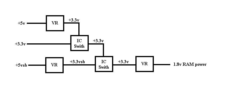

                            But, well, RAM has it's own VRM, I am sure of that. Although I haven't find it's driver (lol), there are two FETs sucking power from +5 V rail. Their output is connected with caps arround slots and with some RAM pins directly.
                            RAM usually has 2 or 3 power sources with IC's that select which by system state or load.
                            Those feed to another VR that steps it down to the actual RAM voltage.
                            I traced it out one board where it looked like this:
                            [Yeah, looks like over-kill to me too..]
