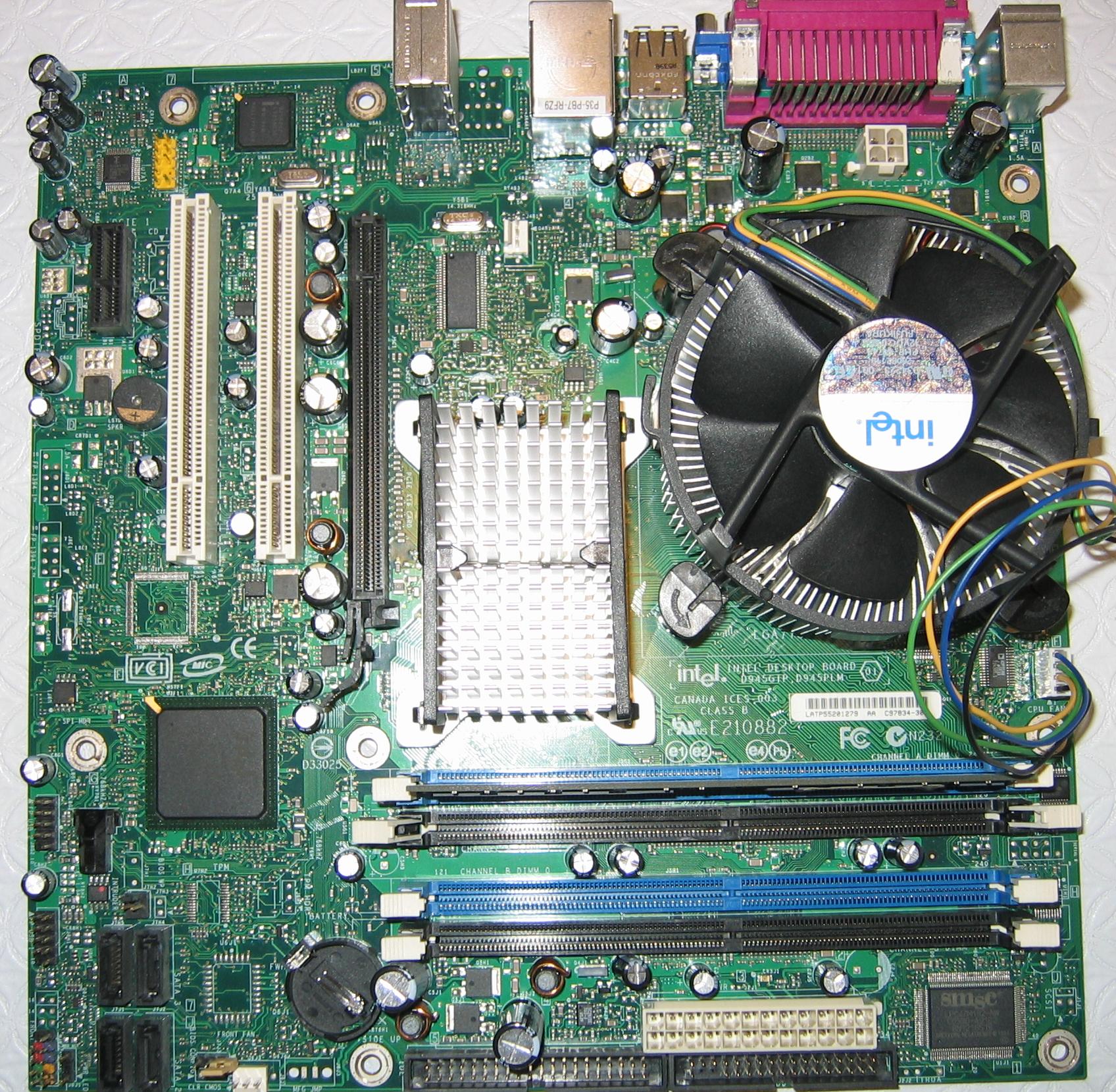

    My friend's Intel D945GTP socket 775 motherboard had the misfortune of being powered by an Antec SP-350 with Fuhjyuu caps. He said the power supply squealed for a couple of months, but the computer worked until recently.
    By the time I got it, it won't post or beep. When I measured the 5V SB rail, it was 11V DC. I opened up the power supply and found 2 bloated 1000uF 10V caps on the 5V SB rail. I also changed out the 22uF 50V and the squealing stopped.
    Now that the power supply works, but the D945GTP won't post.
    Symptoms
    - no beeps
    - no display
    - no POST
    Tests done so far
    Here is what I have tested so far and found. All resulted in no beeps and no POST.
    - all tests done below with the motherboard "bread boarded" (that is, out of the case sitting on a cardboard box)
    - installed new 3V battery (measures 3.33V DC on multimeter)
    - cleared CMOS battery by removing it for a hour and tried moving the clear CMOS jumper
    - tried to reflash BIOS by removing jumper and following Intel BIOS recovery instructions
    - all voltages on PSU are within spec
    - cannot turn the board on and off by shorting out the power sw pins (need to jumper green and black)
    - all voltages on the motherboard around the CPU, southbridge, and northbridge appear normal (1.3V around vcore, 1.8V DC around DIMM)
    - installed known working CPU
    - installed known working Kingston 512MB DDR2 memory
    - tried one DIMM in slot 1 and then slot 2 and get no beep
    - tried removing all DDR memory and I still get no beep
    - tried known working video adapter
    Questions
    1) Is the southbridge fried because I can't turn on board by shorting out the power sw pins?
    2) What parts of the motherboard might be fried due to the 11V DC on the 5V standby rail?

    Forgot to add that the 2 led post card I have shows nothing on the display other than the lights on for voltage (3.3, 5.0, and 12.0V DC).
