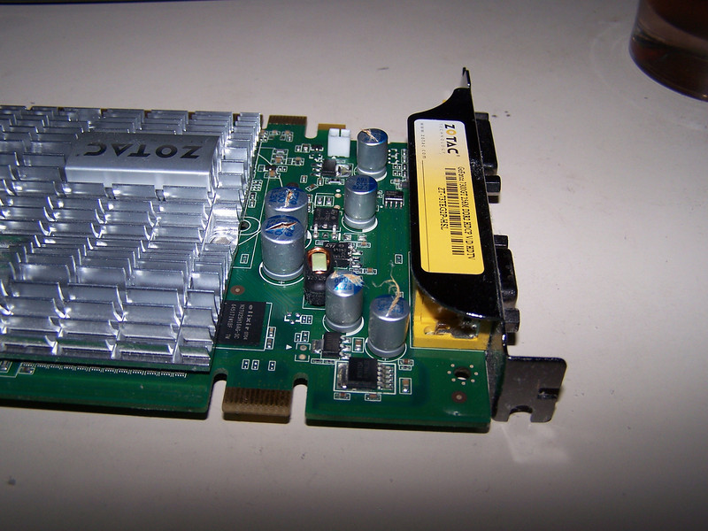

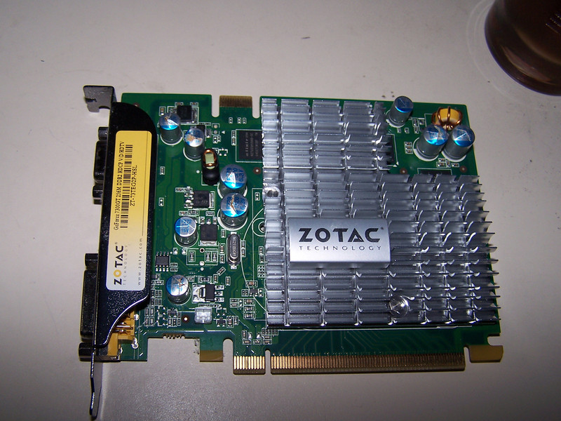

    Zotac 7300GT, 7 blown caps
    This card was in a computer I built for my step-brother about 3 years ago. 7 of the 9 caps have popped... with their stringy guts hanging out the tops...
    Video suddenly became garbled and unreadable, which is when I got called. Popped a new card in for a quick fix, and all is well. I'll probably recap this and keep it around for a spare.
    It has the following
    (4) FZ79 1500uf 6.3v (all blown)
    (3) FZ75 1000uf 6.3v (all blown)
    (2) FZ72 470uf 16v (not showing physical symptoms)
    Ludicrous gibs!
  • c_hegge
    • Sep 2009
    • 5219
    Re: Zotac 7300GT, 7 blown caps
    I have a similar card. It also had busted sacon FZs. I recapped it with pannies and rubies and it works fine.
