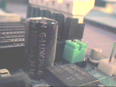

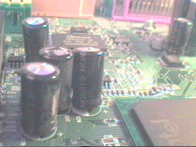

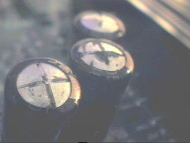

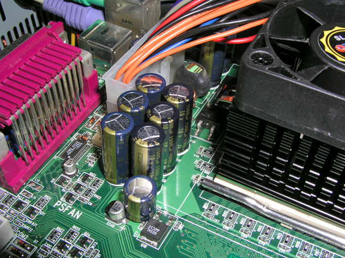

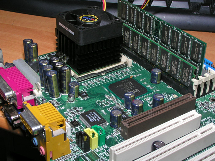

    MSI-6337 was acting possessed, windows was hanging periodically after a few years of good stable service. On checking for a reinstall, saw 7 caps bulging at the vents and with small release of brown electrolyte at the vents. Decided to replace the board in the pc before any damage done and keep for repair.
    Capacitors
    Lelon (Taiwan) - 8 pieces 1500mf/10V - Visible Fail 7
    Tayeh - 12 pieces 1000mf/6.3v - Visible Fail 0

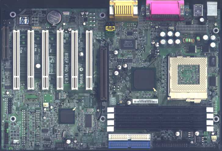

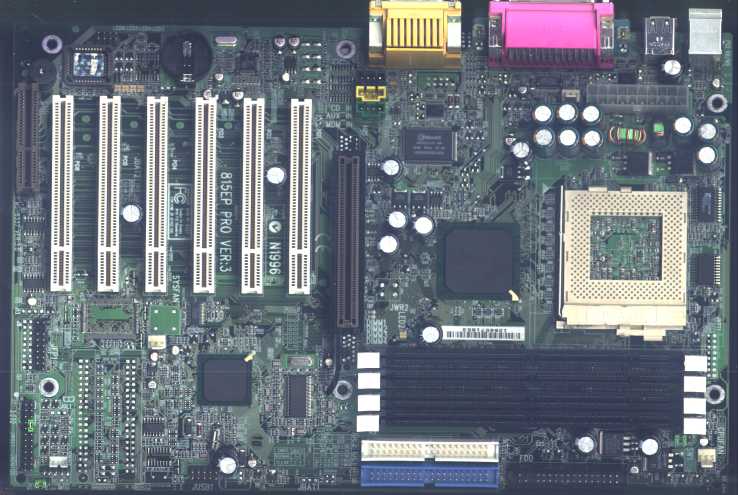

    Image of above board

      I would replace EVERY SINGLE ONE!! Even those not showing physical signs!! I've pulled probably thousands of bad Tayeh caps out of BP6's, KA7's, and many others. The Lelon brand I've never heard of but considering the fact that only 1 out of 8 isn't realy to explode is a good sign that the one holdout should be put into retirement!!
      If you plan on recapping your toasted boards, let us know the outcome!
      Good Luck!!

            recapped with Panasonic FC and working. took a year to get around to repairing it. do i get the prize for the most lazy repair.

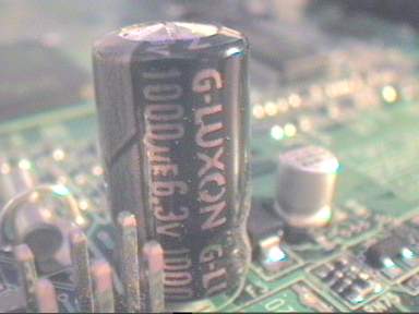

            • Rainbow
              • Aug 2005
              • 1374
              Re: MSI MS-6337 Ver 1 815e Socket 370

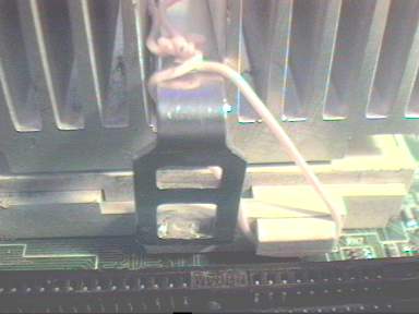

              On this one, the smaller caps were bad - the big ones were OK (don't remember the brands anymore). And the heatsink holder on the CPU socket was damaged so I "fixed" it using a wire
