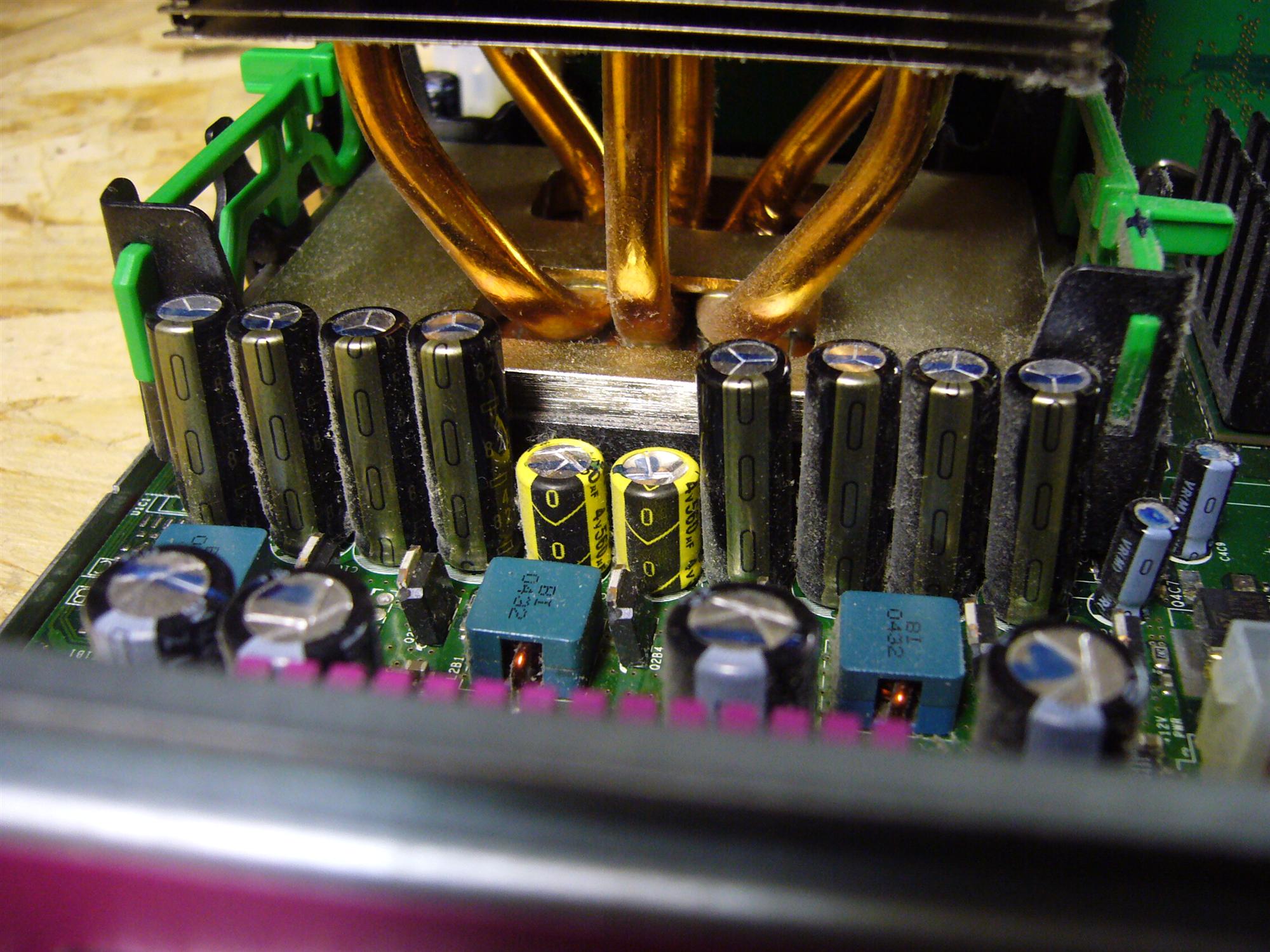

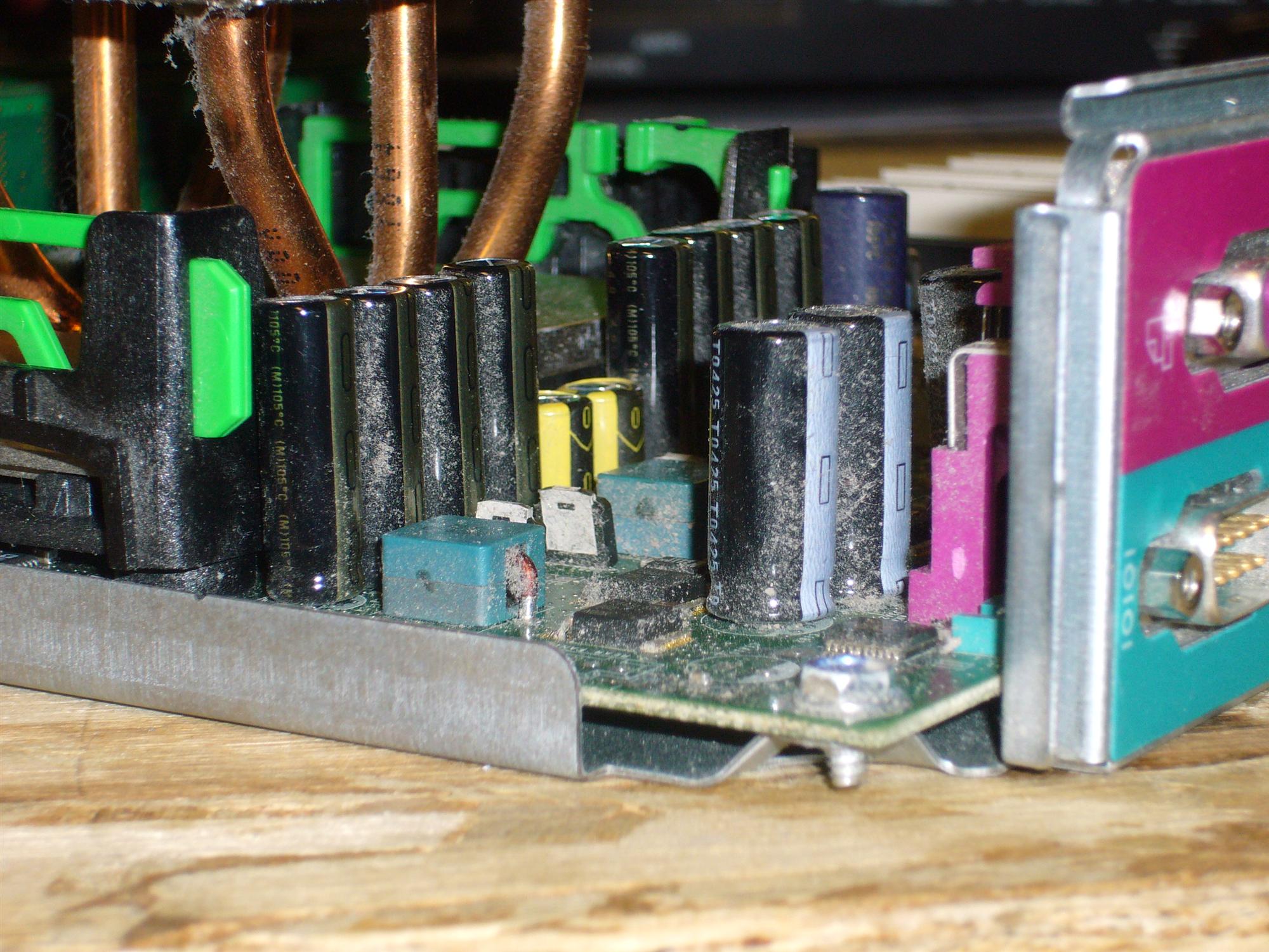

    Just making sure here...
    It's hard to see in the picture(s), but the 4th low v-core cap is starting to bulge. The originals are 820uf 4v KZV's. I've got some Chemi-con 820uf 2.5v caps that I think would be a good replacement (digikey part number 565-3057-ND).
    Can someone please confirm? Thanks!
    Re: Dell Dimension 8400 V-Core caps
    Yup. Works fine. I've done that mod a few times on some 8400s and GX280s, which has a similar motherboard.
