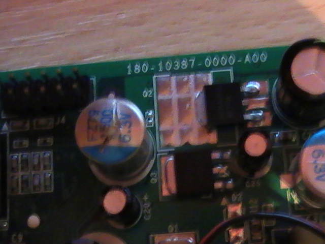

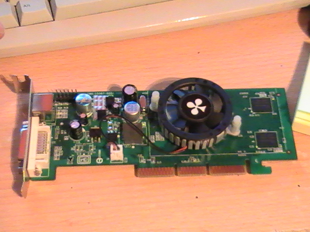

    Got 3 boxes + 5 machines for free yesterday...

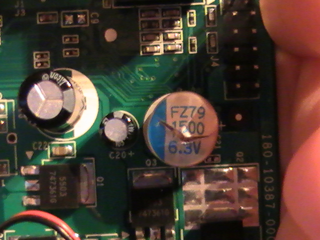

    A graphics card that looked nice was in it, but it has a blown cap... missing a DVI->VGA adapter right now to test it.
    Lookuing forward to replacing the cap soon

    You have both Licon and Sacon.
    The Sacon FZ I think you use Rubycon MBZ, Nichicon HM, Samxon GC, but what does it say on the Licon capacitors? You will have to replace those as well.

      I'd use MBZ or MCZ for all of them.

        Looks like a Club 3D GeForce 6200 with 256MB(?) of Video RAM.
