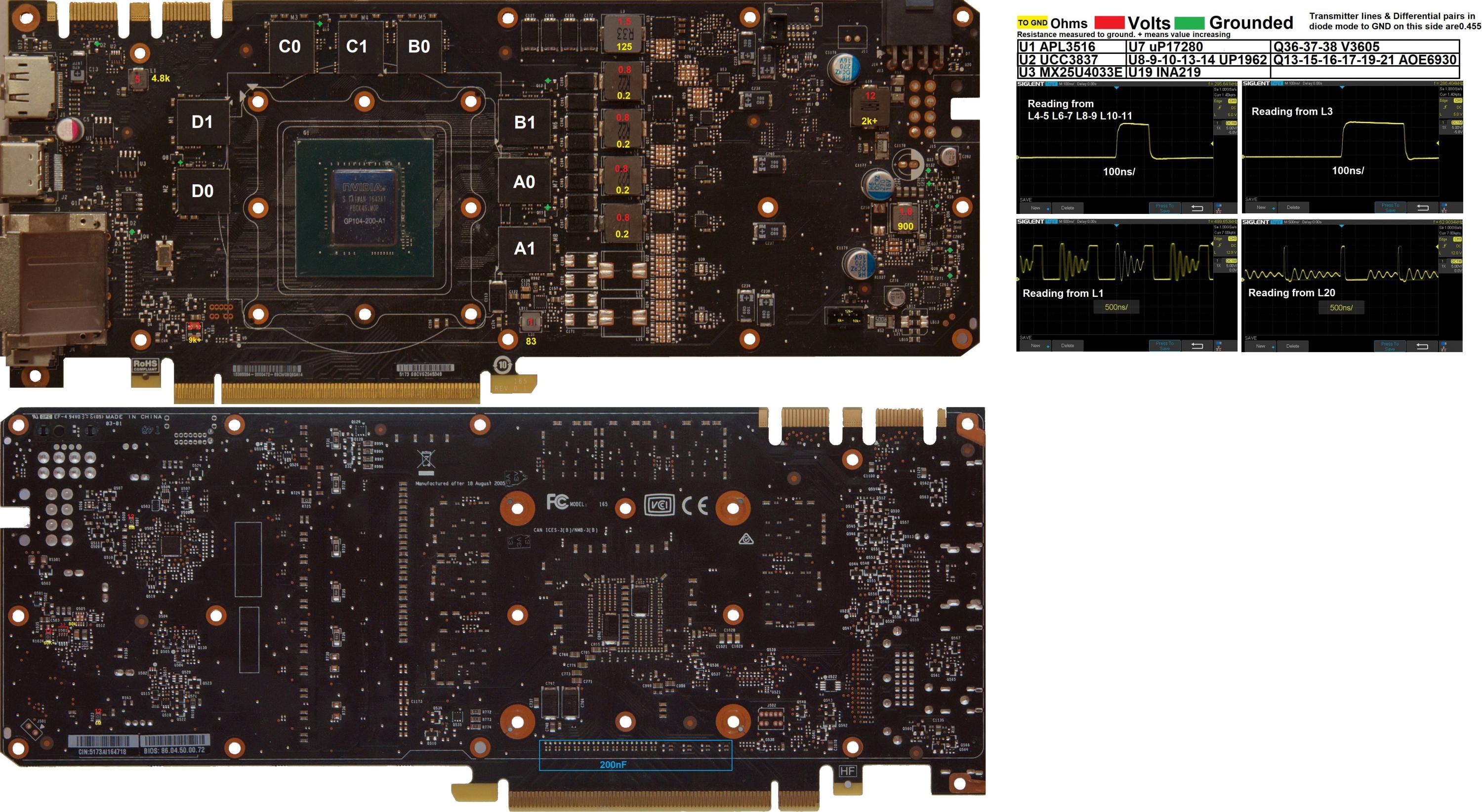

    Hello friends,
    I accidentally dropped my AIO on my 1070ti while changing it and knocked off a couple of things that vanished, never to be seen again. I'm thinking they are resistors, but I'm not certain because I can't get a read off the two below that look like they are the same from photos I found online. I have boxes of salvage components and I'm sure I can find a replacement to fix this card. If anyone can help, that would be fantastic.

    Looks like two capacitors, likely the same values as the two next to them

      Re: Identify whats missing from my Evga 1070 ti sc
      I think so to the black/grey colour of them confused be. Is the any way to find the values of the caps using a standard multimeter?
