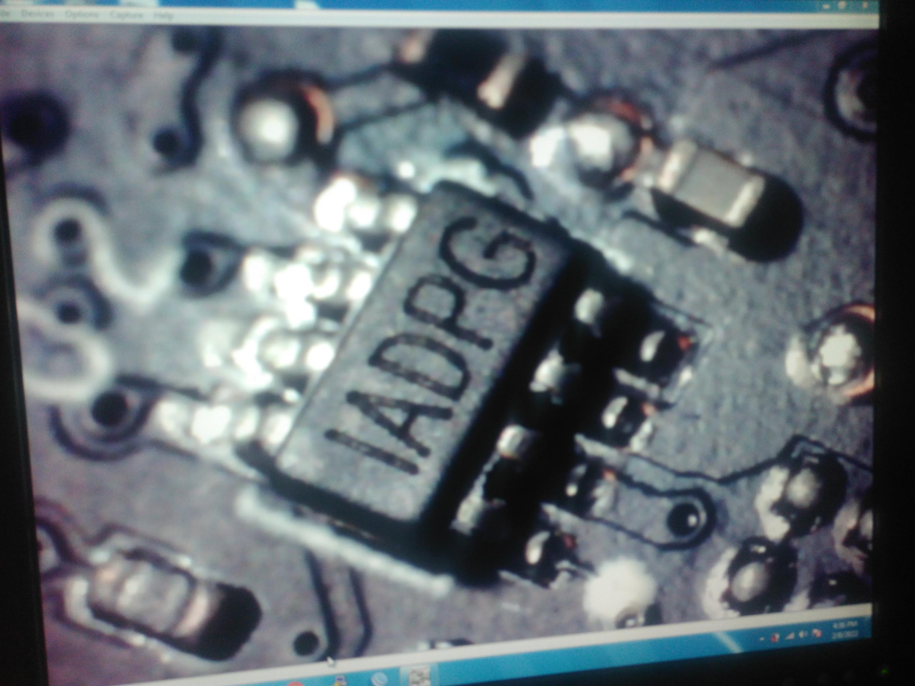

    hello.
    I have this EVGA GTX 1070 Ti that have 0.5V on 5V rail. i look at the regulator ic, but i cannot identify it. can u help?

    Re: EVGA GTX 1070 Ti - 0.5V on 5V rail - help identify ic
    MP1475 by Monolythic Power Systems.
        with datasheet i found shorted VIN to 5V regulator, next i found shorted capacitor in this lane. after replace i have 3.5V on VIN of regulator, so i search and fid that fuse dont blow but go high resistance avout 15kohm. that makes 12V on one side and 3.9V on other side. after fuse replace i have all voltages and card work normal
          Monolythic Power parts have a vertical or horizontal bar on them, its not a letter (not capital I) .https://www.badcaps.net/forum/showpo...85&postcount=3
            That's perfect, I'm happy it worked out. BTW, one good way to get from the marking to the part is using Aliexpre...' search engine. However usually some last one or two digits/letters is a batch/date code, so in this example only "ADP" is meaningful, also as SMDFlea stated, the bar is to be omitted as meaningless.
