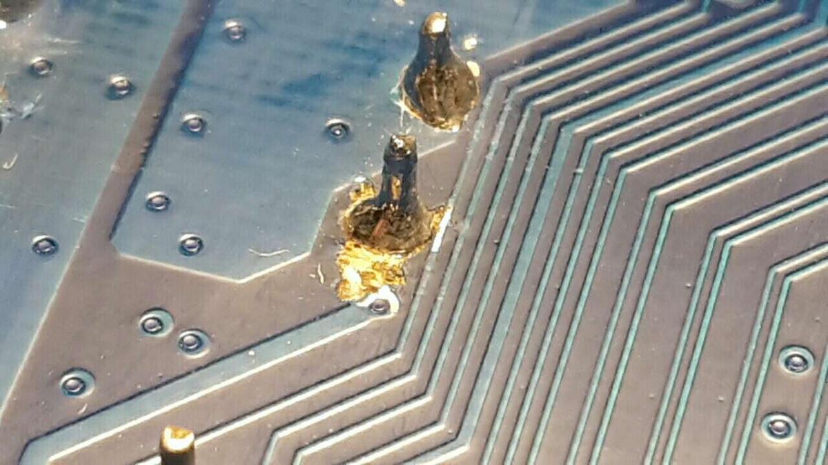

      Re: What is the best way to replace a electrolyt on ATX mother board
      Be aware of some crapy design routing signal wire near caps leg. It is easy to scrath coating when desoldering, and if you do not give extra attention, solder can easily bridge the gap - on picture, signal wire is 0.1mm and the gap is even smaller.
