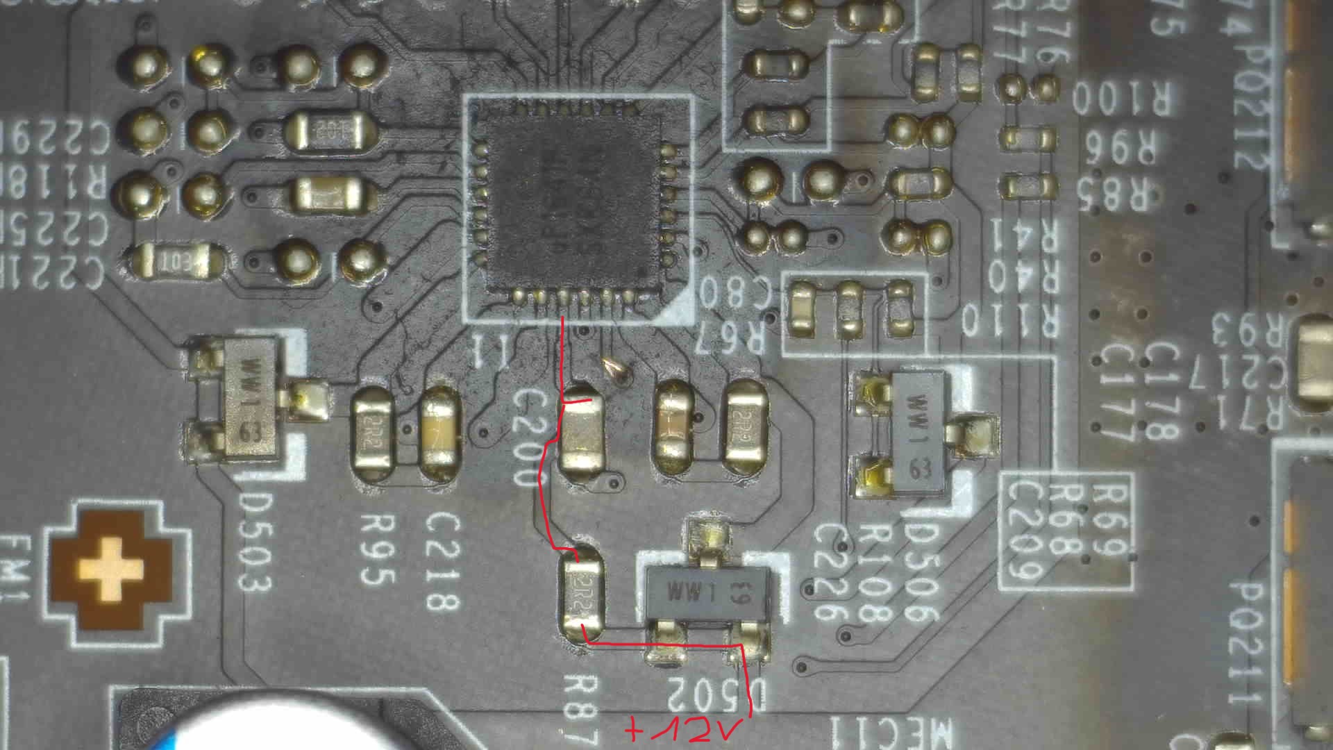

    Hi I'm working on a MSI GTX1070 Gaming 8G. Vmem is missing. Strange enough the card otherwise is working: All other voltages are there and the card is even detected. Obviously no image output because of "missing" memory.
    This is a picture of the uP1642P. It controls the memory voltage rail. Primary suspect of the fault.
    Datasheet uP1642P
    Pin 21 PVCC should be 5V. Datasheet says 6.5V max.
    But on this card it is actually getting 12V (measured), only a 2 ohm resistor separating it from the 12V rail.
    Is that a design fault?
    If I replace the IC, should I reroute PVCC to the 5V rail instead?

    IC is uP1641P not uP1642P. Probably different supply voltage.

        PVCC should be in range 4.5-26V.
        if dont find this how u wanna find fault?

          You're right. How did I miss that?!
          edit: Pinout however seems to match typical application circuit of uP1642P. So still useful because I can't find a datasheet for the uP1641P.

              Ok so there are a few variants for that IC, maybe it is more similar to uP9510 . That one accepts upto 15V on PVCC.
