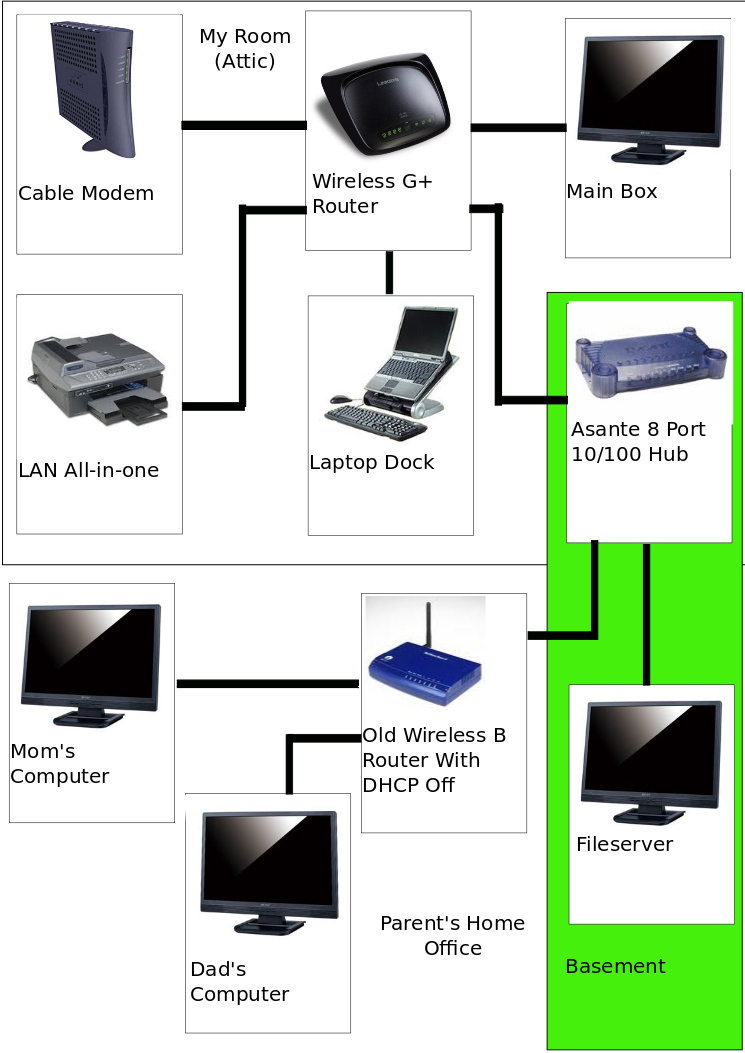

    Here is a "rough" estimate of my planned network:
    My question:
    I am password-protecting my workshop router. If I receive this signal at my upstairs dish/router, how/where do I put in the password? The upstairs thin client has an ethernet cable going to the upstairs router. That is to say, how will my upstairs thin client be allowed to log on to the Workshop network?
    (The upstairs thin client will be controlled (VNC or RDP) by the upstairs computer.)
    Thanks ahead of time,
    Jaime

    Re: computer on 2 networks
    What type of routers do you have are planning to use?
      I have a couple Linksys WRT54G routers. I am open to other options/suggestions.
      I do not know in which "mode" the upstairs router should be. I have set up dozens of simple home networks. This is new to me.
      Thanks for any help.
        The WRT54G are perfect for this application. Although, I'm a bit hesitant helping someone with a "Juniper" screen name with a Cisco product!
        You have a couple of alternatives.
        1) The Wireless Repeater mode will turn the access point into a wireless repeater to extend the range of your signal.
        http://linksys.custhelp.com/cgi-bin/...p?p_faqid=4200
        2) The Access Point Client mode allows the WAP54G to act as a wireless client.
        http://linksys.custhelp.com/cgi-bin/...i=&p_topview=1
        I assume your thin client has 2 ethernet ports?
          Haha! I still have a hard time thinking of Linksys as a Cisco entity.
          Thank you for the short & sweet answers. I asked at another forum. Some jerk just kept hassling me about how thin client computing was not cost-effective & was "out of date." I just picked up a $30 unit for fun, learning, and big savings on the number of watts the thing will pull.
          WAP Client mode - perfect. You even gave links with instructions - very nice.
          The client does have 2 NICs.
          Thanks for taking the time to help me out. It has given me information & confidence.
          -Jaime

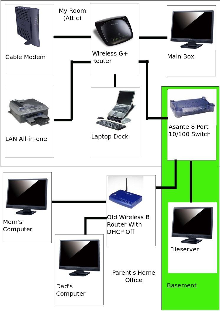

              looks more complex than mine... at least the only wifi on it is form a router to a laptop:

                Ratdude, you'll have a slightly nicer networking experience if you replace the hub with a switch, when life permits.
                  it IS a switch...
                  it is this model:
                  http://www.geeks.com/details.asp?Inv...008C&cpc=RECOM
                  i found it at a surplus place for $5, and needed one bad, so i took it. it does well...
                  i did not know there was a difference between hub and switch.
                  fixed:
                      Good price for a 10/100 switch.
                      Hubs work at layer 1 (aka simple repeater) Switches work at layer 2 or layer 3 depending on the implementation. Yours is a layer 2 switch.
                      Hubs were probably "before your time". You won't see hubs much nowadays. Just like thicknet or thinnet (for the guys that were involved with ethernet at the very beginning).
