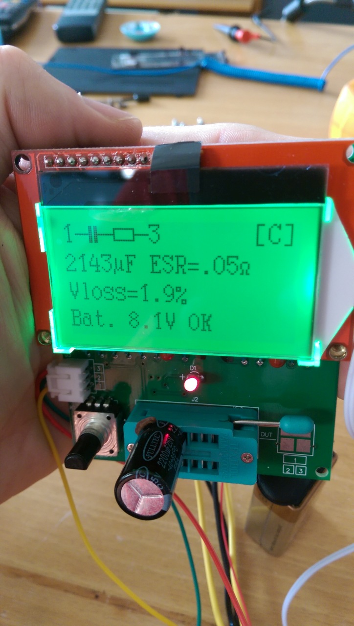

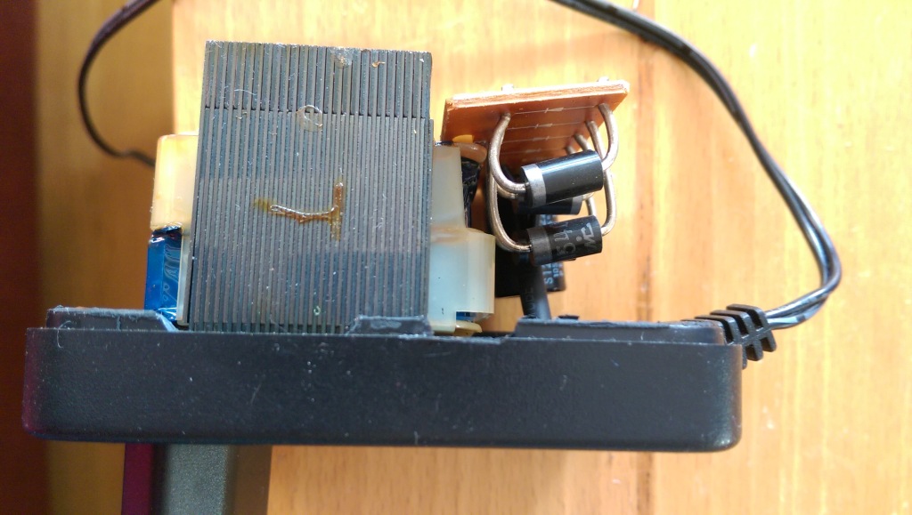

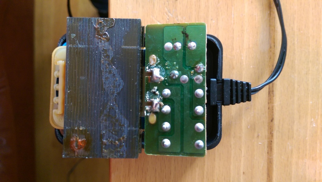

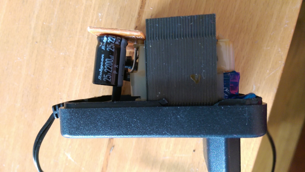

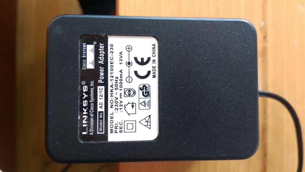

          I have a WRT54GS that was acting up two days ago.
          Packetloss on the WiFi, reboot did not help.
          Thought it might be the wallwart after remembering your thread.
          Because I had also recapped the router with Rubycons years ago.
          Cracked it open (without destroying anything, yay!).
          There was a Fulltec FRA 2200uF 25v cap rated 85°C
          But it actually measured good after all these years.
          Replaced it with a Rubycon anyway since I had the wallwart open.
          Still have not figured out what the cause of the packetloss was...

            • 30965
            Re: linksys router went unstable today with 3 years uptime.cause was rather interesti
            capacitance +esr o.k.
            but you couldnt check the ripple current.
            scoping it while running may have shown something interesting.
            • Per Hansson
              • Jul 2005
              • 5895
              • Sweden
              I did scope it while running.
              There was no significant difference before and after.
              About 1v sawtooth ripple but it's normal with a linear AC > DC wallwart.
              I.e. something like this: https://en.wikipedia.org/wiki/Ripple...background.svg
                • 30965
                any ripple is a design failure - the cap should have been better.
