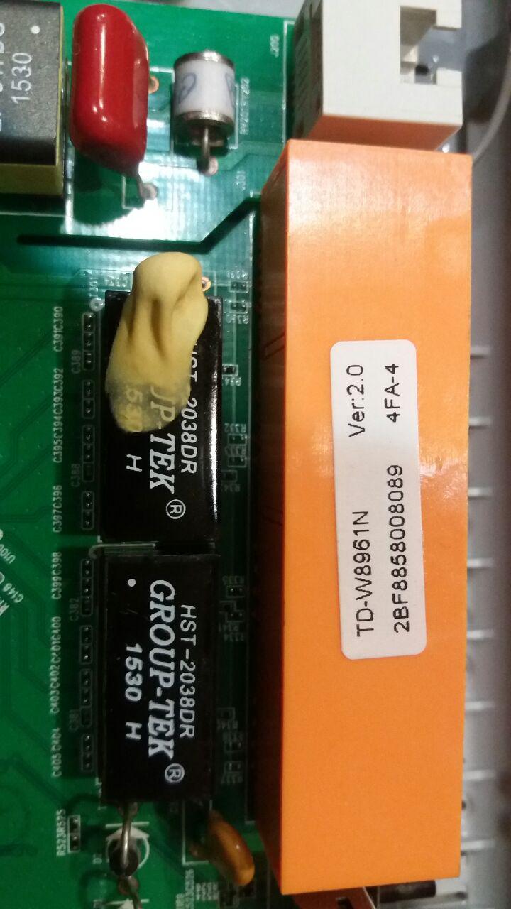

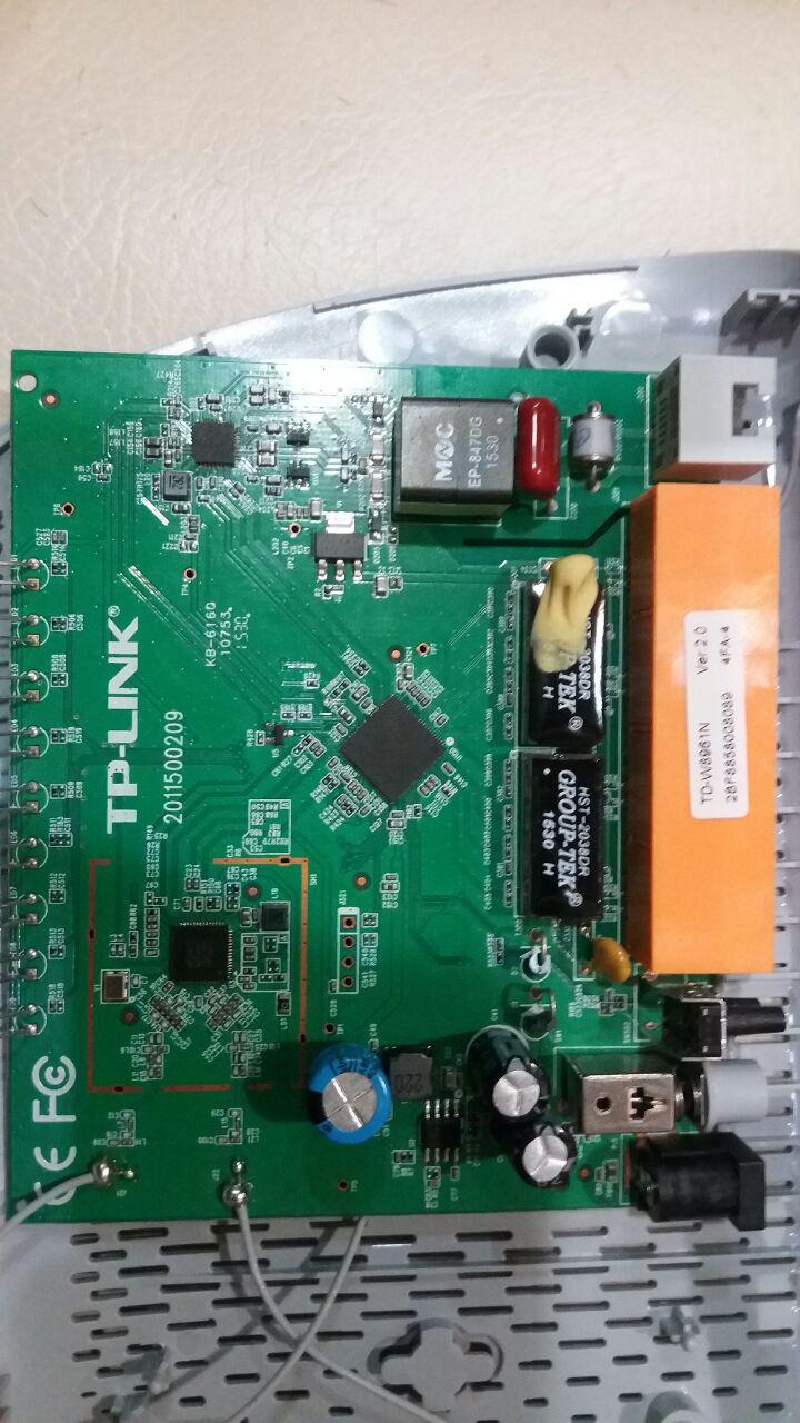

need flash dump for tp link modem:TD-W8961N rev:2
  • boyebaran
    • Sep 2015
    • 247
    • iran
    need flash dump for tp link modem:TD-W8961N rev:2
    Hi
    need flash dump for tp link modem:TD-W8961N rev:2
    CPU part number:MT7505N
    tnx
    • 31158
    Re: need flash dump for tp link modem:TD-W8961N rev:2
    http://www.tp-link.com/en/download/T....html#Firmware
    • boyebaran
      • Sep 2015
      • 247
      • iran
      Re: need flash dump for tp link modem:TD-W8961N rev:2
      tnx stj
      i need rom or bin file.firmware is in RAS format and can not reprogram by programer.
        • 31158
        Re: need flash dump for tp link modem:TD-W8961N rev:2
        post a dump of the original.
        the ras file probably just has some extra junk at the ends to remove.
        • goontron
          5000!
          • Dec 2011
          • 4108
          • US
          Re: need flash dump for tp link modem:TD-W8961N rev:2
          Here is what it looks like walking the binary
          Code:
          DECIMAL    HEXADECIMAL   DESCRIPTION
          63643     0xF89B     ZyXEL rom-0 configuration block, name: "dbgarea", compressed size: 0, uncompressed size: 0, data offset from start of block: 16
          63892     0xF994     ZyXEL rom-0 configuration block, name: "dbgarea", compressed size: 0, uncompressed size: 0, data offset from start of block: 16
          85043     0x14C33     LZMA compressed data, properties: 0x5D, dictionary size: 8388608 bytes, uncompressed size: 66696 bytes
          118036    0x1CD14     Unix path: /usr/share/tabset/vt100:\
          118804    0x1D014     ZyXEL rom-0 configuration block, name: "spt.dat", compressed size: 0, uncompressed size: 0, data offset from start of block: 16
          118824    0x1D028     ZyXEL rom-0 configuration block, name: "autoexec.net", compressed size: 25972, uncompressed size: 11886, data offset from start of block: 16
          128002    0x1F402     GIF image data, version "89a", 200 x 50
          136194    0x21402     GIF image data, version "89a", 560 x 50
          253333    0x3DD95     Neighborly text, "neighbor of your ADSL Router that will forward the packet to the destination. On the LAN, the gateway </font>e destination. On the LAN, the gateway </font>"
          349586    0x55592     Copyright string: "Copyright (c) 2001 - 2015 TP-LINK TECHNOLOGIES CO., LTD."
          386471    0x5E5A7     Copyright string: "Copyright &copy; 2015 TP-LINK Technologies Co., Ltd. All rights reserved."
          386489    0x5E5B9     TP-Link firmware header, firmware version: 17256.26992.22113, image version: " Co., Ltd. All rights reserved.", product ID: 0x6E42746E, product version: 1131375727, kernel load address: 0x72002223, kernel entry point: 0x46463939, kernel offset: 4475203, kernel length: 1347765096, rootfs offset: 1768969317, rootfs length: 2020868163, bootloader offset: 1347747908, bootloader length: 1229148245
          806847    0xC4FBF     LZMA compressed data, properties: 0x5D, dictionary size: 8388608 bytes, uncompressed size: 2853276 bytes
          It would appear to have a full rom image with a footer for the CFE and then some compressed information (bootloader?)
          Last edited by goontron; 11-04-2016, 11:47 AM.
          Follow the white rabbit.
          • ddscentral
            • Mar 2008
            • 151
            • Lithuania, EU
            Re: need flash dump for tp link modem:TD-W8961N rev:2
            That binwalk output looks like gibberish to me.
            • boyebaran
              • Sep 2015
              • 247
              • iran
              Re: need flash dump for tp link modem:TD-W8961N rev:2
              Hi
              here is original dump
                • 31158
                Re: need flash dump for tp link modem:TD-W8961N rev:2
                o.k.
                the first 64k is the bootloader,
                the last 64k is the settings,
                the bit in the middle is the firmware.
                so try this one i patched together.
                • goontron
                  5000!
                  • Dec 2011
                  • 4108
                  • US
                  Re: need flash dump for tp link modem:TD-W8961N rev:2
                  So the firmware is not a complete ROM
                  Code:
                  DECIMAL    HEXADECIMAL   DESCRIPTION
                  40960     0xA000     ZyXEL rom-0 configuration block, name: "dbgarea", compressed size: 0, uncompressed size: 0, data offset from start of block: 16
                  49172     0xC014     ZyXEL rom-0 configuration block, name: "spt.dat", compressed size: 0, uncompressed size: 0, data offset from start of block: 16
                  49192     0xC028     ZyXEL rom-0 configuration block, name: "autoexec.net", compressed size: 25972, uncompressed size: 11886, data offset from start of block: 16
                  129179    0x1F89B     ZyXEL rom-0 configuration block, name: "dbgarea", compressed size: 0, uncompressed size: 0, data offset from start of block: 16
                  129428    0x1F994     ZyXEL rom-0 configuration block, name: "dbgarea", compressed size: 0, uncompressed size: 0, data offset from start of block: 16
                  150579    0x24C33     LZMA compressed data, properties: 0x5D, dictionary size: 8388608 bytes, uncompressed size: 66696 bytes
                  183572    0x2CD14     Unix path: /usr/share/tabset/vt100:\
                  184340    0x2D014     ZyXEL rom-0 configuration block, name: "spt.dat", compressed size: 0, uncompressed size: 0, data offset from start of block: 16
                  184360    0x2D028     ZyXEL rom-0 configuration block, name: "autoexec.net", compressed size: 25972, uncompressed size: 11886, data offset from start of block: 16
                  193538    0x2F402     GIF image data, version "89a", 200 x 50
                  201730    0x31402     GIF image data, version "89a", 560 x 50
                  318869    0x4DD95     Neighborly text, "neighbor of your ADSL Router that will forward the packet to the destination. On the LAN, the gateway </font>e destination. On the LAN, the gateway </font>"
                  415122    0x65592     Copyright string: "Copyright (c) 2001 - 2015 TP-LINK TECHNOLOGIES CO., LTD."
                  452007    0x6E5A7     Copyright string: "Copyright &copy; 2015 TP-LINK Technologies Co., Ltd. All rights reserved."
                  452025    0x6E5B9     TP-Link firmware header, firmware version: 17256.26992.22113, image version: " Co., Ltd. All rights reserved.", product ID: 0x6E42746E, product version: 1131375727, kernel load address: 0x72002223, kernel entry point: 0x46463939, kernel offset: 4475203, kernel length: 1347765096, rootfs offset: 1768969317, rootfs length: 2020868163, bootloader offset: 1347747908, bootloader length: 1229148245
                  872383    0xD4FBF     LZMA compressed data, properties: 0x5D, dictionary size: 8388608 bytes, uncompressed size: 2853276 bytes
                  2035732    0x1F1014    ZyXEL rom-0 configuration block, name: "spt.dat", compressed size: 0, uncompressed size: 0, data offset from start of block: 16
                  2035752    0x1F1028    ZyXEL rom-0 configuration block, name: "autoexec.net", compressed size: 25972, uncompressed size: 11886, data offset from start of
                  Follow the white rabbit.
                    • 31158
                    Re: need flash dump for tp link modem:TD-W8961N rev:2
                    no, the one from tp-link does not include the bootloader, or the settings block.
                    the missing settings block was expected because it probably has the mac's in it.
                    • boyebaran
                      • Sep 2015
                      • 247
                      • iran
                      Re: need flash dump for tp link modem:TD-W8961N rev:2
                      tnx so much stj
                      with your file i can not login to setup(user name or password is incorrect( message)).
                      i have this problem with original rom file too.
                        • 31158
                        Re: need flash dump for tp link modem:TD-W8961N rev:2
                        so do a factory reset - it's in the manual.
                        https://cdn.badcaps-static.com/pdfs/...967fd1e04f.pdf
                        • boyebaran
                          • Sep 2015
                          • 247
                          • iran
                          Re: need flash dump for tp link modem:TD-W8961N rev:2
                          tnx all friend to help
                          rest by button did not work and by setup not impossible because i can not enter to setup.
                          here i uploaded working dump updated with last firmware.
                          tnx again stj
                            • 31158
                            Re: need flash dump for tp link modem:TD-W8961N rev:2
                            so it works now?
                            • boyebaran
                              • Sep 2015
                              • 247
                              • iran
                              Re: need flash dump for tp link modem:TD-W8961N rev:2
                              yes.every things is ok.
                              • mohannadmk
                                • Sep 2017
                                • 2
                                • hama
                                Re: need flash dump for tp link modem 8961nd v3 + w8901G v3
                                pleas I need full dump for 2 router tplink
                                8961nd v3 + w8901G v3
                                file format bin
                                • medjahed
                                  • May 2018
                                  • algerie
                                  Re: need flash dump for tp link modem:TD-W8961N rev:2
                                  please dump modeme tp-link w8901G
                                  • ham-amari
                                    • Jun 2018
                                    • algeria
                                    Re: need flash dump for tp link modem:TD-W8961N rev:2
                                    thanks
                                    • Farah676
                                      • Jun 2021
                                      • Iran
                                      Re: need flash dump for tp link modem:TD-W8961N rev:2
                                      • sadraa
                                        • Jul 2020
                                        • 3
                                        • iraq
                                        Re: need flash dump for tp link modem:TD-W8961N rev:2
                                        HI EVERY ONE
                                        I NEED w8961n(un) ver 4.0
                                        IS THERE ANY ONE HAS THIS ONE?>?
