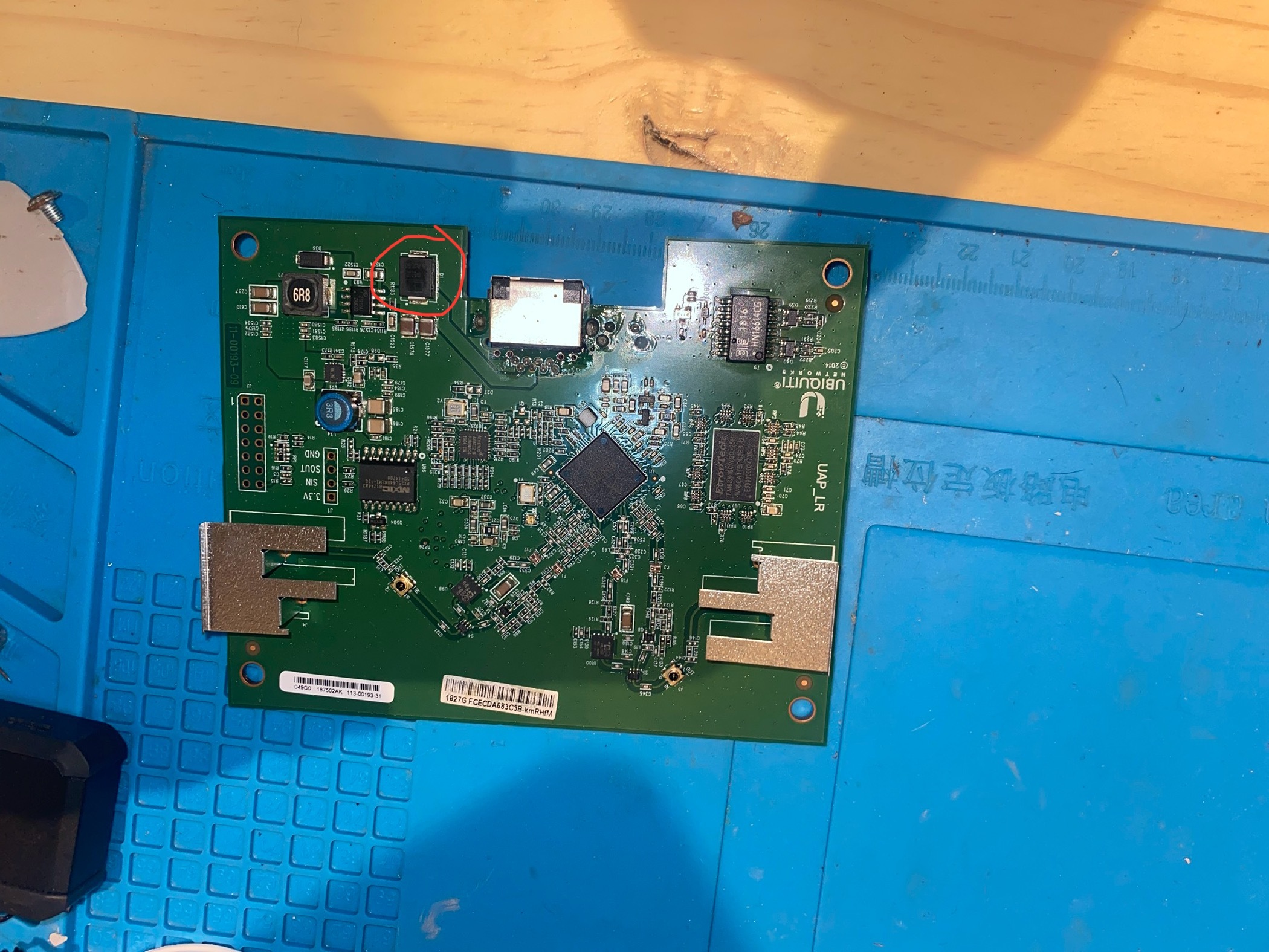

    Hi guys,
    So I have a Unifi LR AP one of the older ones. And I accidentally connected it to the POE port on my mini UPS while it was in 24V mode and it must have fried something. Attached is a pic of the board, when I connect it to the PoE injector the one diode I’ve circled gets very hot, is this likely the issue and I just need to replace this diode or would something else have blown from the overload? Thanks for the help.

    what does the diode say on it?

      TVS Diode (Suppresor).

        remove dead diode then see if board shorted
          This - it's quite possible the diode failed short and prevented the voltage from damaging the rest of the circuit, hopefully anyway.
          If that is the case you should replace the diode for continued protection...
