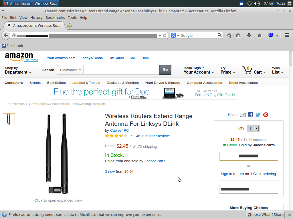

    Hi guys i have a dsktop that has a similar card to this one in the link,
    it does have 2 inputs for antenna and one for cable,but it doesn't have the Antennas,signal is very low,i have to lift up the tower in order to receive signal that somewhat some times fails,only has 2 bars.
    Wlan .079 MiB sent, and 5.85 MiB received.
    my question do i need to get the antenna? thanks in advance.

    no, you need to get a better one. those define junk!
    Follow the white rabbit.
      • 31214
      Re: wireless Card antenna
      you need the antenna - and they will cost a minimum of $4 each.
      and they wont work well if the signal comes from toward the front of the pc because there is a big chunk of grounded metal in the way!

          I've had good results with these, as the antenna can be placed away from the PC and it's metal interference.

            Hi guys; new update on the PCI wireless card,i was going through my electronic scrap and found a Bufalo wireless router that i forgot about and came to my surprise it had an antenna just like this one in the pic,i took it out and atached it to the wireless card on one of those antennas input and voila i have almost 90% signal,now i thing it will not fail,

                  Just remember this for next time in case you run into the same situation: anything is better than no antenna at all - even a simple piece of wire. So if you really are in this situation, just find a piece of wire and tie it to the middle pole. It may not give you optimal results, but it should still be much better.
