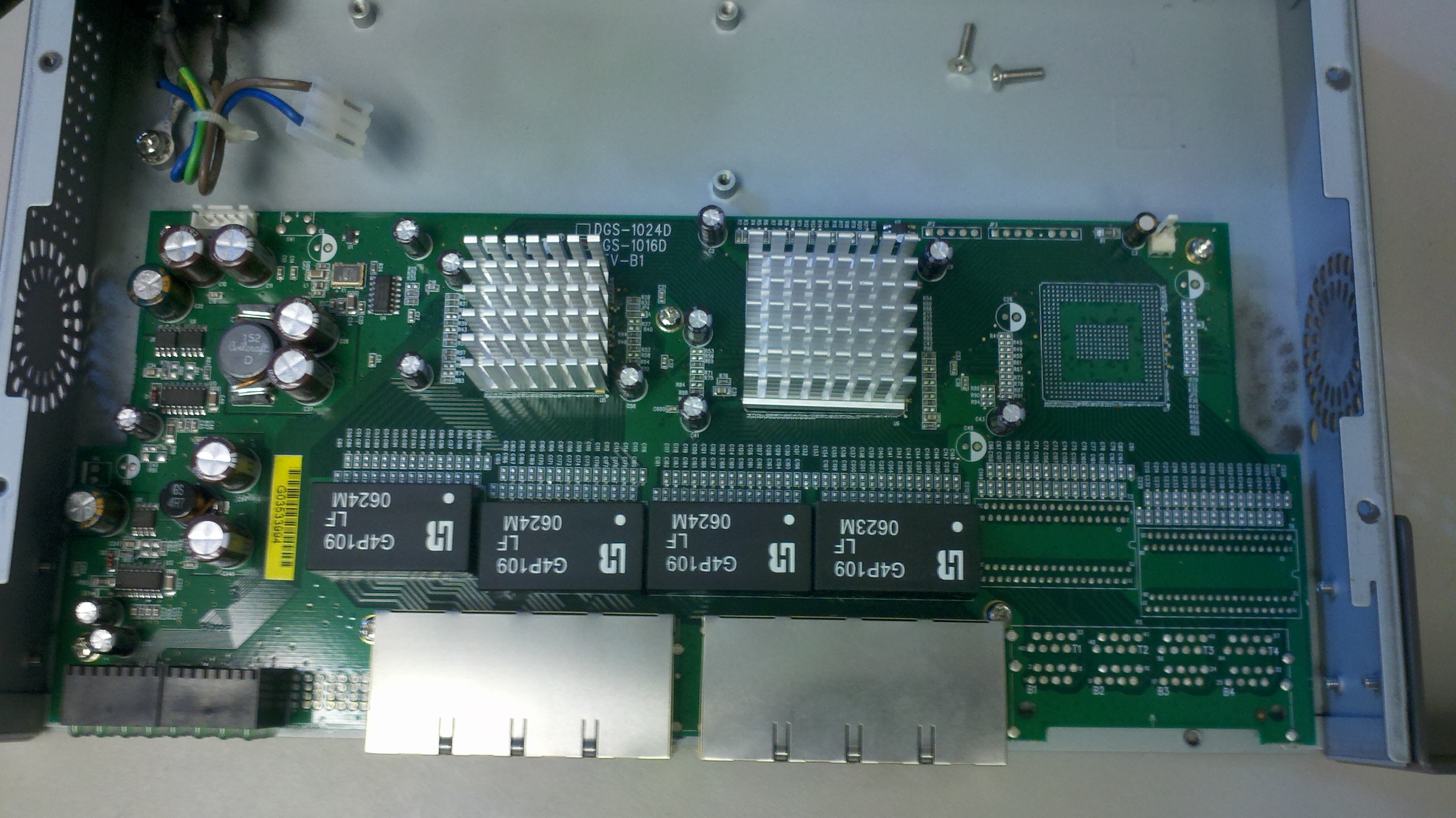

    At my work, one of our corporate switches died. When plugged in, not even the power light will light up. It's a D-Link DGS-1016D. I opened it up and visually it looks fine. It has a Delta PSU in it, can't read the primary but the secondary caps on it are Ltec. On the mainboard, it's plagued with the dreaded Evercon I took out both of the PCB's and nothing looks burned on the bottom of them. I checked this because the little cooling fan on the side went bad so I originally thought that something overheated.
    I won't have a multimeter till Monday but I'm wondering if this could even be a capacitor problem. I don't trust Evercon AT ALL, so I'm wondering if they died without showing symptoms since they are such garbage caps? Or even the Ltec's on the PSU, because I'm thinking if it won't even turn on that it's a PSU problem. Any input would be appreciated!

      Post pictures of the hardware here. As clear as possible.
      Check if there's a fuse on the board near power connector. Make sure the fuse isn't popped.
      It's possible the board uses a few linear regulators to generate 3.3v, 2.5, 1.8 v out of a higher voltage - check those regulators and see if they are ok.
      If you get some pictures online, again very clear, we may be able to suggest what to check for.
      the mains connector, if the switch is powered straight from mains. If the power supply (you say is delta) is similar to those laptop adapters, make sure it outputs some voltage.

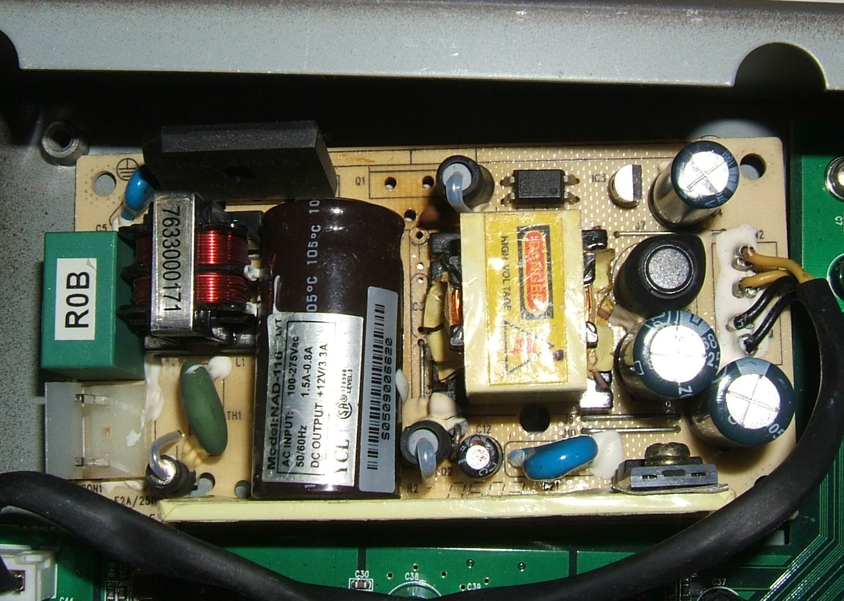

          Later models of DGS-1016D and DGS-1024D have a lifetime warranty.

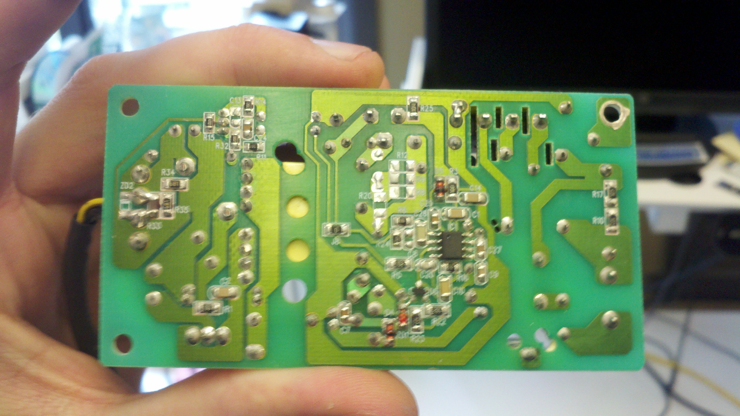

          One cap takes these switches down. Power supply C12 is the tiny cap next to the big input cap. You can't see it with the cap in but when you get it out you'll see heat damage which is why it goes bad. You can replace any other cap you like but that's the only cap I've ever seen go bad.

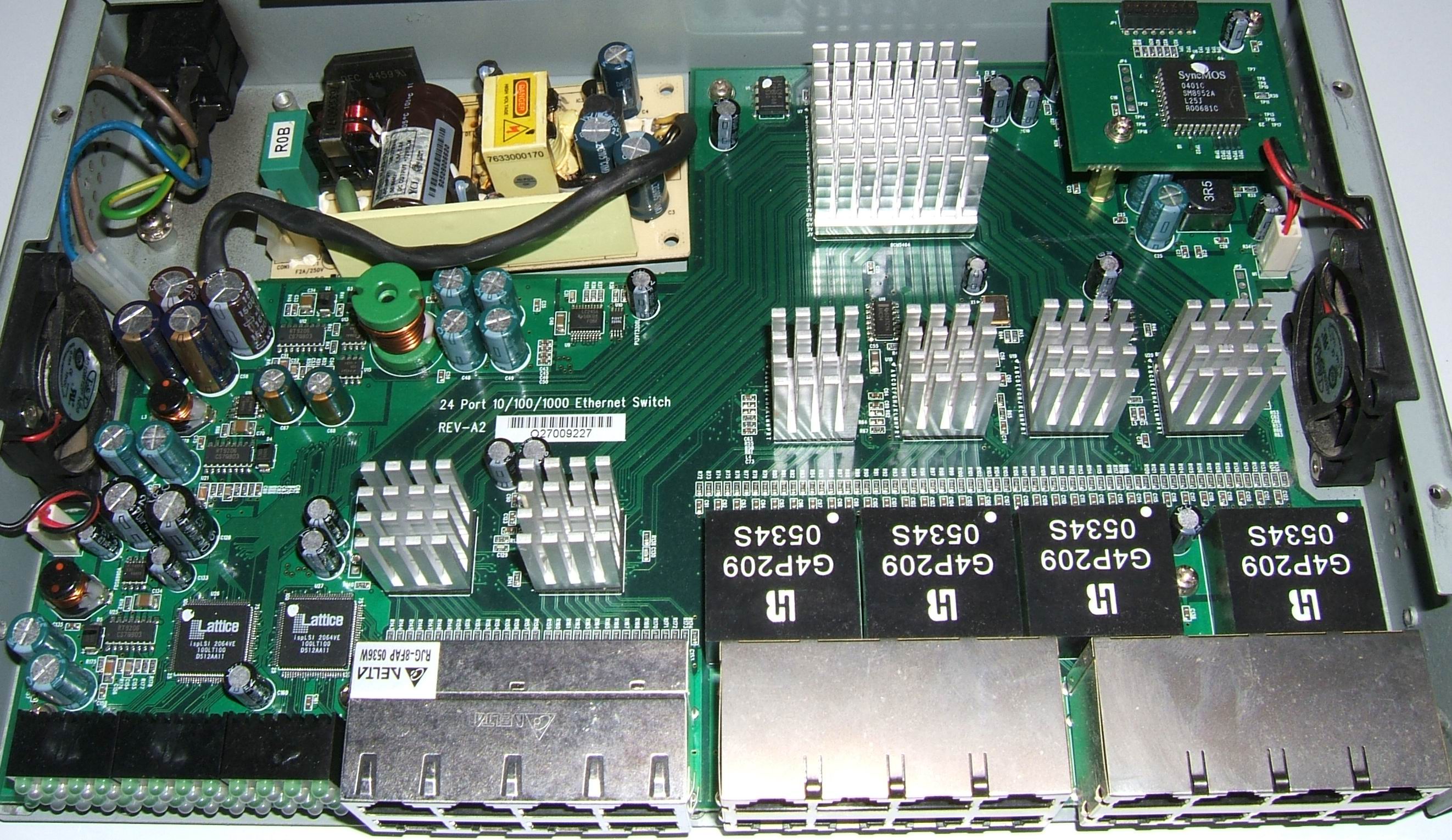

          Here's the work I did on the DGS-1024D which should have the same power supply.
          HW Ver A2
          Power Supply: NAD-116 12v 3.3A YCL PCB452-B
          IC1: Fairchild KA3882 SMPS CONTROLLER (KA3882CDTF)
          D3: OnSemi B20100G dual rectifier
          D3: E220A dual rectifier
          U3: UTC TL431 Shunt regulator
          Q1: Fairchild FQPF7N80C 800V N-Channel MOSFET
          C?: Nichicon PT 100uf 450v
          C11, C3: Ltec LZG 680uf 25v WV=12v ESR=0.04
          C4: Ltec LZG 470uf 25v WV=12v ESR=0.06
          C12: Ltec TK 47uf 50v WV=11.3v ESR>20
          R7: Resistor 18K measures 9K with IC1 in place
          IC?: Lite On LTV-817 LTV-817C LTV-817-C optoisolator (test with bench supply, compatible with Fairchild FOD817C)
          ZD1: more than 15.7v
          Unit does not power up. Fans will spin if push started. Power supply outputs 3v under load and 7v with load removed. C11, C3, C4 test good. I swap U3 with no change. C12 tests with excessive ESR. Then I notice the heat damage from C? to C12. Replacing C12 brings the output voltage up to 12v and restores operation.
          After a few minutes most of the port LEDs flash randomly.
          Main board: REV-A2
          U5, +U8 C15,C19:12v -> C22,C25:3.3v
          U12, +U13+U15 C57,C58:12v -> C38,C39,C48,C49:1.25v
          U21, +U16 C67,C68:12v -> C77,C78:2.5v
          U25, +U24 C126,C128:12v -> C137,C158:1.8v
          :Richtek RT9206 High Efficiency, Synchronous Buck with Dual Linear Controllers
          U13: Fairchild FDS7764A 30V N-Channel MOSFET
          U15: Fairchild FDS6694 30V N-Channel MOSFET
          U16: Fairchild FDS6986S Dual N-Channel MOSFET
          U24: Fairchild FDS6986S Dual N-Channel MOSFET (labeled FDS6990A)
          U8: Fairchild FDS6986S Dual N-Channel MOSFET
          U4: Philips 74AHC14D Hex inverting Schmitt trigger
          U11, U14: TI 74AHC04 Hex inverter
          U1: 24LC64 EEPROM
          U10: Pericom PI3VT3306 2-Bit, 2-Port, Low Voltage. Translator Bus Switch (incorrectly labeled P13VT3306L)
          U9: TI 74LC245A OCTAL BUS TRANSCEIVER WITH 3-STATE OUTPUTS
          U17, U18, U19, U20, U22, U23: Labeled: Broadcom BCM5014R quad Gigabit Ethernet 1000BASE-T phy
          U7: Labeled: Broadcom BCM5464 Quad Gigabit Ethernet 1000BASE-T phy (seems incorrectly labeled as it appears to be a 24 port switch without integrated Phy. Each set of 4 goes to a BCM5014R. More likely to be a BCM5345M.)
          D1, D2, D3, D4, D5: B340B SMD DIODE SCHOTTKY 40V 3A
          U26, U27: Lattice ispLSI 2064VE PLD Programmable Logic Device
          T1, T2, T3, T4: Bothhand G4P209 Quad Port 1000BASE-T Ethernet Transformer
          U28: Delta RJG-8FAP 4x2 8 port Ethernet jack with integrated 1000BASE-T Ethernet Transformers
          Fans: T&T 4010M12F ND8 12v 0.16A 40x10x10 mm 2 wire
          C137, C158, WV=1.8v
          C77, C78, WV=2.5v
          C38, C39, C48, C49, WV=1.25v
          C22, C25: Taicon PW 1000uf 10v WV=3.3v
          C133, WV=12v
          C160, C37, C4, WV=3.3v
          C132, C16, C10, WV=2.5v
          C9, C36, WV=1.25v
          C131: TBOR 100uf 25v WV=1.8v
          C79, WV=2.5v
          C124, C80: GSC 100uf 16v WV=1.25v
          C126, C128, C57, C58, C15, C19: TOBR 470uf 25v WV=12v
          C42, C44: GSC RE 1000uf 25v WV=12v
          C67, C68: Teapo SC 470uf 16v WV=12v
          C127, C24: TBOR 47uf 25v WV=12v
          C47, WV=1.25v
          C32, ROM-C5: Teapo SS 47uf 16v WV=3.3v
          The voltages with the ROM out have a lot more ripple than when the ROM is in. I ended up replacing a few caps.
          C42, C44, C57, C58: Rubycon MBZ 1500uf 16v
          I don't think the caps made any difference but the unit is running fine and the random flashing LEDs haven't returned.

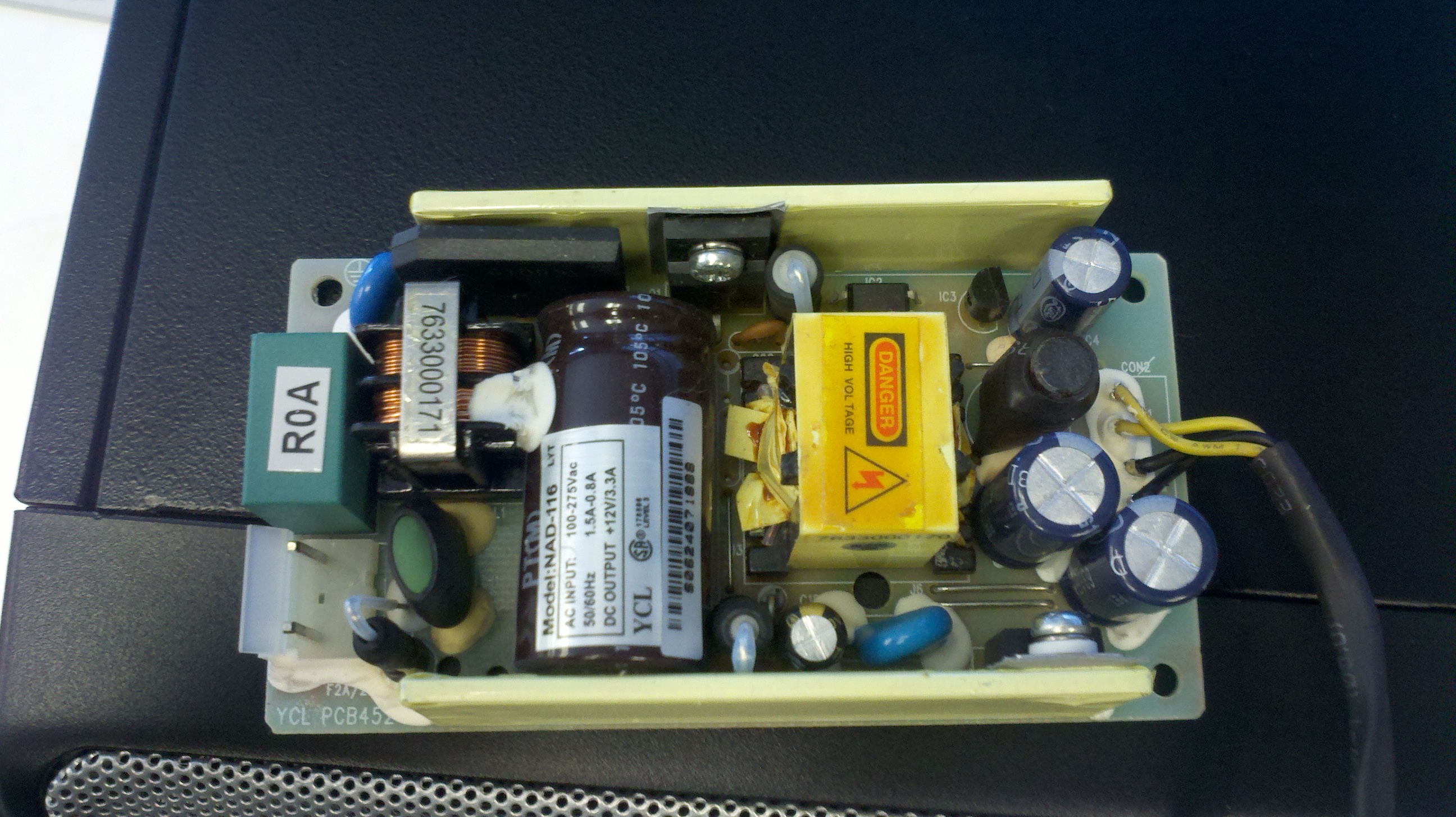

                I got a chance to take a look at this thing (been busy) and when plugged in the power supply gives a high pitched whine. I don't remember it doing this before. And here are the long overdue pictures! Let me know if I need to get a more clear picture for any of them, it's hard to get perfect pics with my phone

                    I suggest you replace all the caps in the switch. The psu caps, and the mainboard caps.
                    The whine gives it away - a dried up capacitor!
