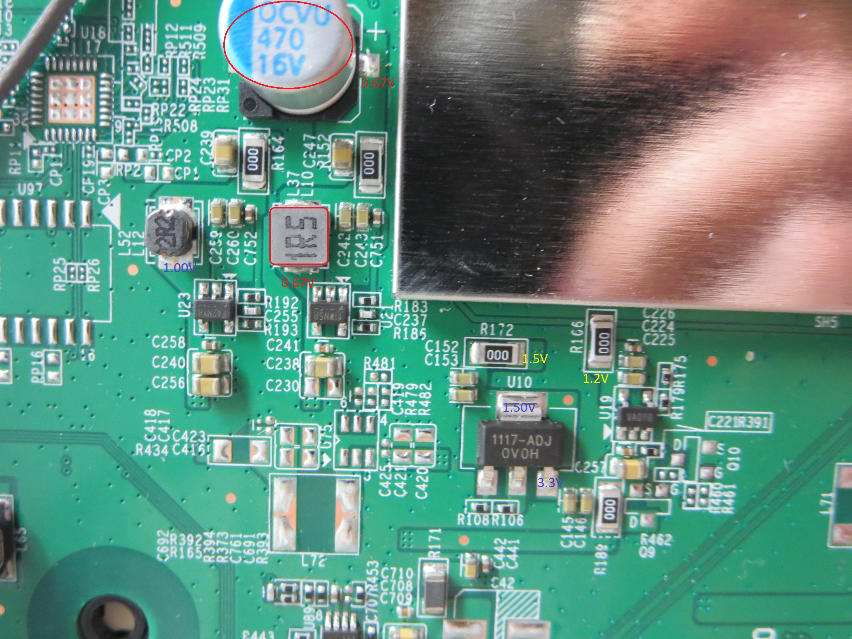

    Hi there,
    Netgear router, model R7200 [similar to R6800, R6700v2] pressing power button, the WiFi LED glowing solid white, with NO Power LED light… so no boot up properly! Done the hard reset for 30/30/30sec …no change. Checked the power adaptor voltage output= 12.02V
    Remove the cover and check all components … no visible damage. The inductors and solid capacitors show reasonable voltages [between 12.0, 5.0 ,3.3 and 1.0V] except L10 and C205 = 0.67V, [my guess is kind of low].
    The U21 and U23 ICs [voltage reg] have similar application circuit but unable to identify the datasheet. The voltage at R164 is 1.0V and R162 only 0.67V. Without schematics is hard to find the culprit. I would appreciate any help…

    Re: Netgear R7200 (AC2100) no boot up
    My suggestion is to test the power adapter on incandescent light bulb does it light like it should on 12 volts or is it lower than 12 volts
