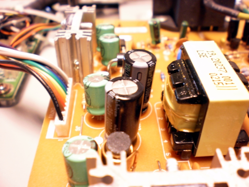

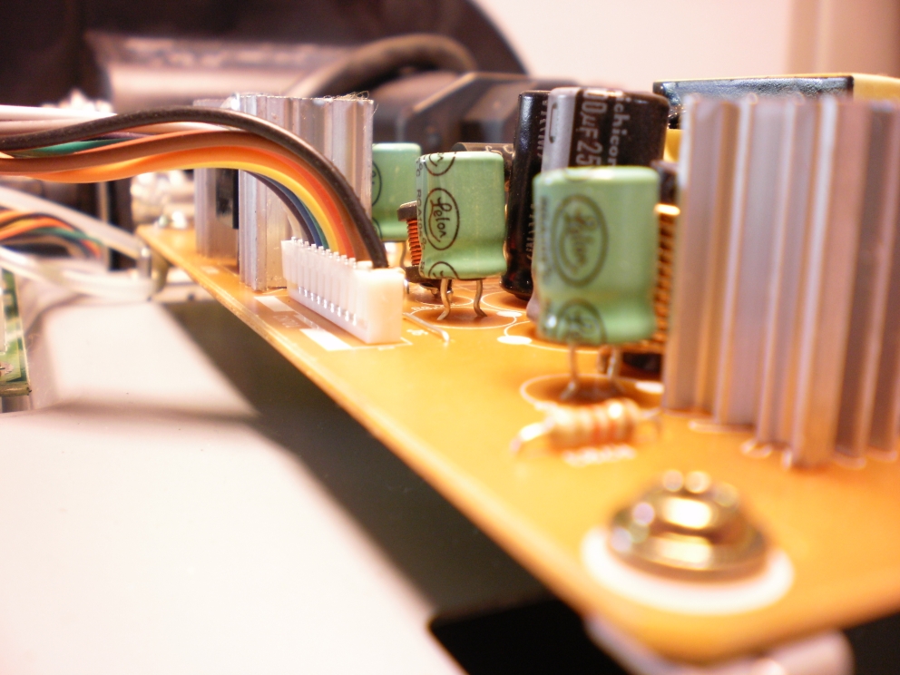

    • alegro
      • 33
      Re: Dell E151FP ~ Blues/Greens come & go

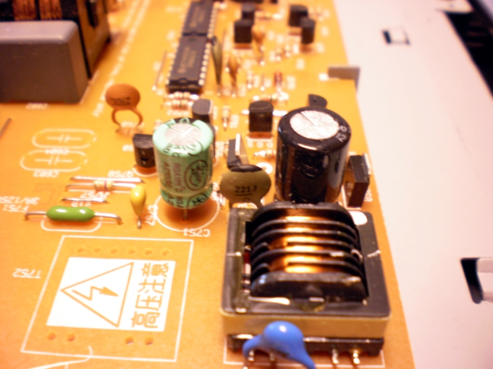

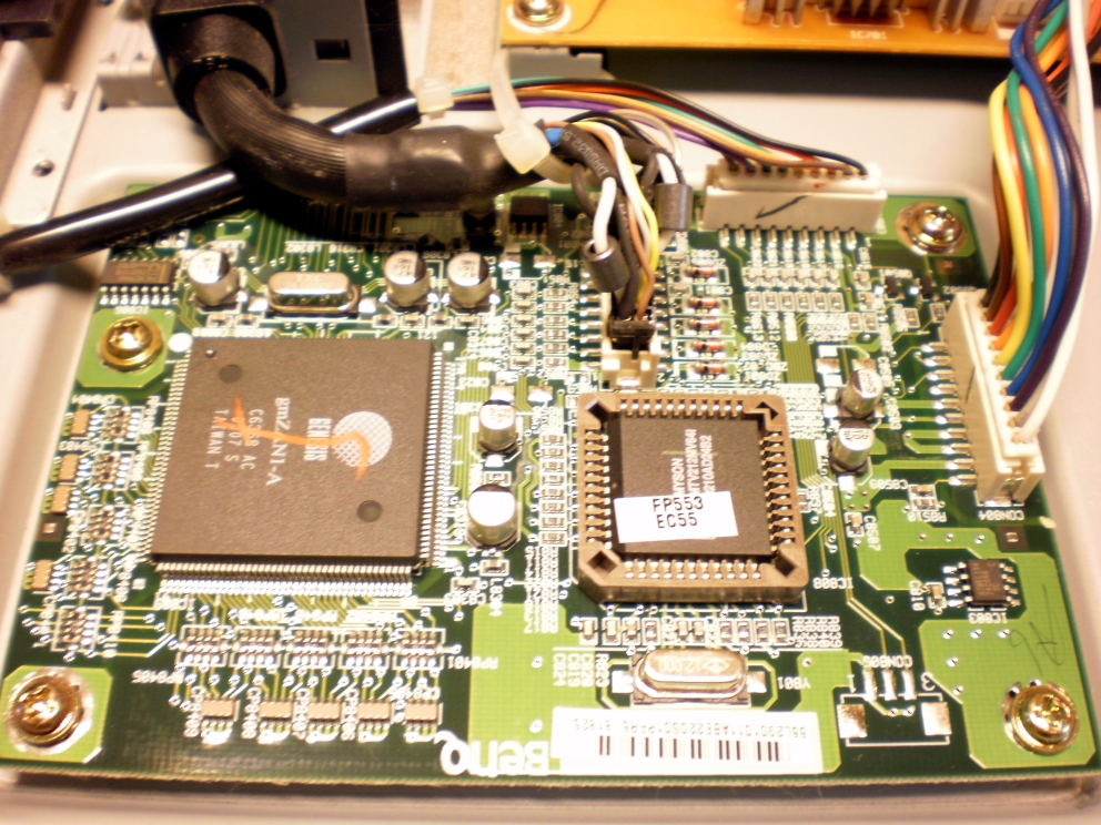

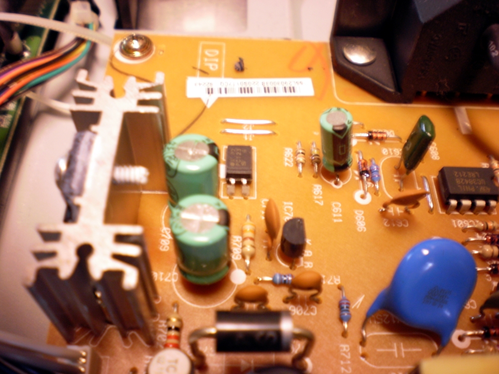

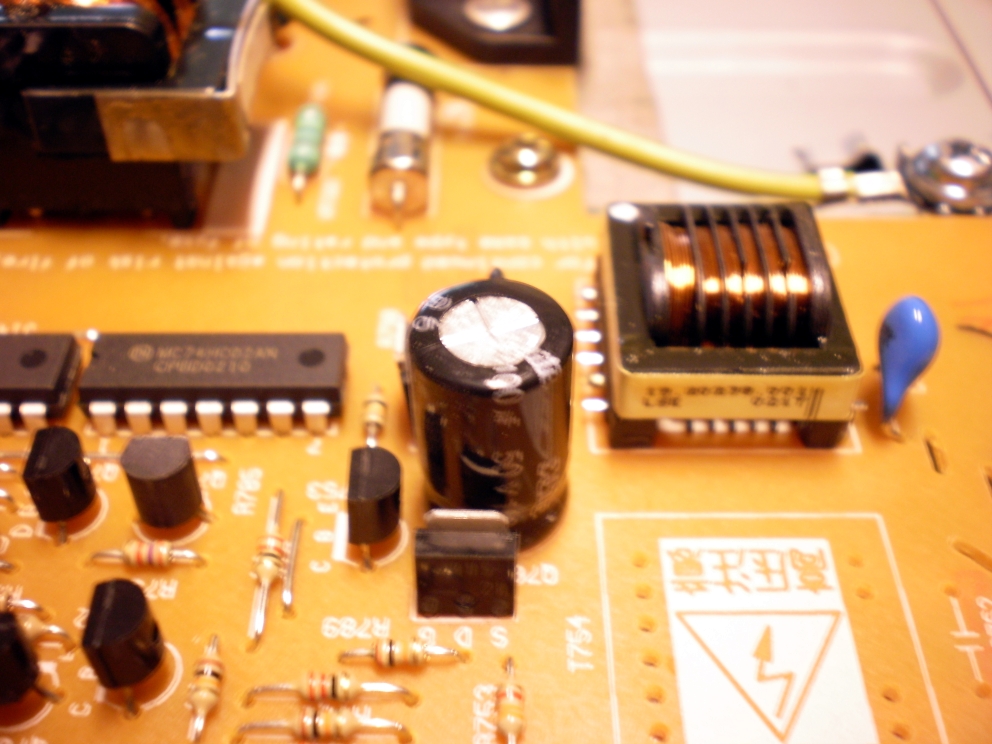

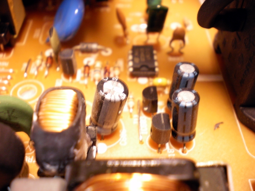

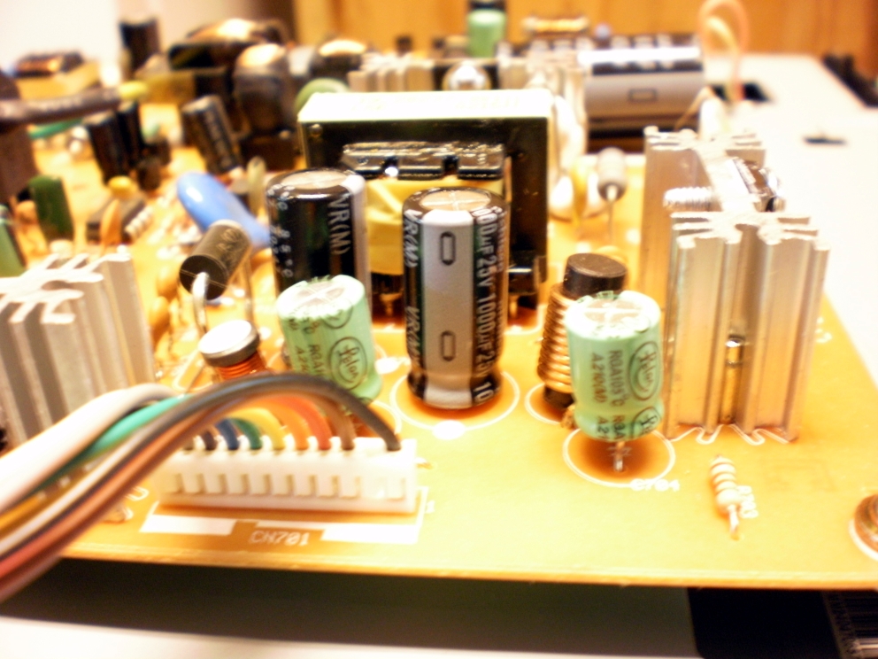

      photos of boards

              • jetadm123
                • 2169
                With the monitor off, have you tried reseating the cable(s) on the logic/video boards at both ends?
                • jetadm123
                  • 2169
                  Upon further examination, it looks like the power board was recapped with general purpose caps instead of low-esr ones. The Nichicons are general purpose VR series rated at 85 deg C. The green Lelons are RGA series, which I believe are also general purpose. Maybe a potential cause of the problem?
