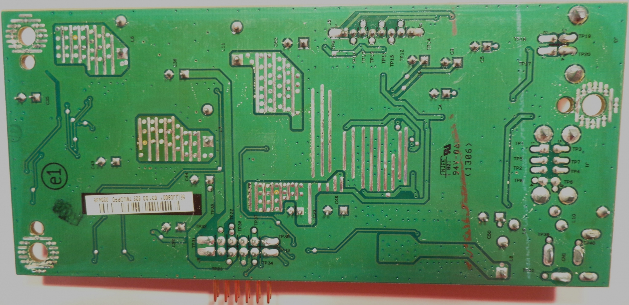

                  I know very little about electronics and am quite intimidated about posting on this forum. I have a Dell 2007WFP which has the appearance of doing nothing when you push the switch. I have spent the last few weeks digging into it and reading everything available on the badcaps forum. budm, retiredcaps, plain bill, and others already have been my true mentors without knowing my existance. It took a couple of weeks to learn to use a digital camera and optimizing software to even come close to getting acceptable pictures to post, and since I am getting nowhere fast with my monitor, I guess I'll have to jump right on in.
                  I have attached (or at least attempted to) photos of a 5EL2J08001 USB/DC Converter board. After reading the forums, I am assuming my trouble lies on this board so will only post photos of it at this time.
                  Here's all I have done.
                  The forums lead me to this board and I know it has problems. I have a digital volt meter and first checked F19 and the 4 small fuses, F1, F2, F3 and F4. The little guys were fine, but F19 was bad. I was able to identify him via the internet and ordered some 3A Littlefuses to take his place. I received them and replaced him after watching soldering videos on YouTube where I learned about Chip Quik. I think I did OK since I have never even seen a surface mount device before now.
                  Also I read about the dangers of not investigating why a fuse blows in the first place, so I read more in circuit component testing from retiredcaps. I really wanted to put everything back and turn it on, but I resisted. I checked all 8 of the S4 65A devices which budm said were 40V 1A shottky diodes and I believe those to be good. I continued and read how to check zener diodes and Mosfet devices and became acquanted with their images on Google enough to find them on the board. So what I think I know now is fuse F9 was bad and replaced, ZD701 is shorted and removed and Q6 (J598) is also bad (not removed yet).
                  So now I must ask for help. First I have no idea how to find replacements for the zener diode and the Mosfet fellow and secondly I don't know what else to do. I only got this far from much reading of the articles here but I don't have a feeling for when it might be time to try to fire it up again. But until I can find replacement parts for the diode and Mosfet I believe I am at a standstill.
                  Please help me if you will.

                    OK. Q6 is the Buck regulator swithcing power supply to produce the 3.3vdc for the Logic ICs. Does Q6 show very low Ohm reading between the Source and Drain? If that is the case, it can be real bad news, as you can see from my diagram, Q6 is basically in series with the load and it must be turned on and off at very high speed to do the switching for 3.3V output, when it stuck on (due to bad Gate drive signal from the SMPS IC or shorted out, the 19V will be at the out put and can easily wipe out anything that is made to handle only 3.3~5V range.
                    If I were you, I would remove Q6, then attach the variable power supply with built-in Amp meter to the 3.3V line. Then you slowly turn up the power supply while monitoring the current, if the current jumps up to 5A or more (I do not know the spec of this 3.3V power supply, I expect the current rating it can handle will be around 2~3A range, then the load is damaged also.
                    May be insanezz can tell us what the current draw is on the 3.3v Line.

                      Thanks so much for your reply. On Q6, S-D = .3 ohm, S-G = .5 ohm, G-D = .6 ohm. I will go ahead and remove Q6. I think I can get my hands on a variable power supply, but I will have to do some research first on how to use it and secondly, how to perform the test you want me to do. In the meantime, I will see if I can get Q6 off.

                        I got Q6 off without damaging the board but I broke the gate pin off trying to lift it off the board. S-D = .3 ohm out of circuit. I'm guessing he was done for anyway.
                        I have access to a BK Model 9110 100W Multi Range 60V/5A DC Power supply and will be reading up on how to use it if you think it might work. It has 2 digital readouts, one for Volts and one for Amps and it appears you can adjust them independantly using one knob and a selector button.
                        Getting ahead of myself, I looked over your drawing again and think maybe you would hook up the positive from the power supply on the board to where I removed the drain from Q6? And if so where would the ground get connected to? Then, how would you operate the power supply?

                          You can connect the external power supply to C44, PLUS to the Plus of the cap, NEGATIVE to the negative of the cap. Just make sure that FD3, FD4 are not shorted or conduct both direction. Read post145 also.

                            OK. I warned you about not knowing anything. After your last reply, I got the power supply and read the instructions which amounted to a few pages and set off to educate myself. After a full afternoon, me, my meter and the power supply along with a little light bulb did some bonding and I think I understand enough to be dangerous. I ended up setting the power supply to 3.3 volts and read 55mA on both my meter and the power supply when all was hooked up to the light. It was a little 30V lamp but I could see the filament glow. I was satisfied I could read what the power supply was telling me so I hooked up to C44 as you told me to do without changing anything. I could only read 2-4 mA on the power supply. From what you thought I expected to see much more. Please advise.

                              So the output of the power supply is still at 3.3V? I am looking for heavy load due to shorted out and blown component due to that shorted Q6. I believe that the Current knob on the power supply is for setting the maximum it will allow the load to draw. If you are getting 3.3v and the current draw is only 2~4mA, then it seems to me that the logic board is dead. So far it does not look like you have shorts in the 3.3V line.

                                Yes, the 3.3V on the power supply did not change. I have Q6 and ZD701 still removed from the board and nothing else connected to the USB board at this time. It that alright?

                                  OK, I thought you have the boards connected back up, there was no load that is why it is so low. You need to connect the boards up.

                                    OK, Got everything hooked back up as shown. Now at 3.3V on power supply I get 1.810A and am having way too much fun!

                                      So can you turn the monitor on and see the LED power light?
                                      • MEB
                                        • Sep 2013
                                        • 371
                                        #159
                                        Re: Dell 2007WFP Won't Power On
                                        No such luck.
                                          #160
                                          So there is no response from the main board then. The 12v and the 5V also not present on the that board either?
