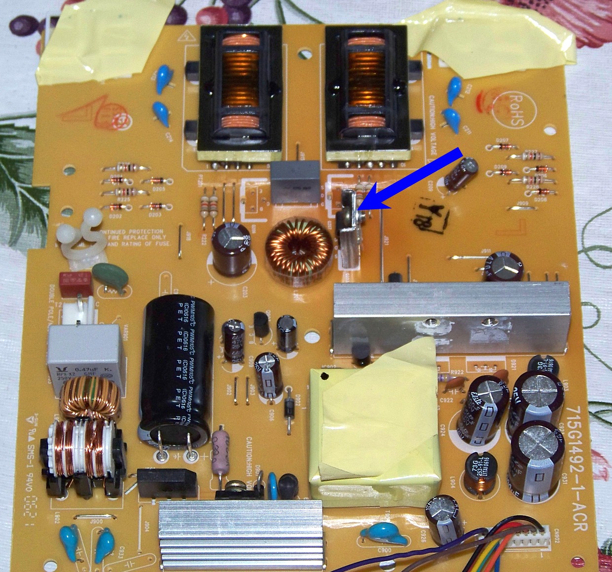

            Thanks for he Advise on other Caps Brands/Series I can get for replacement. THat was very helpful. I finally got my list of Caps to order but I noticed on the board where the 2 bad Transistors are another Transitor Q203
            right next to the Coil. The board looked a littl brown under that too, I thought I would test in circuit. Looks ok(from what I have learned) about 800 or so ohms testing 1-2, 1-3 and 2-3. but I noticed the headsink was not solderwell and was loose once I unscrewed the cover that was screwed into it. the solder wasn't stuck to the trace I figured I better remove and test. It doesn't test to well. When I test I get the following 1-3 only 1 I don't have ol on mine so not sure if that means its open or infinity
            2-3 800ohms and 1-2 the same as 1-3. Nothing or just 1. Basiclly it doesn't change just says 1. on the board its set up as G D S which is 1 2 3
            The numbers on it say U401 and below that is BE6H1S
            I guessing its bad , but if it is. Im not sure what the replacement part would be. I didn't find any info and I'm still learning on finding substitute parts.
            I can send a pic tommorow if need be I will attach a pic whee this is located
            Nick

                              Re: Acer 1716B no picture, Blinking power light
                              I just went to order the parts and Digikey and aparentlly all the other places have no stock of KSD1691. The only thing they did have was a a replacement part that was rated the same accept the Amps. it was 4 Amps rated instead of 5. I'm thinking I better not get it. Since the originals shorted but would this work?
                              Thanks,
                                #35
                                Well I'm not a circuit board designer, but if the fuse (I can't see it in your picture) is rated for 3A, I think you can go with the lower 4A replacement part.
                                There may be more than one fuse on the power/inverter board including a picofuse (starts with PF).

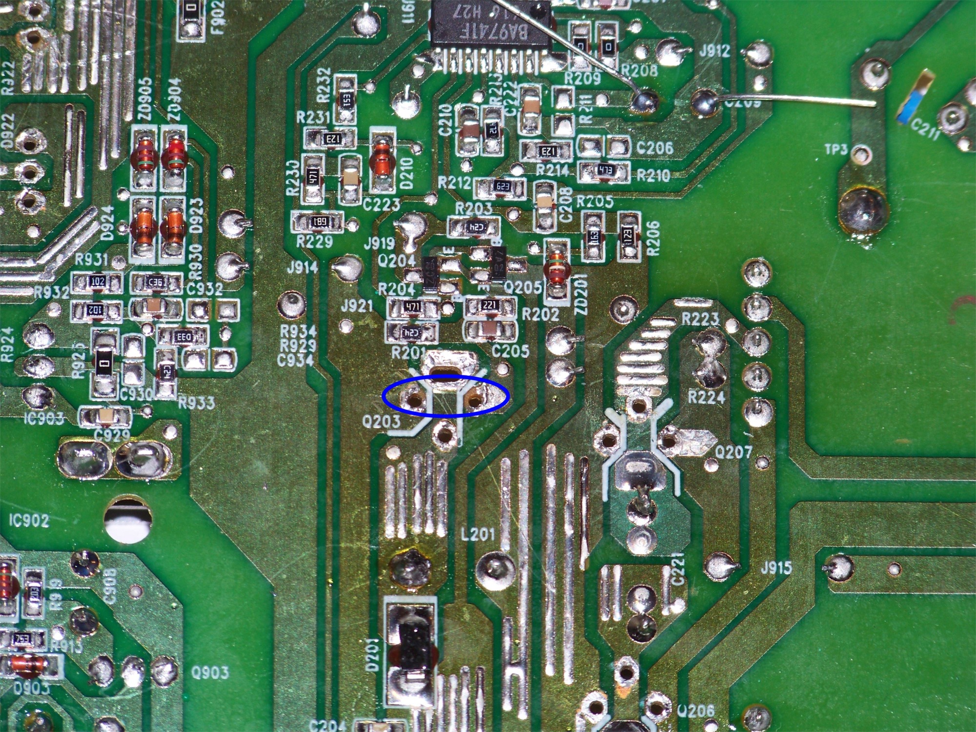

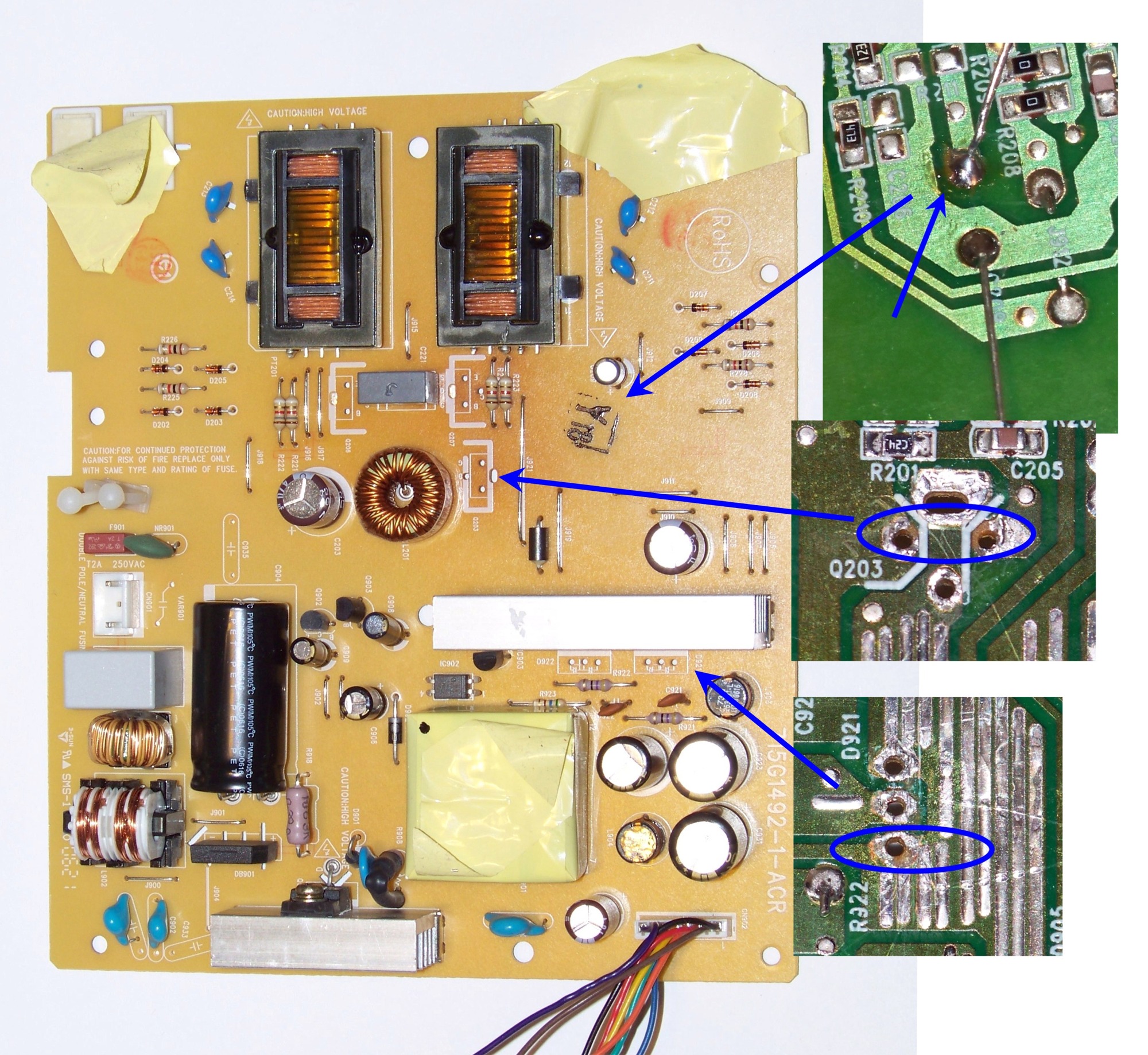

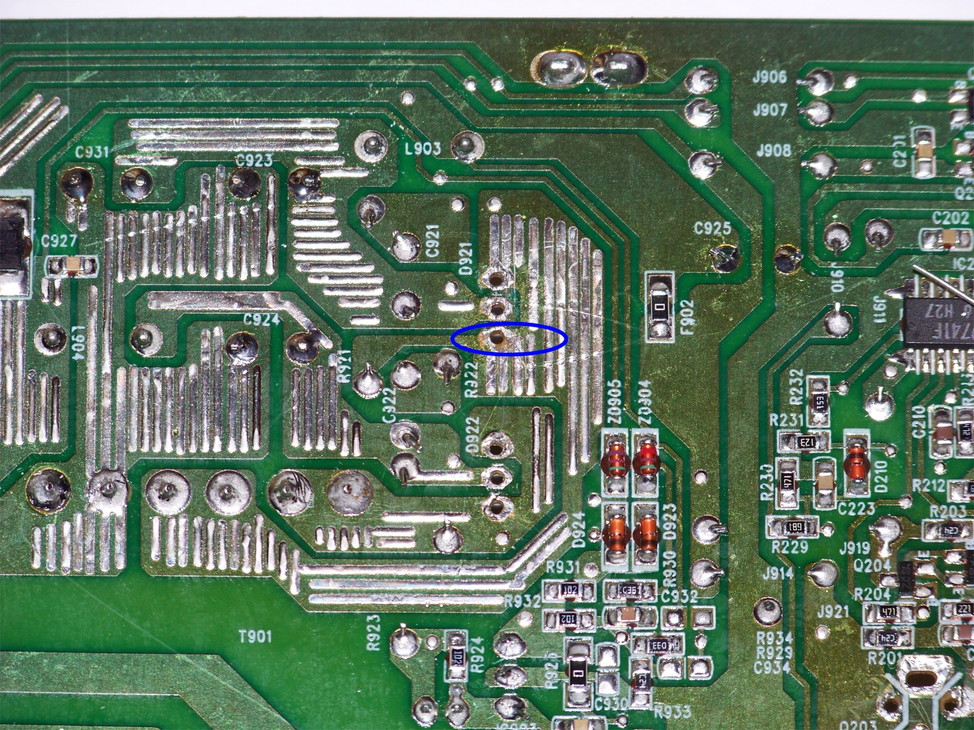

                                    I finally was able to get some KSD1691s and replacement caps. Resoldered all the caps last night but ran into another problem, I needed a little assistance on. A few traces partialy came off. I had 2 caps do that yesteday and noticed one of the dual Diode traces and one of the Transitor Traces had this probelm. It looks like they each are have about 1/3 to a little less than 1/2 of the traces gone. Of the 4 I looks like they attached part of the trace is still part of the circuit. Should I just leave them, or connected a wire or solder the connection further back(for the caps if possible) to a connection in the circuit. I noticed on the caps that there are traces that are not used that I could soldier the cap to or a jumper wire. ANy help would be greatlly appreciated. I had to do the smoke test and have a problem because of the traces
                                    Thanks,
                                      #38
                                      A really good clear focused picture (close up) using the manage attachments function would help us make a judgement call.
                                      --- begin sig file ---
                                      --- end sig file ---
                                        #39
                                        Thanks, I will post some pics tommorow after work, when I have a little bit of daylight to get a better,clearer pics(hopefully)
                                          #40
                                          I just attached the pics, I thought there where 2 capacitors but I can't find the other one. I didn't cut the first one you can see part of it soldier well but not the one corner.
