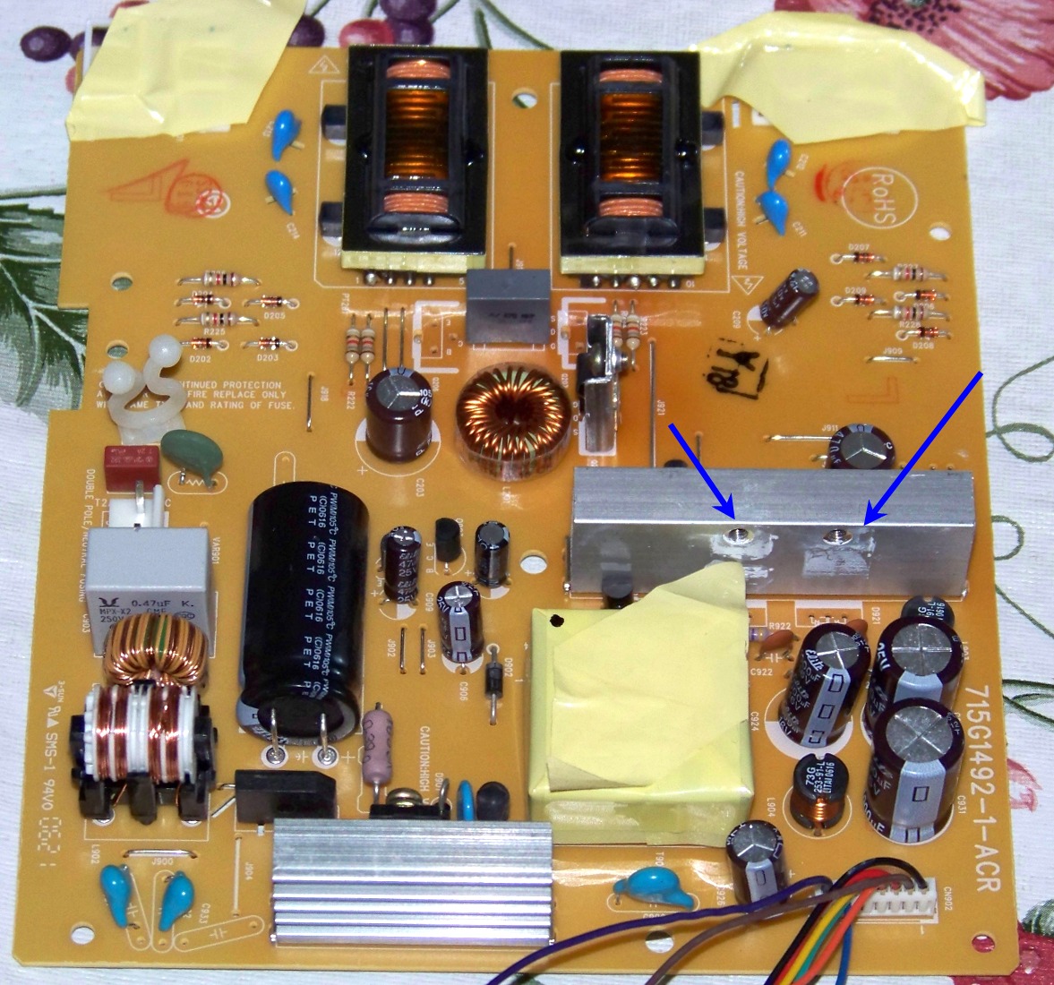

    I have a Acer 1716B LCD monitor. It was working fine and then one day no picture, just black. No backlight from what I could tell. The power light blinks green. I took it apart and didn't see any bad caps. I also took a ESR meter and tested them all. I didn't come across any with high ESR. All seemed to be in range or rather close. My meter tests in circuit and also tests Capacitance. I know many times it tests High capacitance in circuit but I don't think the Caps are a problem at this point capacitance wise. I think they would be much lower if they where in circuit, but obviously it is possible. Nothing is bulging or leaking. Everything I ran across on line pointed to bulging caps. Any and all help is greatly appreciated. I would really like to get this monitor going if possible. Reasonably.

    Oh Crystal Ball, can you show me this monitor? Nope, it's not helping today.
    Guess you are going to have to do this the easy way. Take an overall picture of the power supply board and attach it to your reply. Follow the link in my signature for the procedure.
    Some models of Acer monitors were notorious for shorted inverter transistors.

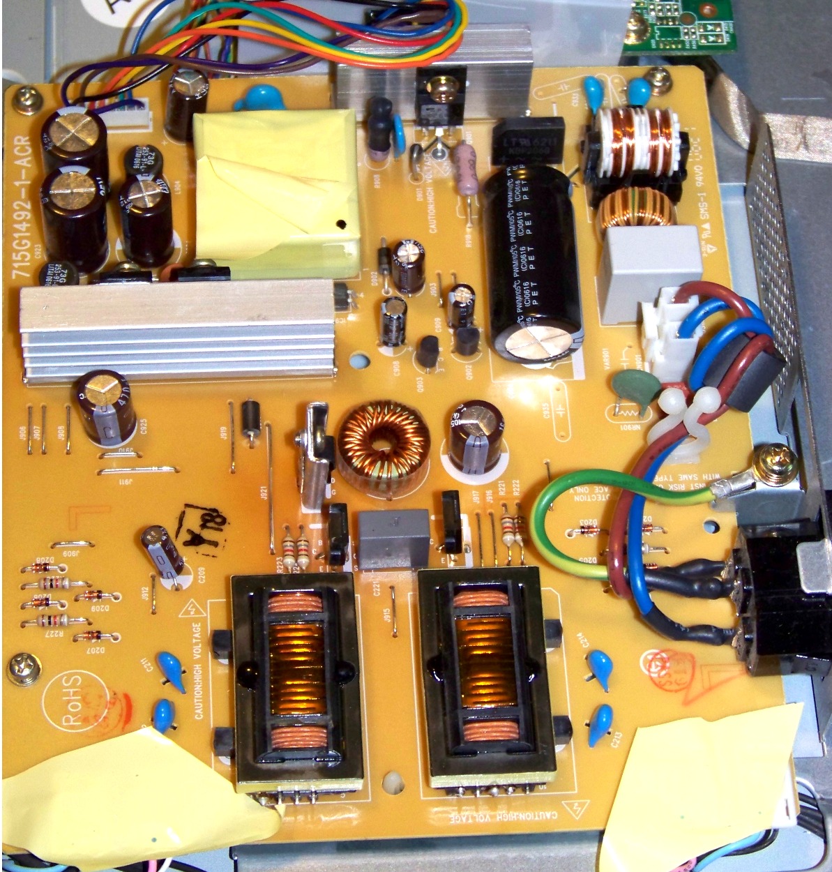

      Thanks PlainBill, sorry I forgot about a pic
      I just attached it. I can take closeup if needed.

        Check the two transistors flanking C221 (grey square cap) to make sure they are not shorted.
        What part number are those two?

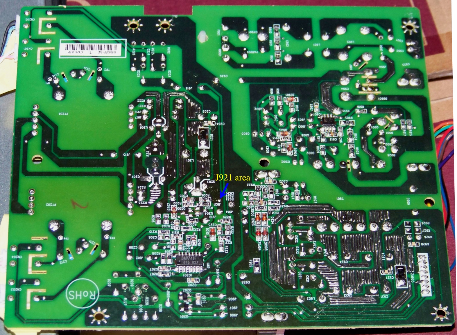

          Can you also post a pic of the underside? The J921 area looks a bit discolored from something on the underside?

            They each says KDY on the left side going veritically. In the middle is 1691 and then below that there is a 603. Im guessing they are 1691? I have a dumb question. I have never been good or figured out how to test a Transister especially for a short. I don't believe my meter says short on the diode mode. They are a BCE package. any help with testingwise would be appreciated. Sorry Im still learning some some stuff.

              I just posted a pic of the backside. I hope that helps.

                        I also noticed what looked like cold soldier joints. A lot of them. Can't tell if you can see them in the pic. Should I touch those up?
                        You must resolder the all the transformer pins and anything that looks like a bad solder joint. It is likely the poor solder joints on the transformer pins caused the transistors to short out.

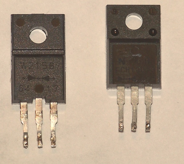

                              I just attached pics of where they are located and pic of the Transistors out of the board(best pic I could get)

                                  Pictures always help a lot. From your pics, I can tell they are dual diodes (I think that is the correct term).
                                  As you can see in the pic, the direction of the diodes both point towards pin 2.
                                  Set your multimeter on diode test function.
                                  So put your black probe on pin 2, red probe on pin 1 and you should get some reading like 0.4 to 0.7 in this direction. Then black on pin 1 and red on pin 2 and you should get 0L.
                                  Next test is black probe on pin 2, red probe on pin 3 and you should get some reading like 0.4 to 0.7 in this direction. Then black on pin 3 and red on pin 2 and you should get 0L.

                                    The W2156 tests 1-2 160 3-2 160 and 1 in the other direction for both. I unfortunatlly don't have 0l on my meter. Iwish it was 0l instead of 1! makes it a little less confusing.
                                    The other one N 6b is 1-2 236 3-2 236 and 1 in the other direction for both.
                                    Does that mean there both good since there not open or shorted. Just a little higher reading maybe normal?

                                        I can't find a spec sheet for W2156, so let's assume they are good. If your monitor doesn't work after changing out those shorted transistors, we can relook at these dual diodes.
