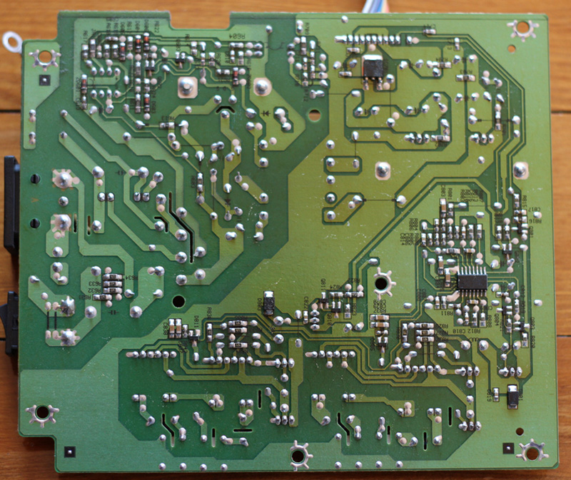

            Here's the back of the board
            I can see heat damage to the solder joints of Q805, 808 and 809.
            And pf701 has 5 A printed on it.
            • alexanna
              • Mar 2010
              • 1346
              Re: HP1955 Board Burnout - Is it Fixable?
              5 Amps seams like a hell of alot 17" are only using 2a fuses.
              When I have substuted a 3a fuse for testing it got hot but never caused smoke.Some one needs to verify correct amprage of that fuse,I am afraid were going to have a fire.
              Al.

                          • pedro
                            • 199
                            • AUSTRALIA
                            The manufacturer will have selected 5A for a reason. The fuse *isn't* intended to prevent the 2SC5707 flameout - semiconductors die several orders or magnitude faster than fuses. I have repaired many of these Benq/Acer configurations and never felt the inclination to fiddle with the fuse rating.
                            What often happens is the transistor providing the PWM drive the the inverter pair fails, which causes the 5707's to overheat and die.

                            • PlainBill
                              • Feb 2009
                              • 7034
                              The failures on these monitors are quite well understood. A bad solder joint on the transformer will cause one of the C5707's to short, resulting in the other shorting. This will often cause the associated mosfet to short, and MAY cause the fuse to blow.
                              Transistors are encased in self-extinguishing plastics. There is no reason to get into a panic about a little smoke. Do a little math, alexanna. If the transistors short with a fairly high resistance - say 10 ohms - you have 2.5 amps at 12 Volts - 30 watts being dissipated. Yes, it's going to stink. No, it's not going to set the room on fire.
                              The cap SHOULD be replaced if there is any physical damage. .22 uF, 160 volt. The two bipolar transistors (C5707) and the FET above it (FU9024N).
