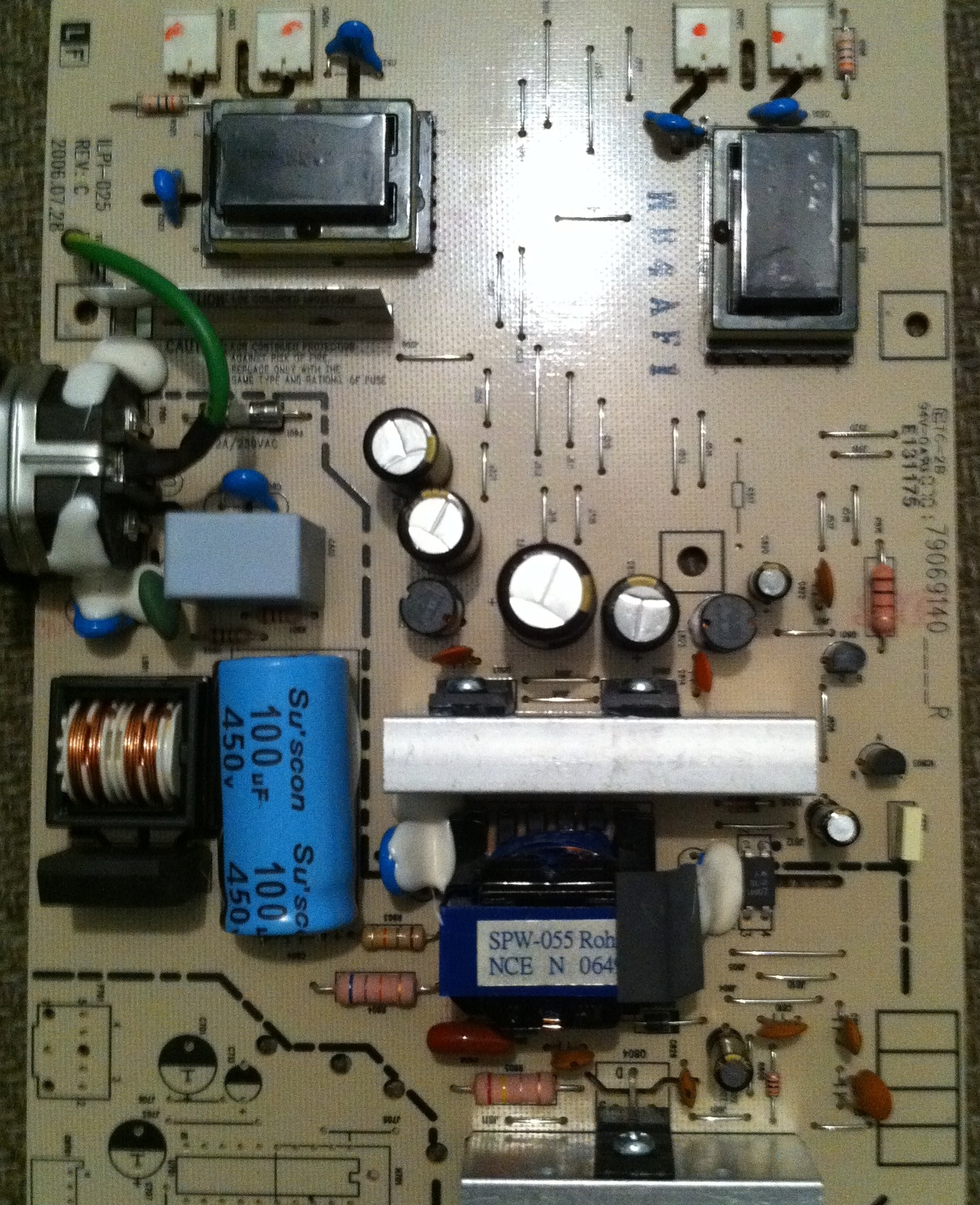

    Hey all,
    I've been lurking around this forum for the last two weeks as I have recently become interested in repairing dead monitors, and after successfully repairing an emachines monitor with bulging caps, my inexperience got the best of me with an Acer AL1916W. I got two from my corporate office, one dead and one working fine. After replacing the smaller caps on the dead monitor's power supply, I still have a dead monitor. The power LED light doesn't light up at all. I swapped PSU's with the good monitor and it works fine, so at least I've narrowed it down to the PSU. The only capacitor I didn't replace was the big 100uF 450v su'scon. When the PSU is plugged in, I get no voltage from the leads of the large cap with my volt meter. Should I replace the large cap or is there something else that would be causing my woes?
    Thank you for any help!

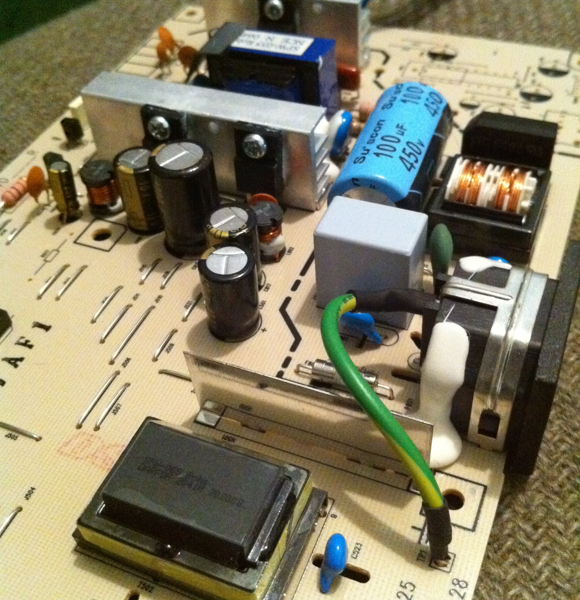

    Did you check the fuse? (half hidden by the green wire in the first picture).
      Members here hate su'scon and you may want to replace this cap. But before you do, try (with power off and unplugged)
      1) test fuse to see if it is open
      2) test rectifier to see if it shorted (it is the black long rectangular thing and should be marked with a D on the PCB)

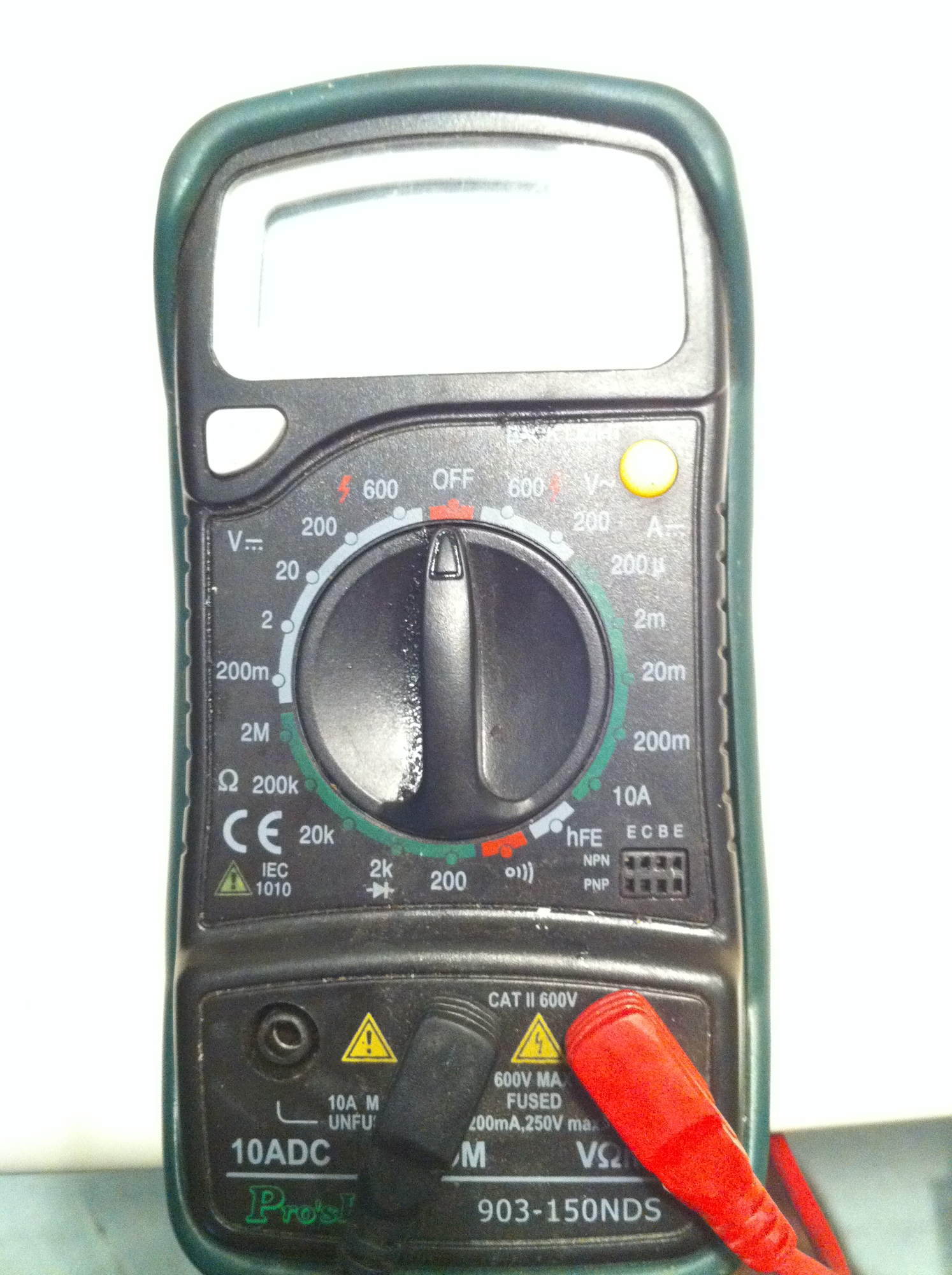

              Re: Acer AL1916W
              What kind of meter are you using? Dont use the tone setting that can give you false readings.
                Re: Acer AL1916W
                Agreed. I used the continuity setting and got a false reading on a picofuse. It read 18 ohm and that lead me to believe the fuse was good when in fact it was bad. It depends on the multimeter, but some meters will beep if the measurement is under 30 ohms.
                A good fuse should read 0.3 ohm.
                Post a picture of your multimeter.
                Before you order anything, you should check the bridge rectifier. That may be shorted.

                  Here is a picture of my multimeter.
