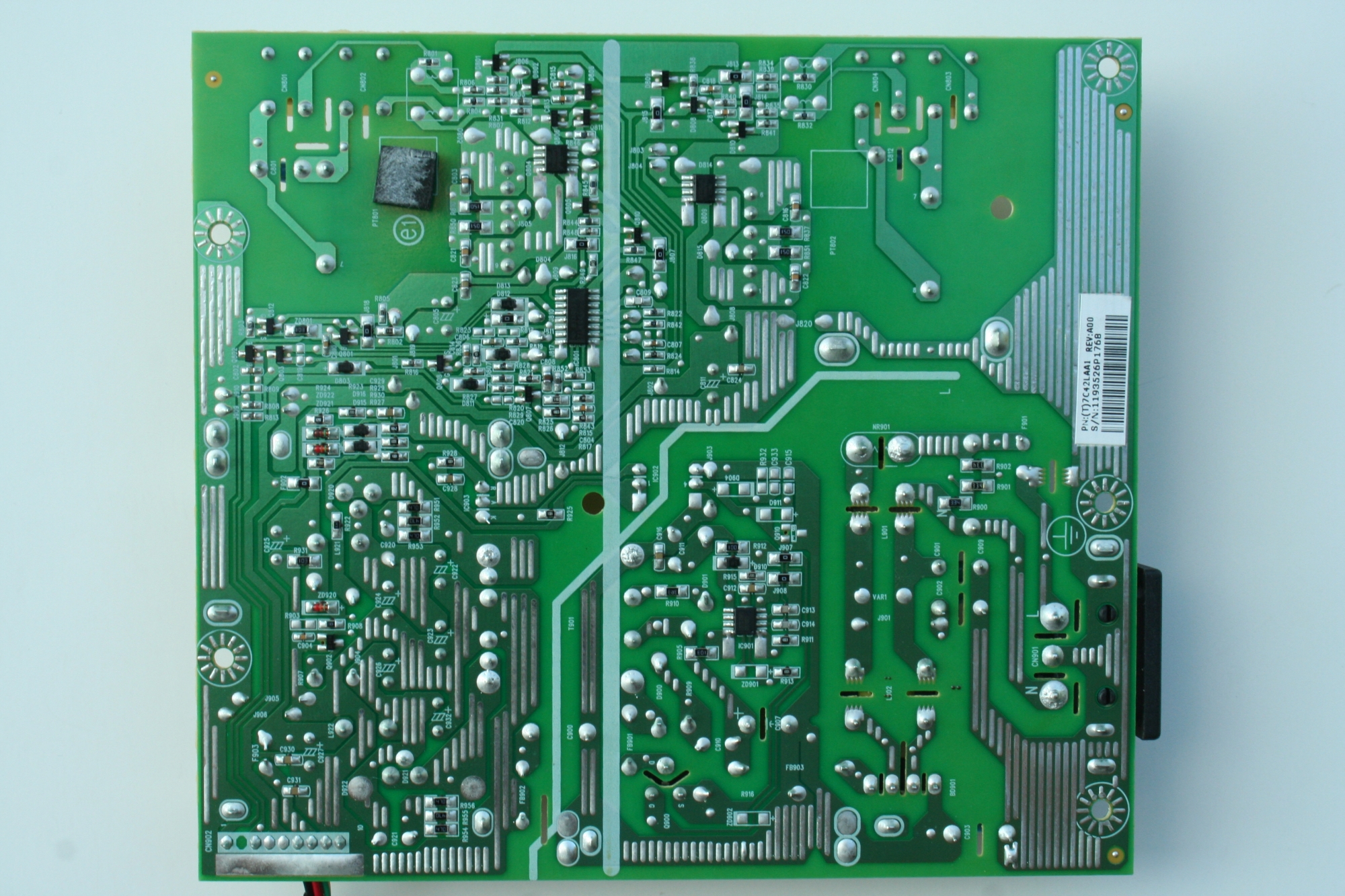

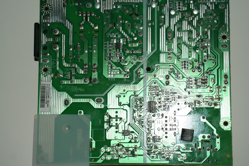

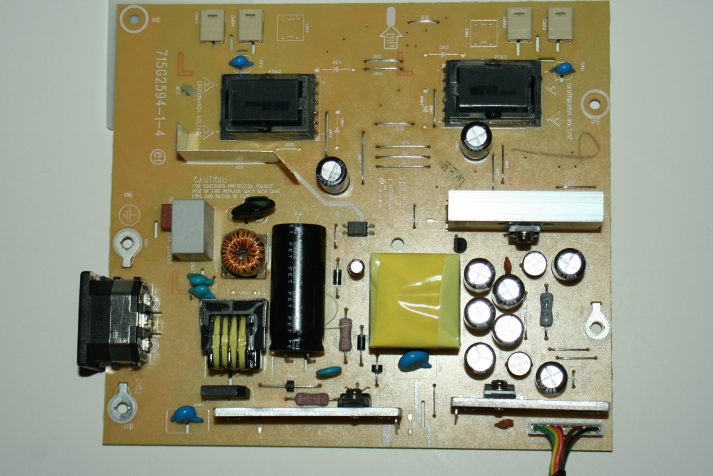

    I have another monitor that I am trying to fix. This is a Dell 22" widescreen and the backlight goes out about 1 or 2 seconds after turning it on. Usually I see caps that need replaced right away, but this one has no bulging caps. I am stumped on where to look to repair this one. Any help about where to start would be great. I have pictures below.
    Thanks,

    1. Measure the resistance across the secondaries of the inverter transformers (measure across the legs of the blue caps that are near the transformers). The resistances should be equal.
    2. Specifying the model number of the monitor is helpful to others.
    3. There is a 16 pin IC in the inverter area. What is the part number?
    4. If further troubleshooting is required, the picture of the bottom is inadequate. Remove the plastic shield, take the picture with ambient light, and get the dimensions as close to 2000 x 2000 as possible.
    PlainBill

      Caps DO NOT HAVE TO BULGE to be bad. They can simply dry out, increasing ESR and decreasing capacitance. If you don't have a tester, go ahead and replace all of the electrolytics, just to be sure.

        Okay, I measured the resistance across the legs of the blue caps near the transformers. The resistance is 474 for both.
        Model number of the monitor is Dell E228WFPc
        IC has the following on it:
        83AREEM
        TL4941 G4
        I will attach a better picture shortly.
        Thanks for all the help.
        Tony

              That indicates the transformers are probably good. The IC is a TL494I, a SMPS controller, but not one specifically designed as a inverter controller. With a better picture we may be able to trace the circuit and figure out why the backlights turn off.
              PlainBill

                  Here is the updated picture.
                  Thanks,
                  Tony

                    This is rough. The detail is not quite as good as I had hoped, but I marked a pair of dual diodes with red dots. and labeled what I believe are the current sense lines from the four CCFLs with the letters A - D.
                    The quick background on this is the TL494 monitors the current through each CCFL. If the current goes too high it shuts down the backlights. There is also usually circuitry which will shut down the backlights if an open CCFL is detected, but I don't see any signs of it. AND there is usually circuitry that maintains the total current through the CCFLs at a certain level.
                    There are two approaches at this point. The easiest would be to take a spare CCFL and use it as a substitute for the original CCFLs one at a time. If the monitor works when a certain CCFL is replaced, we suspect that CCFL is bad, or a wire is broken, arcing to the metal, etc.
                    The second is a little harder. Try to measure the voltage at pints A, B, C, and D in the time the backlights are on. Repeat it several times for each point. We are looking for a point that is either lower or higher than the rest.
                    PlainBill

                      To emphasize one point el3ctroded made, replacing the electrolytic capacitors may solve the problem. If no voltage differences are found at the 4 points I specified, or if a known good CCFL does not help; replacing the caps would be the next order of business (unless they test good on an ESR tester).

                          As far as replacing some caps, what brand are the original caps?
                          PlainBill
                          • indyracer
                            • 13
                            Re: Dell 22" monitor backlight goes out right away.
                            The caps say Elite on them.
                            I think I will try to find a meter to test the caps. That sounds like something useful to have anyway if you do many of these monitors.

                                  I switched the lights and got the same results. Then I got some lights from a monitor that has a broken screen and plugged those in and still the same results.
