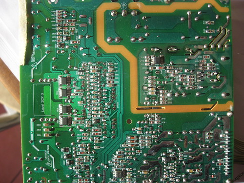

                    Hey Guys,
                    I have the same board of you and, I search the value of CMS resistor who had burn . They are unreadable.
                    the number of the components write on the board is : 3117, 3118, 3115, 3155, 3154
                    Or if you have the datasheet of the board it will be perfect
                    Thks a lot

                      I tried to look up that series of numbers but could not find any components assigned to them. Please post a picture of the board and if you could, not the affected area (burned resistors) and based on what part of the circuit this is in, we can locate similar part maybe.

                        Re: Philips 190S LCD power problem
                        its the bottom of the board
                        img_0157 par emietflo, sur Flickr
                        Its on upper right hand side of the board
                        img_0158 par emietflo, sur Flickr
                        Thx
                          Looks really bad. If you would, post a pic of the topside of this board. I have a feeling that the components on top may have something to do with this type of failure.
