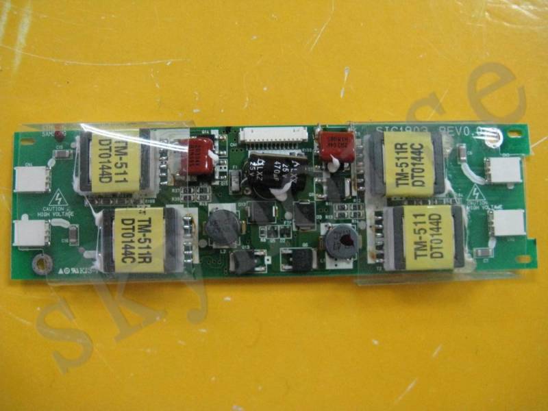

    First off, thanks to all posters who have provided me with an incredible source of information.
    I have the above monitor, unable to find with searching, which I understand is made by Samsung. Having been successful in repairing another Dell 172FBP (new transistors) I decided to try my hand at this one. Very similar problem, no visible screen just a flashing amber power light and a quick flash of light.
    This monitor has an external DC power supply. I took apart the monitor expecting a bad inverter board. It only has one electrolytic capacitor on it, 470uf, I believe and it looks ok, at least not leaking or bulging. I don't have an ESR meter or any real test equipment. The inverter board is almost all surface mount soldering other than this cap. The inverter board is BN44-00041A
    Any suggestions as to what might be the common fault with this monitor or inverter board.
    Thanks for any help.

        Re: Dell 1900FP Monitor - BN44-00041A Inverter
        Assuming the inverter is the same as this one here
        http://lcdparts.net/InverterDetail3D...ProductID=2233
        what are the two ICs (part number) by the connector and flanked by the two diodes?
        If you have DMM or can borrow one, you can test the 4 transistors (what part number are these) next to the inductors as well for shorts.
        Have you tried switching the CCFL connections around or remove one at a time to see if one connector is bad?
        Post a clear picture after reading the FAQ on posting pictures.
          Thanks Retiredcaps,
          I already reassembled everything but will likely open it again. The part isn't exactly what you linked to. I am attaching a picture from a vendor's site. I think the transistors are good, tested to see if they were shorted out. I am not sure about disconnecting the ccfls. Do you mean try it with one unplugged?
            A picture from your actual monitor will help because it might show things that people can spot.
            Yes, try with one CCFL unplugged and see if one of the them is the culprit.
            You *think* the transistors are good? How did you test them? What reading did you get?
              You mentioned a flashing amber LED. This is often a monitor trying to tell you something is wrong. Or it might be a normal 'No Signal' thing. Hook up a video source; if the amber light continues to flash, suspect the power supply or a corrupted user EEPROM.
                I hope you had tested the external adaptor!
                Also, you need to monitor the voltage coming out of the adaptor to see if the "flash" corresponds to a voltage drop. Your problem might be as simple as a defective external dc source.
                  Good point, I have 2 monitors that use external adapters. One had a bad cap.
                  The other works fine, but I only knew that after trying another external adapter to rule it out.
                  It looks like a few of these 2002 heritage LCD monitors made use of external adapters. I suspect the trend to put them inside the monitors was a cost saving move and to make it easier for users (so they don't lose the adapter or they don't plug in the wrong one).
