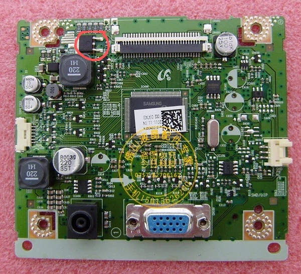

    help plz SA100 shorted mosfet
    Hi everyone
    Samsung SA100 comes to me with blinking issue the monitor power on for a second and then goes off
    When i test the monitor on power supply the monitor has now power with short on powe supply , i don't know why this happen , i found a shorted nchannel mosfet when i change with new one becomes shorted again
    Can you halp me .

      Re: help plz SA100 shorted mosfet .
      That looks like the mosfet that boosts the voltage for the led backlights, check that the led string is ok and that it is not shorted.
        thank you
        i found the mosfet in blue circle burned i change it but it burns again and the mosfet in red circle becomes shorted
        i try the motherboard without screen but the same results .
        I'm sure the problem in backlight section but i cant find the source
        can you mark the components that i have to check ? .
          Originally posted by mo000
          thank you
          Samsung S19A100N Service Manual. Read section 4.2
