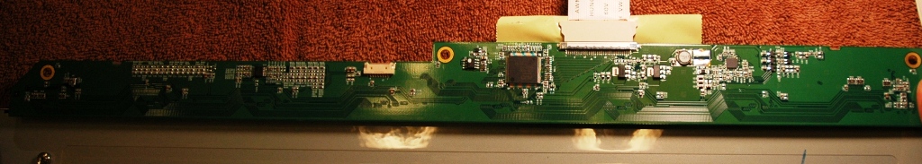

    I have a Viewsonic VX2235WM-3 with a short somewhere on the circuit board that is attached to the LCD screen. I have isolated the shorted fuse, tried to replace it and it shorts out right away.
    I've seen posts that suggest connecting a light bulb in place of the fuse. What type of light bulb? After the bulb is attached, I assume I power up the monitor, but what am I looking for? I'd assume the light bulb will go on, and something on the circuit board will start to overheat. Is this correct?
    If I can't power up the unit due to it's layout, is there anyway I can connect a small battery up to the circuit board and start troubleshooting that way?
    Really I think what I need is guidance in troubleshooting a short circuit I've attached a couple of pictures. I've searched the forum for postings on shorts, but none of them really address how to troubleshoot it.

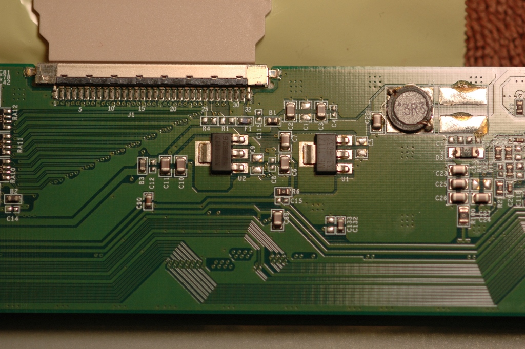

    The second picture shows two voltage regulators, U1 and U2. Check the resistance between the three pins (the tab is connected to the center pin). Check the resistance from the output side of the fuse to ground. Check any large diodes for shorts.

          Here are the resistance measurements for the two voltage regulators. I wasn't sure what probe should be where, so I indicated where I put the black probe and where I put the red probe for each measurement. Does these measurements tell you anything?
          Ground = Pin 1
          Output = Pin 2
          Input = Pin 3
          ME 1117 3.3V Voltage Regulator
          1-2 .888 kohm Black Probe on 1, Red Probe on 2
          1-3 1.120 kohm Black Probe on 1, Red Probe on 3
          2-3 2.009 kohm Black Probe on 2, Red Probe on 3
          ME 1117 1.8V Voltage Regulator
          1-2 465.7 ohm Black Probe on 1, Red Probe on 2
          1-3 .889 kohm Black Probe on 1, Red Probe on 3
          2-3 1.370 kohm Black Probe on 2, Red Probe on 3

            Well, you can do the math. The 3.3 V supply shows roughly 1K; that's less than 5 ma of current. The 1.8 volt supply shows about 500 ohms; again less than 5 ma drain. There is no hard short on either of those lines.
            Of course, this doesn't take into consideration possible dynamic loads, non-linear loads, etc.

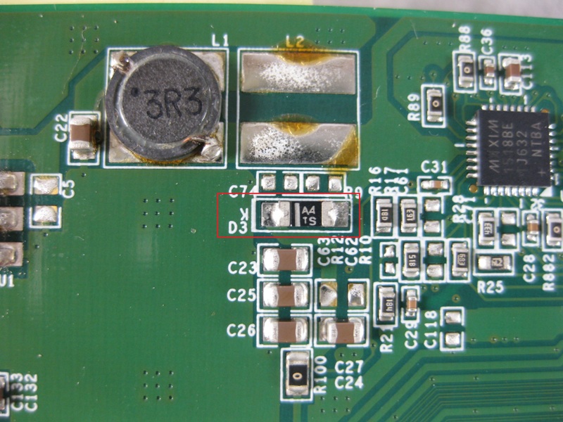

              I think I have identified this diode as shorted.
              I need help in identifying it...
              Anybody know what type it is?
              Where I can find one?
              Thanks in advance.
