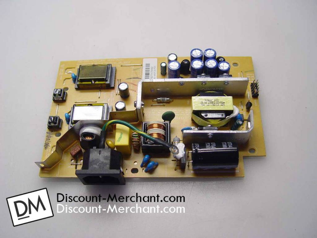

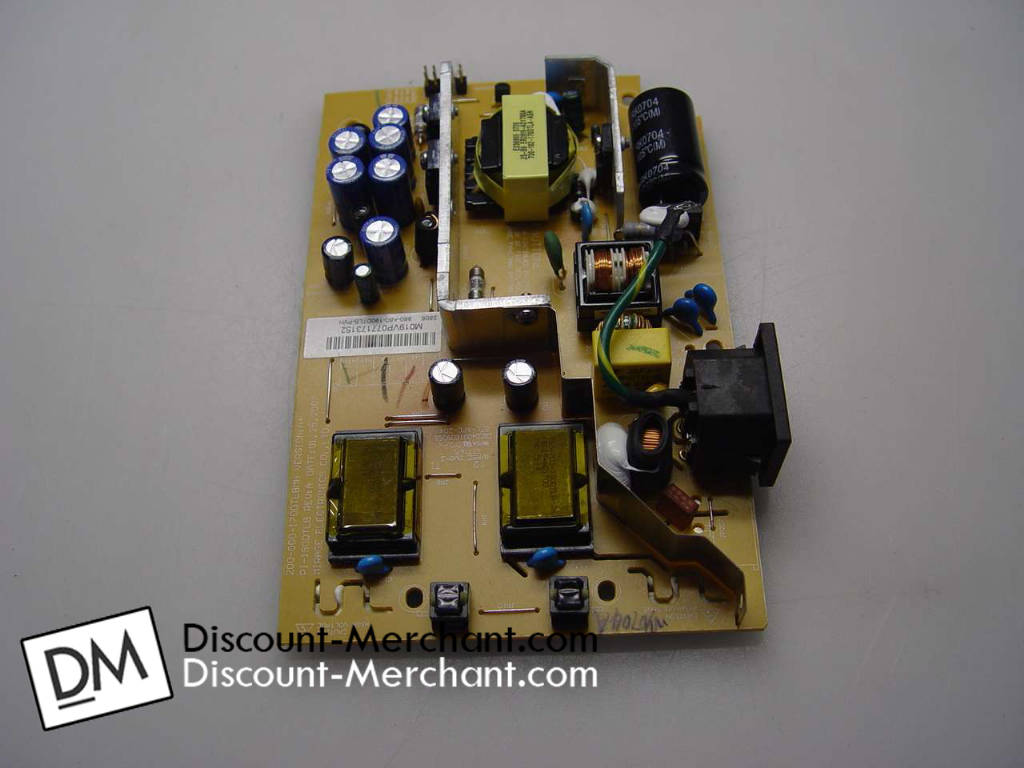

                  Maybe I can help. I have a Belinea 19'' monitor too (1905s). The problem was (is) monitor working but with a pinkish hue on the screen then black after 4-5 sec. I placed an order for new CCFLs (very expensive in this country) and I am still waiting for them to arrive from the US.
                  I am attaching some pictures of the power supply + inverter unit (component side) and the following link for its diagram http://www.4shared.com/file/10988829...ECTRONICS.html
                  (I found these pictures on the web because mine don't look too good)
                  I'll keep you posted on how it goes
